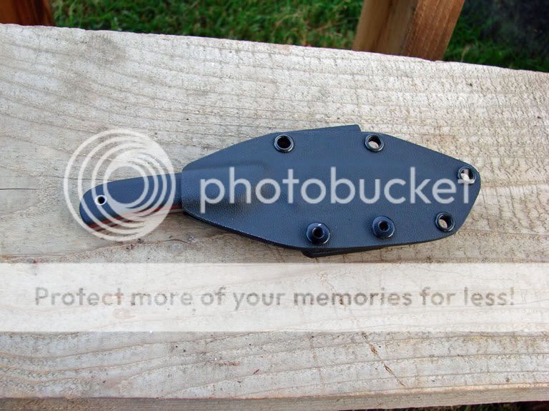

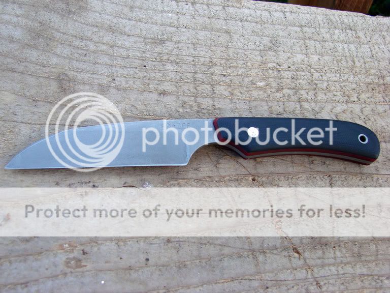

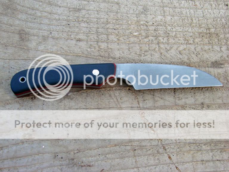

My friend Rama wanted a slightly larger version of my little booger for his uncle. About 1/2" more blade and handle to be correct.
AEB-L
60-61 Rc .110 thick
3" blade, just shy of 7" overall
Bead blasted and stonewashed
48" hollow grind
.090 thick red and then black G10 for handles with 3/16 SS tubing and mosaic pin.
