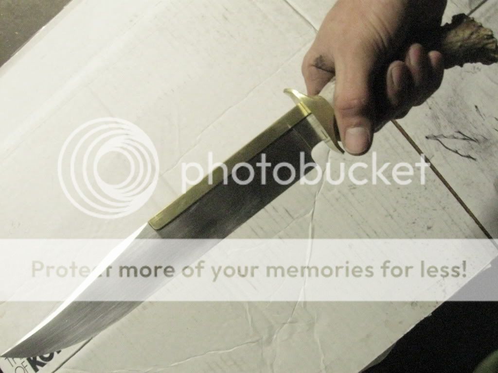

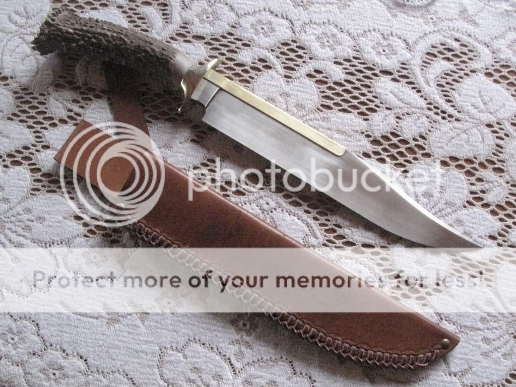

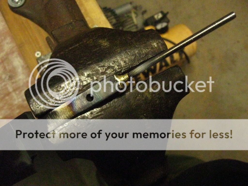

Check out this crazy bowie. A customer mailed me a blade, I believe it's a Cold Steel Laredo bowie factory second (uneven clip) and asked me if I would make a knife out of it.
Much hair pulling and elbow grease later, here it is 99% complete. (Needs a little blade polish touchup).

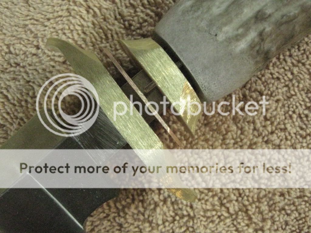

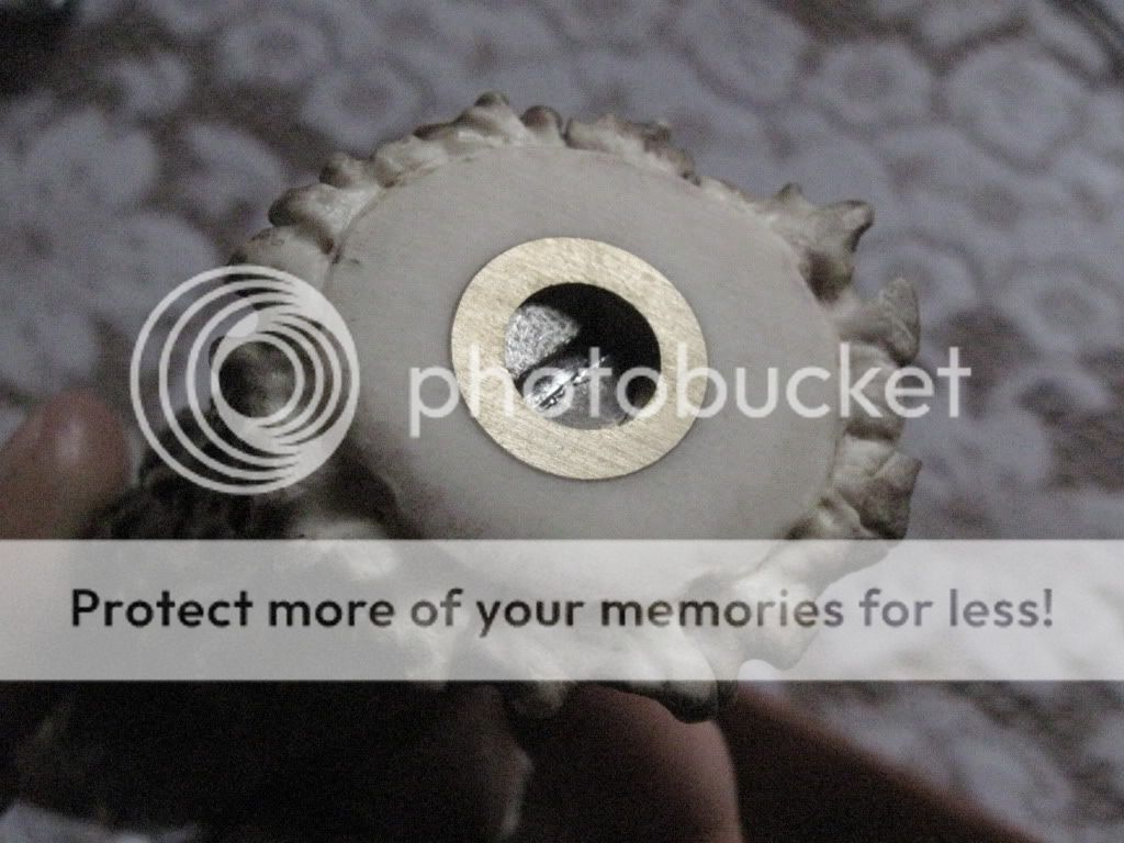

I soldered the backstrap on, and lathe-turned the brass bushing that the end nut fits into on the grip. The guard is stacked brass-copper-brass. I left it all as a take-down guard and hilt.

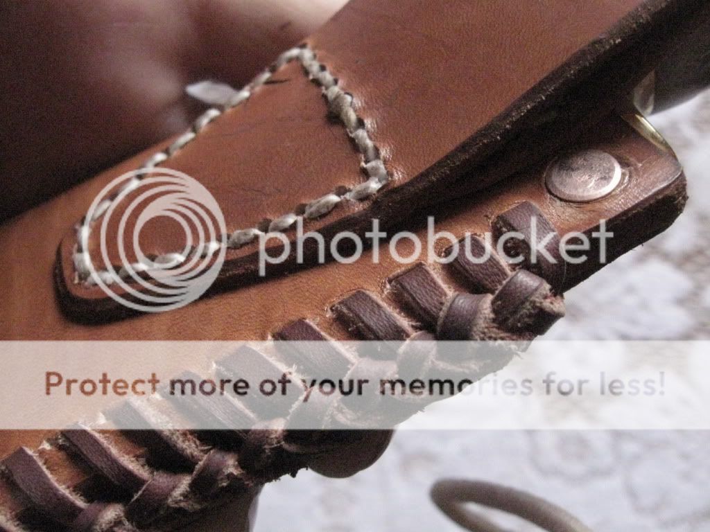

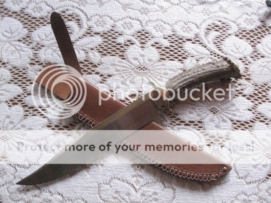

Horsehide sheath with double loop lacing.
