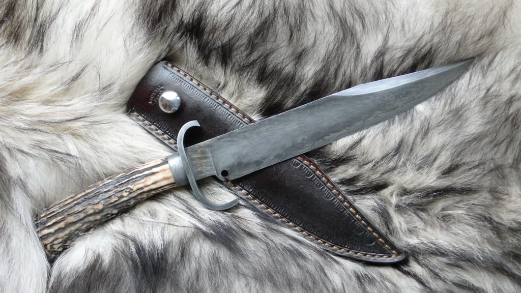

The magic of a well balanced Bowie and what separates the large majority of what I call paper weights and proper fighting Bowies is the balance and power that comes from Radical distal taper a stick tang and a properly shaped sharpened clip
As for the handles Bill did prefer the birds heads and coffin over stag
But man stag looks good
What are you thinking for a handle style ?
Good evening
Wow that is a beautiful bowie, thank you for showing.
Thank you for the explanation of the properties of a good fighting knive feeling like nothing.
For what I plan to use it - I would probably start with a quadratic handle which is probably also easier to build than a birds head - stag might be to expensive and exclusive for what I planned to use it.
Could you recommend a maker, which could make a proper wood handle, with bespoken measurements - it’s more about the function than the details, or if it isn‘t so difficult - I could try doing it myself - it‘s a prototype but I think it could work out like this, might also be - that the birds head might be better - but think I would start with the coffin shape.
Just found there is a fourth which is called dogbone. Which might be an option.
Considering balance I did find some pictures - and they all look balanced about 2-3 inches in front of the guard, which also seems important.
And stag looks awesome with the dark damast steel

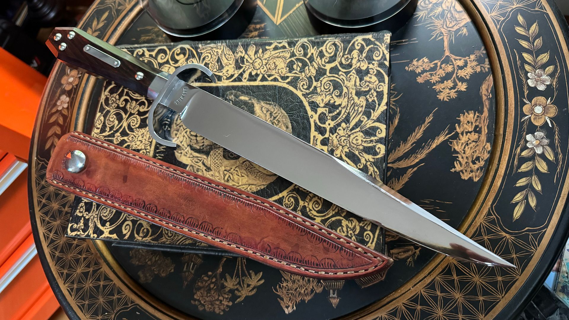

Bagwell did a series on You Tube on making one of his bowies and some dissertation on its' use and the type of point a proper bowie should have along with sharpening etc.

Pleases elaborate on your handle design.
Thank you all for the positive replies.
I will have to think about it.
There is a very specific task the handle has to perform and specific measurements it has to fulfill, I also like the designs of Moran and Knight, they might be a little to big / bulky for the job and also the one from Lurquin.
Its mostly about control and force and quick speed and change of direction and not so much about chopping, I think the design of a fighting bowie is closest to what I want it to do, maybe a Japanese handle would also work out, as the shape seems straight and is within the limits of the measurements and offers by its more rectangular form instead of the existing quadratic form a better grip.
However the more quadratic shapes are probably better fitted for it and offer a better hand and tip control, the handle should be as quadratic as possible and as smooth and ergonomic as the measurements allow.
The birds head - seems very very functional, but will be difficult to integrate in the existing design - because the head of the bird and the beak offers an additional holding position.
To me the dog bone and the coffin makes the most sense and maybe I can integrate the ideas and shape from Moran / Lurquin and Knight into it, to make it a bit smoother.
Whats not possible is to have an additional hole / grip for the index finger, or broadened ends to hold it better and there is a round and huge pommel I will have to integrate into the design.
What I like is the belly from the birds head, as it will transition the force better into the hand.
If I think about it properly - I will sure be able to come up with a draft (and also the measurements) and then it all makes sense
The best would be to integrate the pommel into the existing design, it must be round, but maybe it can be smoothed or adapted a bit or filed slightly to make its integration.
Best material for it would probably for the prototype be a strong and clean piece of wood.
