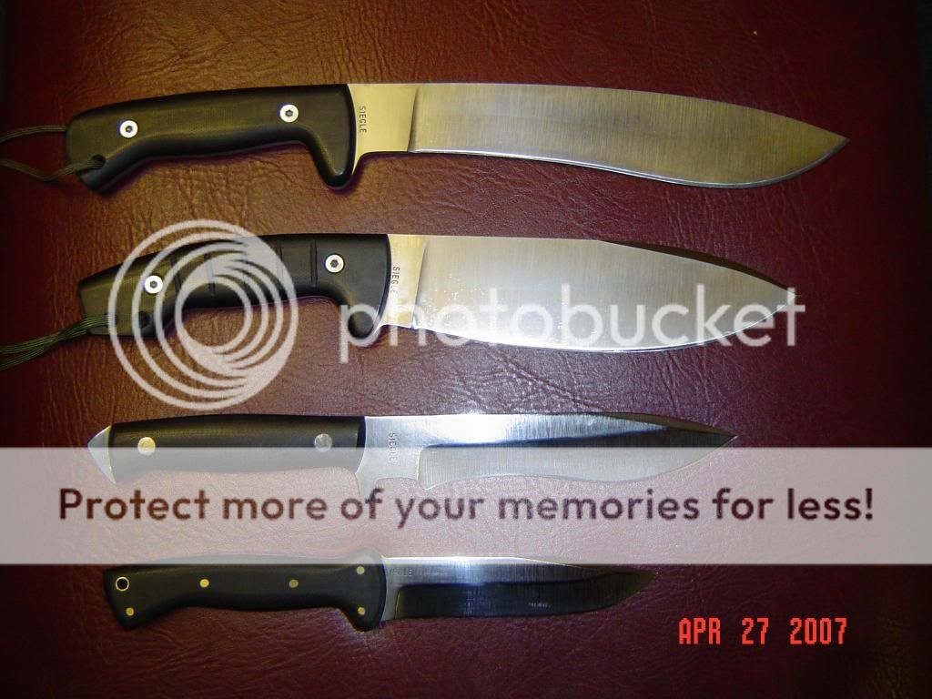

NO ONE---other than Bill Siegle I'll wager has tested more Bill Siegle knives than I have
Well over 80 I'll bet(not bragging-but if you are going to take advice on this --I'm the one to ask)
A SMALL # of the Siegles I have tested-Hoodlum 2 is on top of first photo
What Bill Siegle knives have is an OUTSTANDING level of comfort and ergonomics.98% of the people I let test a Siegle buy one--the other 2% want one but can't afford one.

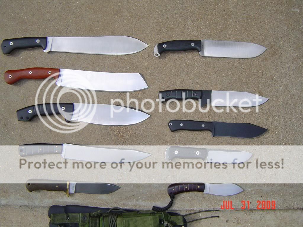

Well, two can play at THAT game. Not that this group is anywhere near up to date (probably have more than twice this many now--GOD I spend too much on knives...)
