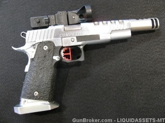

Just picked this up the other day from a friend who bought it to shoot in the open matches, his sponsors would not let him move from single stack so I picked it up. I think I'll turn it in to a carry gun. RMR rear sight, back up irons, and rethread the barrel to use it for a silencer host.

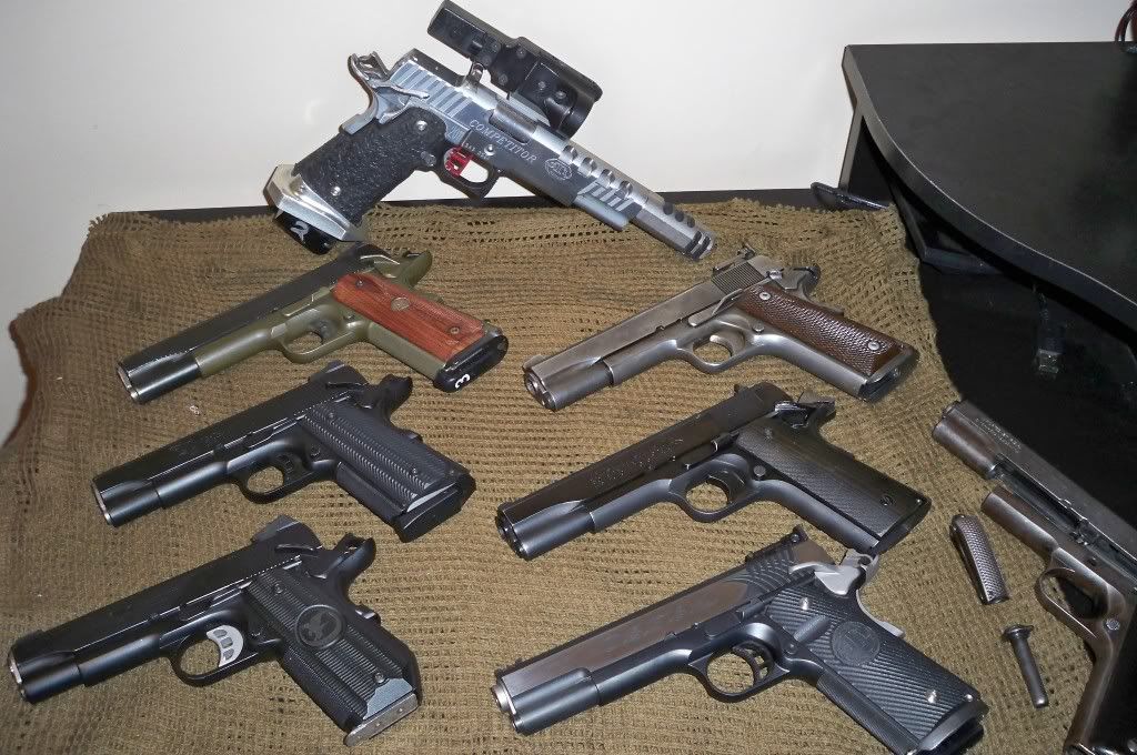

Some collection!
I would like to see how well these carry concealed. Especially your new race gun. It looks like there are a lot of distinctive "gun parts" to print through your clothing.

Looks like you know your M1911's, but why would you turn a race gun into a carry? Kinda like running a Ferrari on a dirt road, with the same dangers to performance when under not-so-ideal (self defense) conditions.
You'd have to downgrade that pistol to make it reliable enough for daily carry and to cycle/fire defensive ammo. You already have a nice collection going, and I'd choose that Nighthawk or Springer over the race gun any day.
Why, because its a benny hill... It's like taking a nascar stock car and making it street legal. Its not pratical but it'll stomp just about anything else on the street.
Actually, your not sacrificing performance for defensive ammo. The .38 super comp ammo that I use is loaded extremly hot, its on the upper end of the major power factor and a bit over the SAAMI MAP....BUT... my barrel is ramped and fully supported and can handle rounds that would blow up lesser builds. In fact, the rounds are loaded so hot that I have to use rifle primers to keep from blowing out the primer. Some of the loads Im shooting is running 1400 FPS with a 124g .355 hollow point. Compair that to a .357 magnum and add the facts that its 1. very accurate 2. large mag capacity. Weaker loads is running in the realm of 9mm +P ammo but dont work as well because the rounds need some Umph to work that compensator. These guns need HOT ammo, theres more recoil on a weaker load compaired to something that can keep the gun running flat.
As for the gun its self, I wont have to do anything mechanically. The actions going to be a bit slower because of the extra weight but its not going to be enough for the average shooter (or me) to be able to tell the difference. Because the barrel is fully ramped unlike most 1911 varients it will feed any type of bullet reliably, I can drop the slide stop and it will load a empty case. High end race guns are built to be 100% reliable, any kind of failure will kill your stage...If you have to rack the slide you are out of the running.
Thickness is the only real down side to the 2011 for a carry gun, but some people do carry them.
That's a beautiful collection you've got there. Do they play Benny Hill's theme song when you are running from station to station during a competition?

Once again, this is not a base STI gun or a home build that somebody built from parts bought off the net, it was $4700 naimly because of its speed and reliability. Its got a fully ramped schuemann ultramatch .355 barrel with out popple holes or porting of any kind. Combine that with a aftec extractor and theres nothing that it wont feed or eject. Other than that your spring rate depends on your loads...no biggie there.

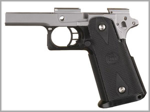

As for dirt/mud, the 2011 is built with short rail sections unlike the standard 1911. It's more like a glock vs a 1911 with its full rails. They built those rails like that to help keep any dirt/mud that may get in to the action from jamming up the works. These guns are not safe queens, there working guns and hardly any of the competitors baby them. These guns have to run tens of thousands of rounds a year with out any kind of failures.

I don't think I'd want to be in a defensive situation with a competition trigger. How light is the trigger on that STI? ADs are never a good thing.
Are you saying that some of the safeties are disabled?
I'd say you are delusional.
Prove me wrong
I can easily up the trigger weight by using a factory main spring and still retain the crispness. And yes, the grip safety is disabled, its snipped. I've got another to swap in if I start to carry it.
