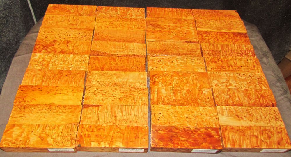

I've done a Google search and can't find any info on birch. no one seems to stabilize it for scales and no one seems to use it for handle or scales. I found lots of information on birch bark handles but it's not what I'm looking for. Being a hard wood it seems that white or yellow birch would make an adequate tough handle or set of scales.
Just looking to see what you guys think before making a pair of scales.
Spalted birch and masur birch are very popular for Puukko and Nordic knives. I like it for any small knife handle. Plain birch might be a bit ... plain ... but it should stabilize well.
My experience has been that Birch stabilizes very nicely.
Good weight gain and takes on a nice amber color when stabilized.
I used K&G for the birch I had done and was very happy with the results.
that karelian birch was absolutely amazing.
