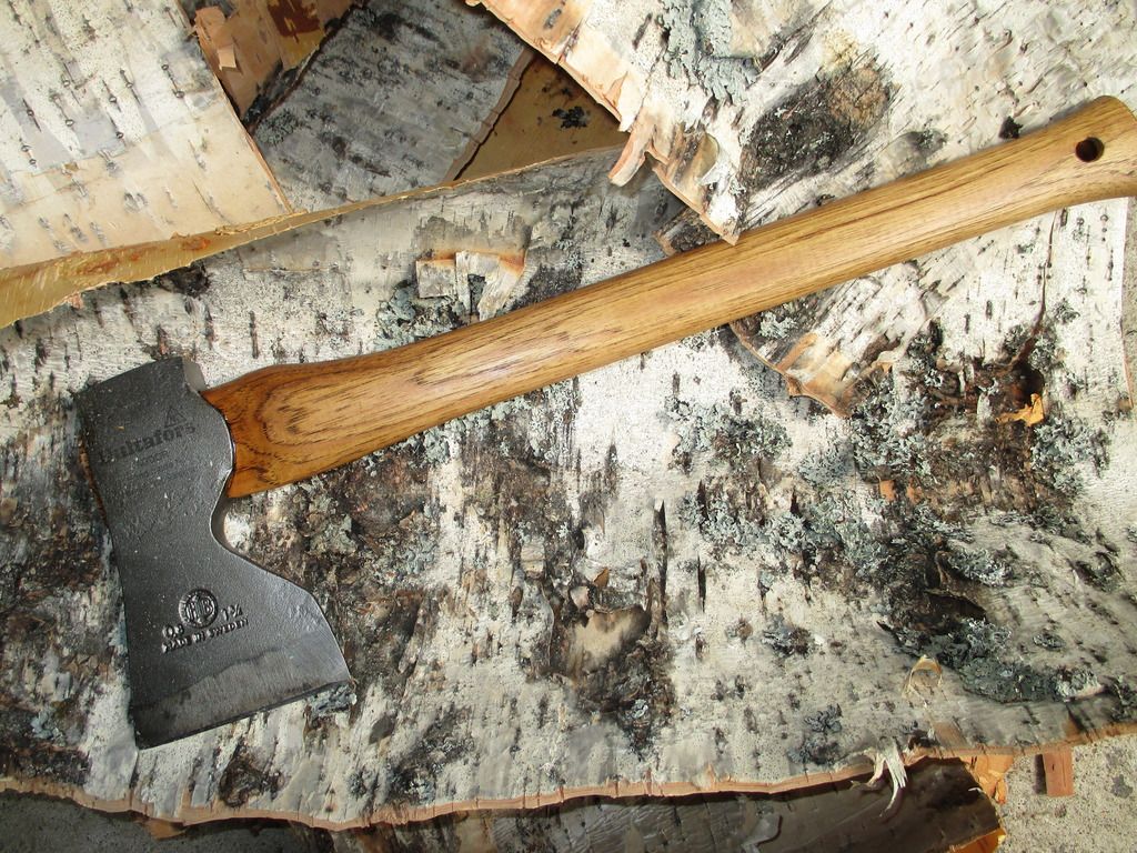

I want to share some pictures and thoughts about my birch tar treatment for my new Hultafors carpenters axe.
This is the unfinished handle, only sanded it with a 120 grit paper.

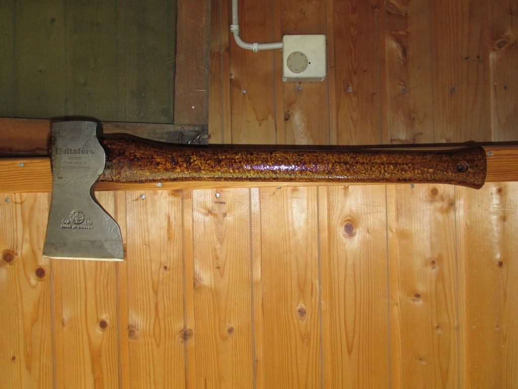

After the first coat of birch tar or birch oil, whatever you wanna call it.
This is the result! A really nice color and smell. Looks like I forced 6 months of use into the handle!
I guess it will work itself out in time, but as for now, the handle is really sticky and nice - which makes for a good grip, but it also makes your hands sticky. I believe this method of treating the handle would work better for a forest axe rather than a carpenters axe where the finish is key.

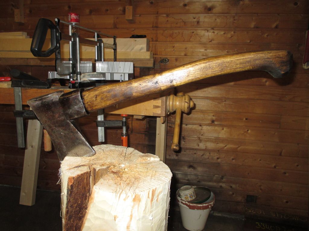

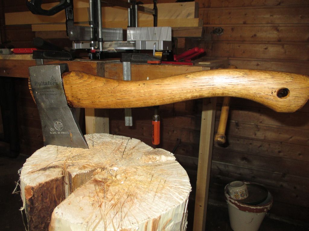

I might have used too much tar the first time, maybe I should've done it a few times more often but in smaller portions. However, the handle has soaked pretty much all of the tar as of now.
I carefully wiped it with a cloth and left it out in the sun for a couple of hours and it's completely dry now, as far as I can tell.

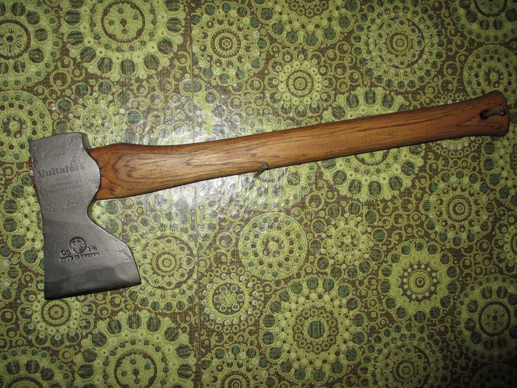

I promised I would let you guys know when the handle had dried. I checked the handle today and it was drier than the picture above. It's as smooth as silk now!
Beautiful axe, beautiful wallpaper! :D Don't worry, it's the inside of a closet!

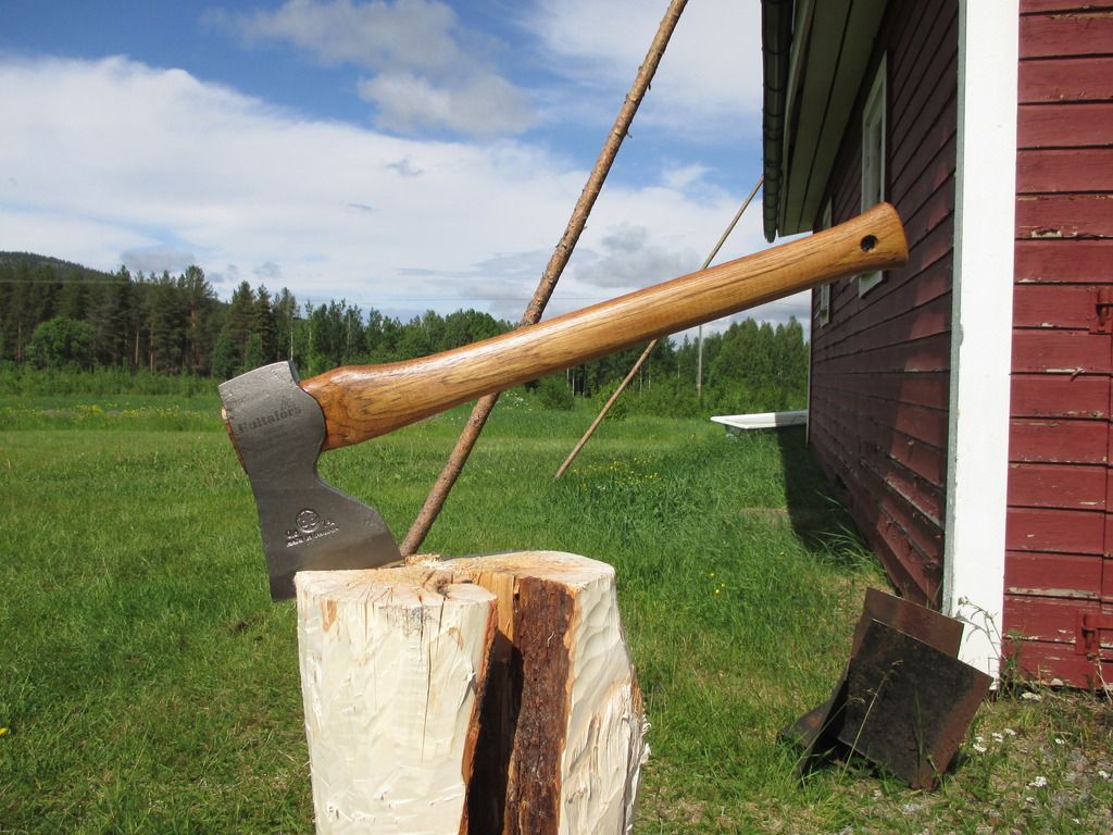

Here's how they look now!
I've done knife scales that way. Your going to love how it sheds water. Those are some great pics you took, thanks for showing them.
