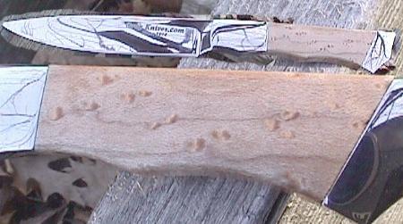

154CM with SS fitings.
I've had a bunch of this stuff for over 25 years
edited to add
this one is a through hidden tang, screw on pommel,
dovetailed in front, a real pain to fit just right . you'll see the solid piece of Maple is razed above the
fittings

Peterdon :) this stuff is not to bad, just got to be careful that the eyes don't pop out while working it.
BTW .. this one is a through hidden tang, screw on pommel,
fittings
Ray I'll show up with something ;)
you know how you forge the front fiting to fit your knives ....
this one I milled out the solid price of SS to embrace the blade, milled the tang hole from the back rear end and milled in the dove tail then matched the front of the Maple..

before I was stabilizing my own I had some of this Maple treated by K&G
I grind her down starting with a hogger,,then 220 400 to 15 to 91/2" micron and a light buffing with white rouge hand sand if you can't get at parts of it.
I finished the wood off the tang, with this one.
if this were bear wood I'd skip the rouge back up a liitle and use some minwax wood harder or something on it and refinish,
the steel is done almost the same
hogger 60 grit or 80 depending what I have at the time :)
,,then 220 heat-treat go back to 220 400 to 30, to 15 micron then hand sand 1000 - 1500
then a light buffing with white rouge
I use to use the 9 1/2 belts = to about 2000? grit but it's only good for about 3 passes on each side and there goes $3.50 :eek: :grumpy:
opps same for the ss fittings
reading it again,,,treatment?
do you mean heat treatment? and cryo?
