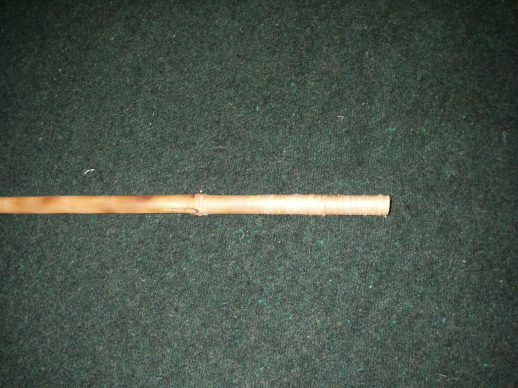

the other posters are right about the flex of the dart, if it don't flex well it won't work right. river cane is what i use, works great. a few guys i know use giant rag weed shafts, look odd but they do work. on the cane if you slide a for-shaft into the end after you wrap the bottom with sinew or cord that's been glued it will last a lot more throws.

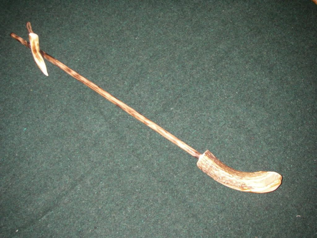

here's a few pics of mine.

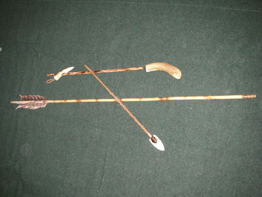

I just finished another one with 3 darts.
ceder atlatl, used a piece of Osage for the hook.

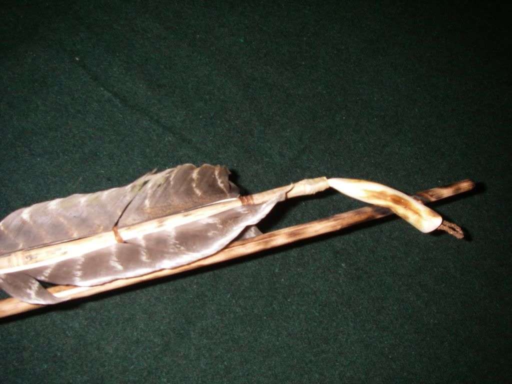

river cane shafts, turkey fletches, sinew wrapped nock and point, used dogbane for tying the fletches.
point inserts are grey stemmed dogwood, flint points, held on with sinew and pine pitch.

thanks, i knapped 2 of them i got a little lazy and put an arrow head on that a buddy of mine made for me (160 grain point), mostly because i didn't want to go outside in the cold and knapp any myself. felt like i should so i broke down and knapped 2 of them in my basement. i'm paying for it now sinuses are all jacked up from it.
