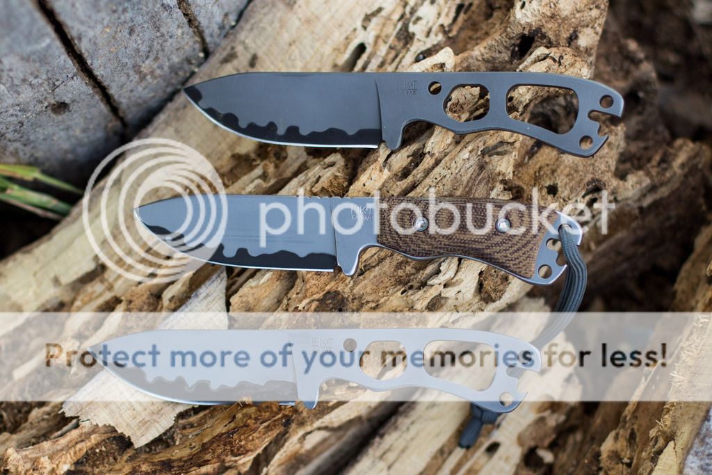

IMG_2497_zps1qt4vmyy.jpg~original
Whoa... at first I was all sad for the bottom CSMs edge... then I looked a bit closer, and realized it was a 'chop photo, so it makes more sense :).
But interesting, i didn't know that the CSM's were thicker.
