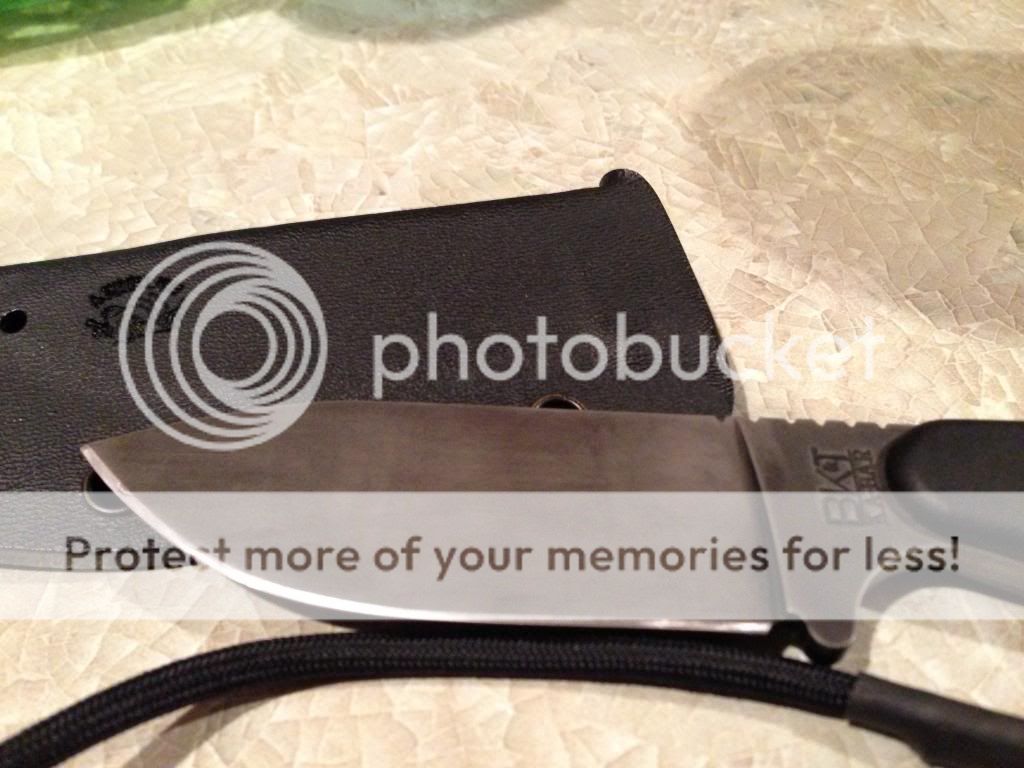

Hey guys, first post on here. I just recently purchased a BK-14 and I am wanting to strip the coating off. I know you do this with paint thinner and a wire brush. i was wondering how you would ensure it from not rusting. What kind of finish should I put on it?

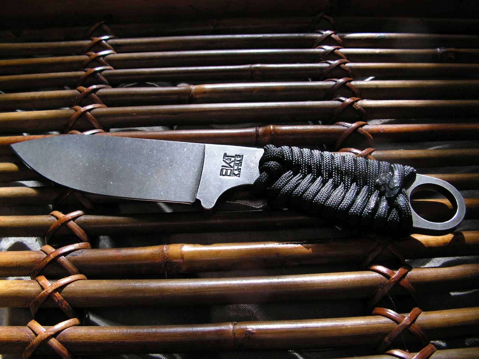

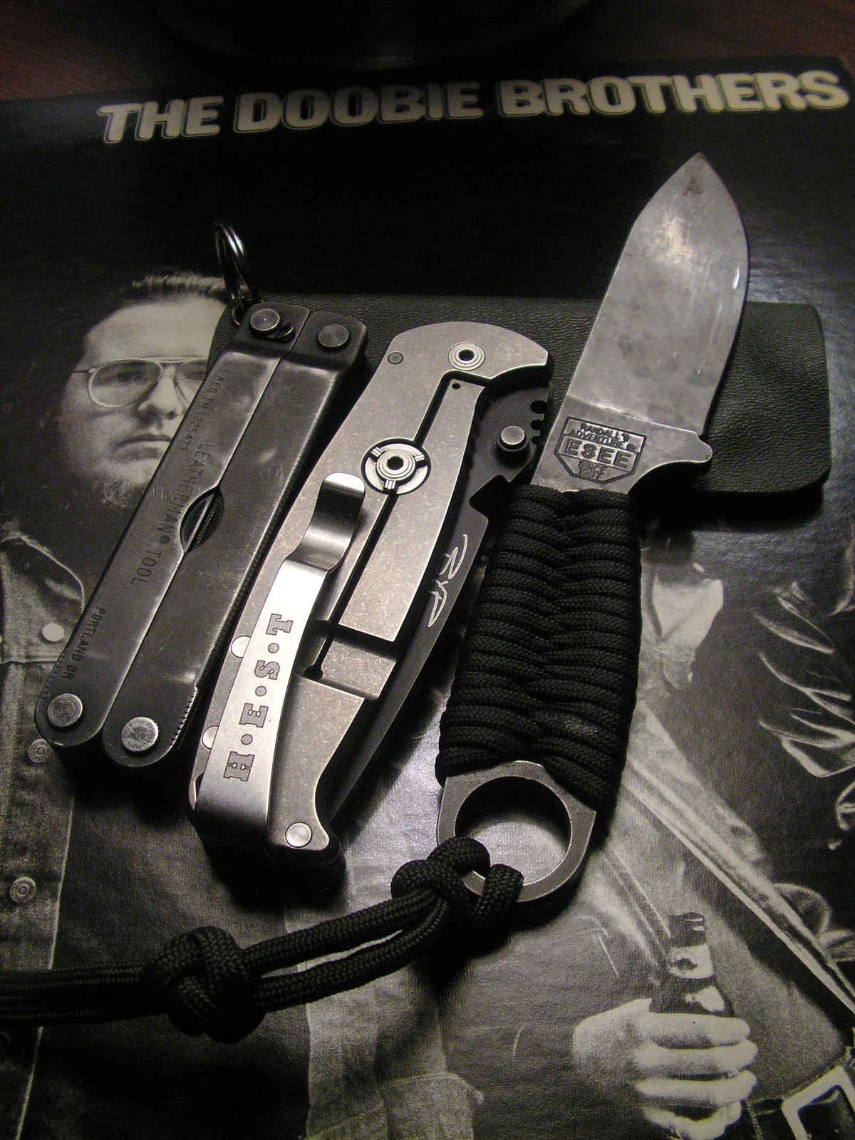

I used paint remover and a gasket scraper tool. My 14 was stone washed under the coating so I just left it that way.After using the knife to cut limes,onions ,oranges ,apples, ect. it developed a patina pretty fast. It did get get some spotting of rust when I forgot to coat it with oil and left it in the sheath for a few days.The rust did wipe off with a little oil .
this is pretty much right after I stripped the coating.
this is after some use.
