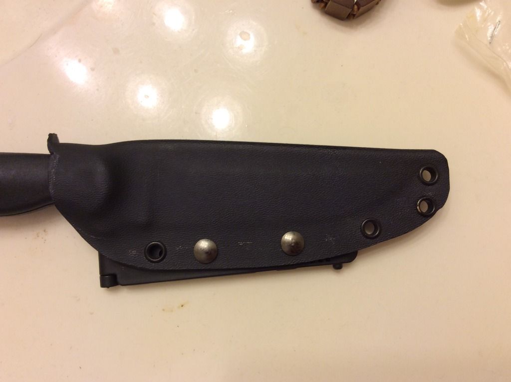

Hey all
what do you think of this kydex sheath I made?
Any suggestions would be very helpful as this is one of my first kydex sheaths I've made.
thx

Yep, looks good.
One of the holes seems a bit close to the edge. Not sure if that'd be a weak point. Asethically, you might smooth the edge more.
But very nice for a first try.
Very nice.
Two thoughts. Your thumb may take a beating - the ramp looks a bit rough and jagged? And consider a drain hole... don't ask me how I know:rolleyes:
Very nice work!
I'd say look at molding in a thumb ramp kinda like 710 and Azwelke do.
It's nice because you can eject the knife with just a push of the thumb and not pull it out violently.

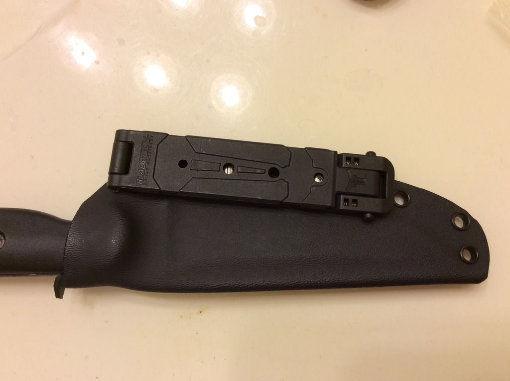

I really like those style of clips too. Very versatile. I knew Esee made some, but I didn't know Bladetech made them too. Very cool!!
Yeah they are know as molle lok work great still need to buy a tek lok though
The rivet that is real close was a grinding accident didn't realize it bites that deep I want to sand the sheath smother but don't want to risk loosing much material with that rivet
Thx for all the help

The rivet that is real close was a grinding accident didn't realize it bites that deep ...
Yah, been there, done that. ;)
As recommended, do it by hand and take your time.
Not too much of a risk here. It's not like it's a critical mount point, or has to support a lot of weight, and any crack could easily be expoxied.

Btw it does have a Drain hole when I folded the sheath over for taco it didn't get flat all the way so it's integrated into the design :D.
I'll post a pic later
