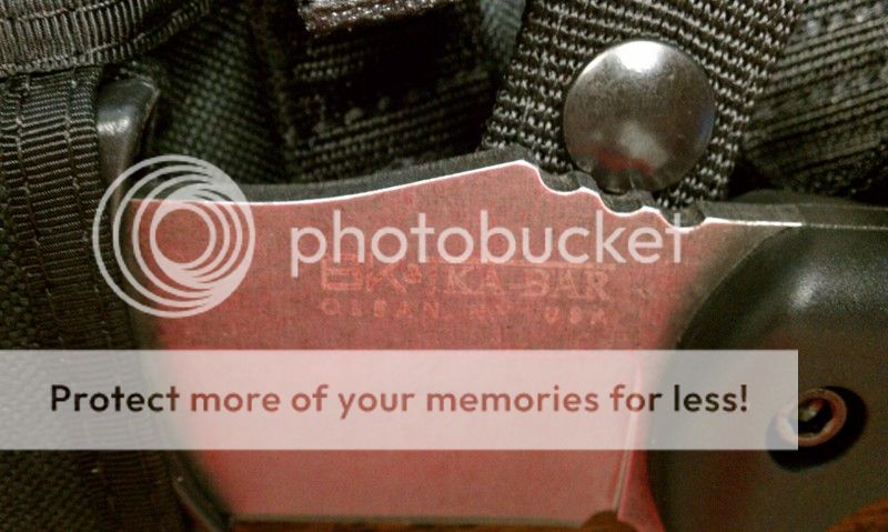

Here's a picture I just shot of the logo on my 10. I just stripped it this morning.
The laser etching is apparently done after coating and it burns away the coat and into the metal to whatever depth it is.
I can see with a loupe that it's clearly engraved but it is also very shallow so if you really want it to stay, I'd suggest re-enforcing it by etching.

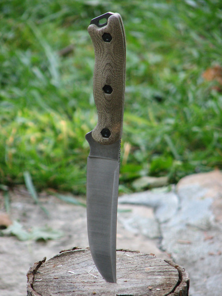

I think this is going to be a handy addition to the clan,
