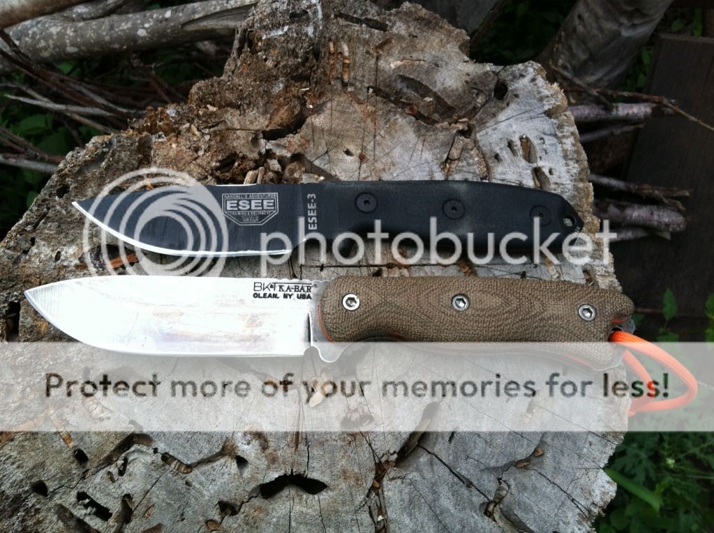

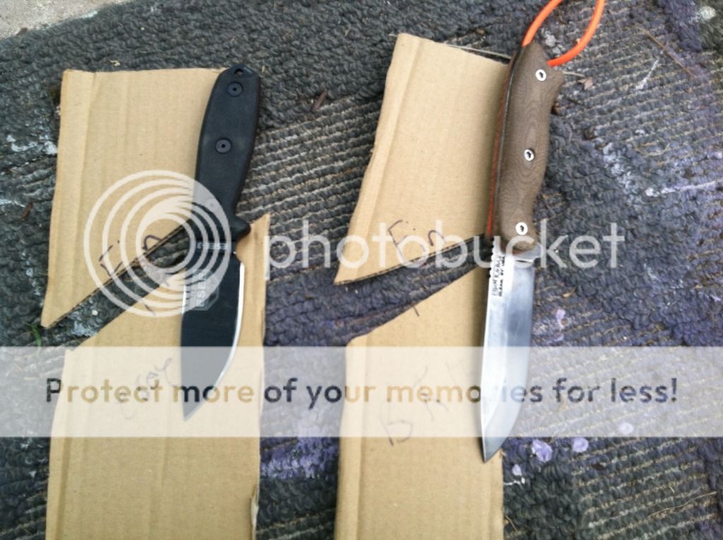

Both have micarta scales and orange g10 liners. Bk is 20 20 inclusive and esee is convex edge.

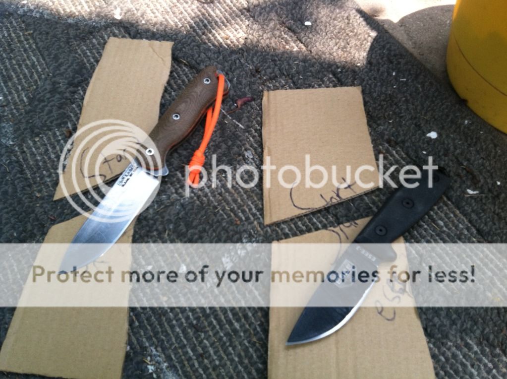

Start

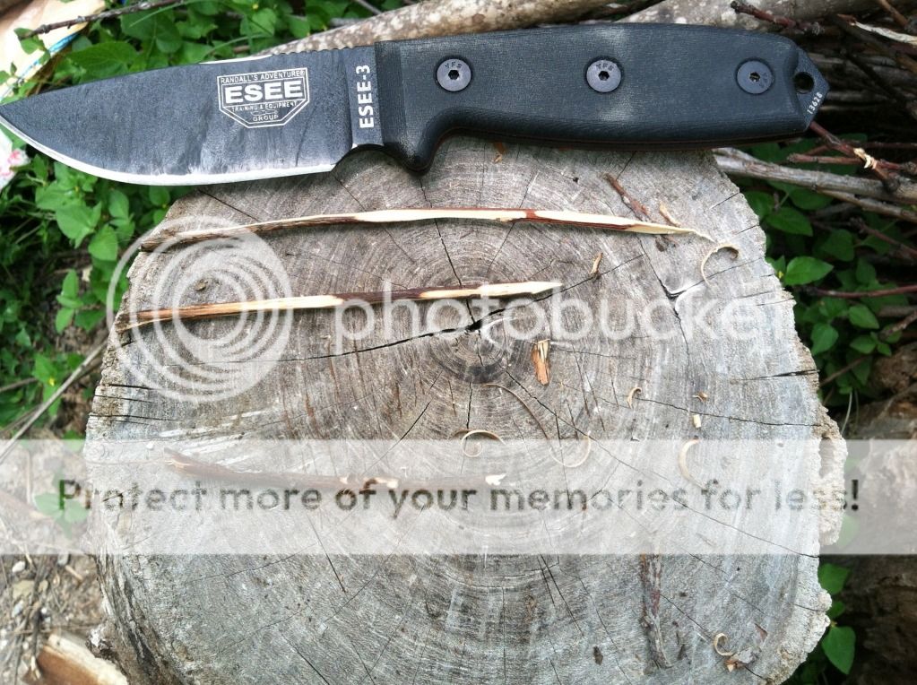

Fine work

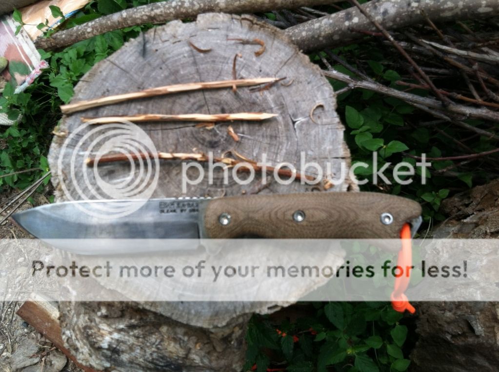

cutting paracord

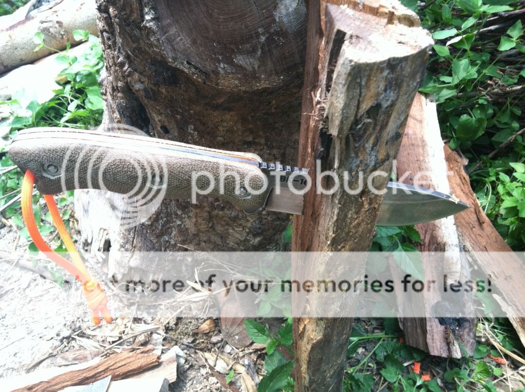

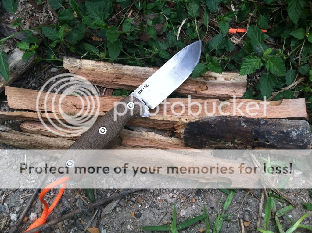

splitting aged mesquite

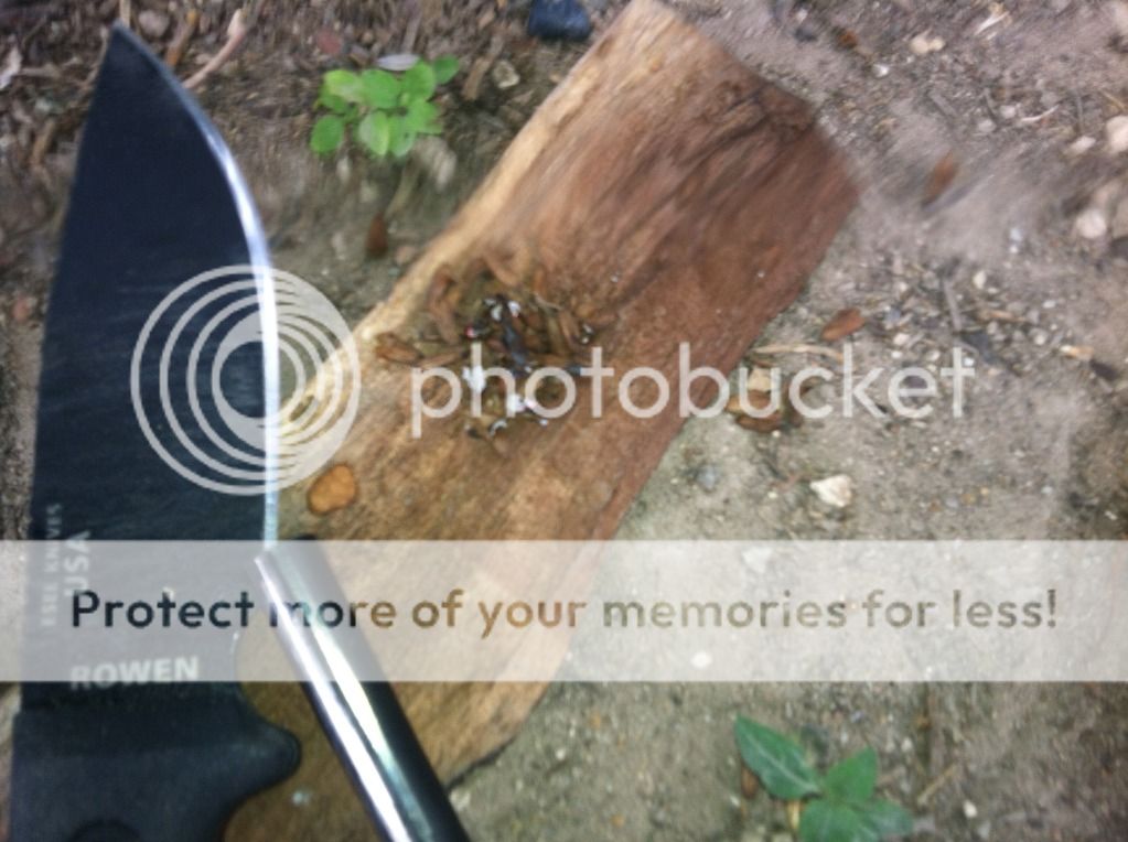

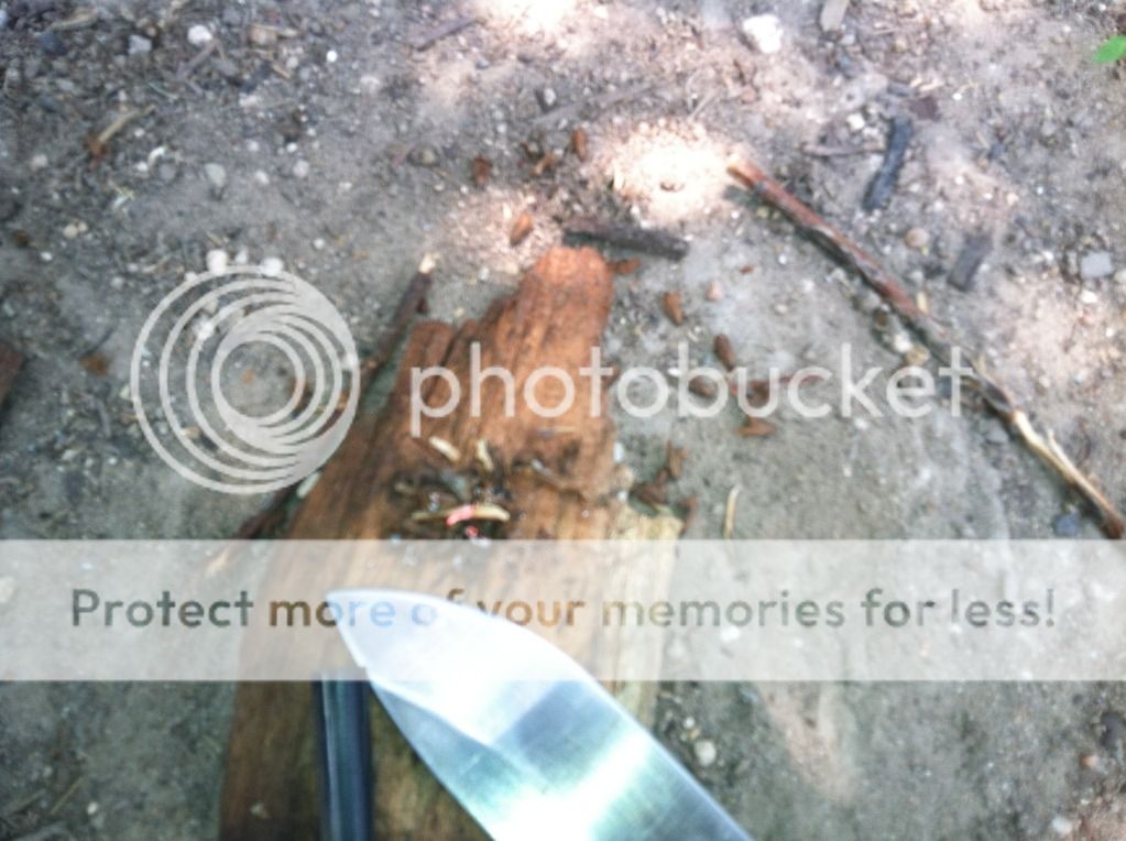

spark throwing

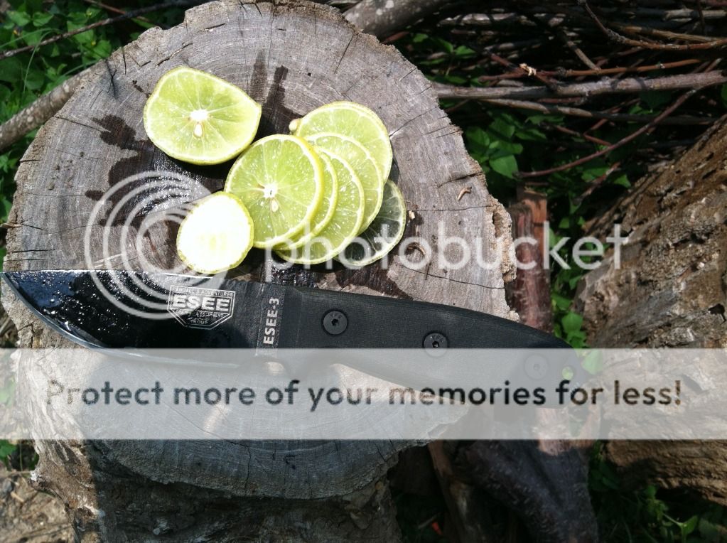

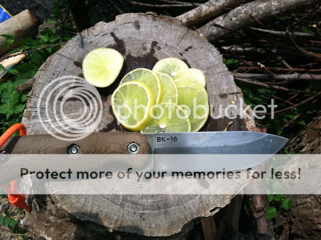

slicing ripe limes
finish
At the end of the day both are great knives. The esee had a slight advantage with slicing which may be due to the thinner blade and convex edge. The becker was slightly better at wood crafting and camp duty. But to be honest most of the differences were very very close.
I think it comes down to handle preference. The becker was more comfortable for sustained use and larger hands. The esee may be more comfortable for medium and smaller hands. Either knife will serve you well in hard use. Both knives were back to shaving sharp after a few passes on the strop with some red compound.
Both becker and esee have their heat treat down neither had any chips or rolls after tackling some hard wood. Thanks for looking.

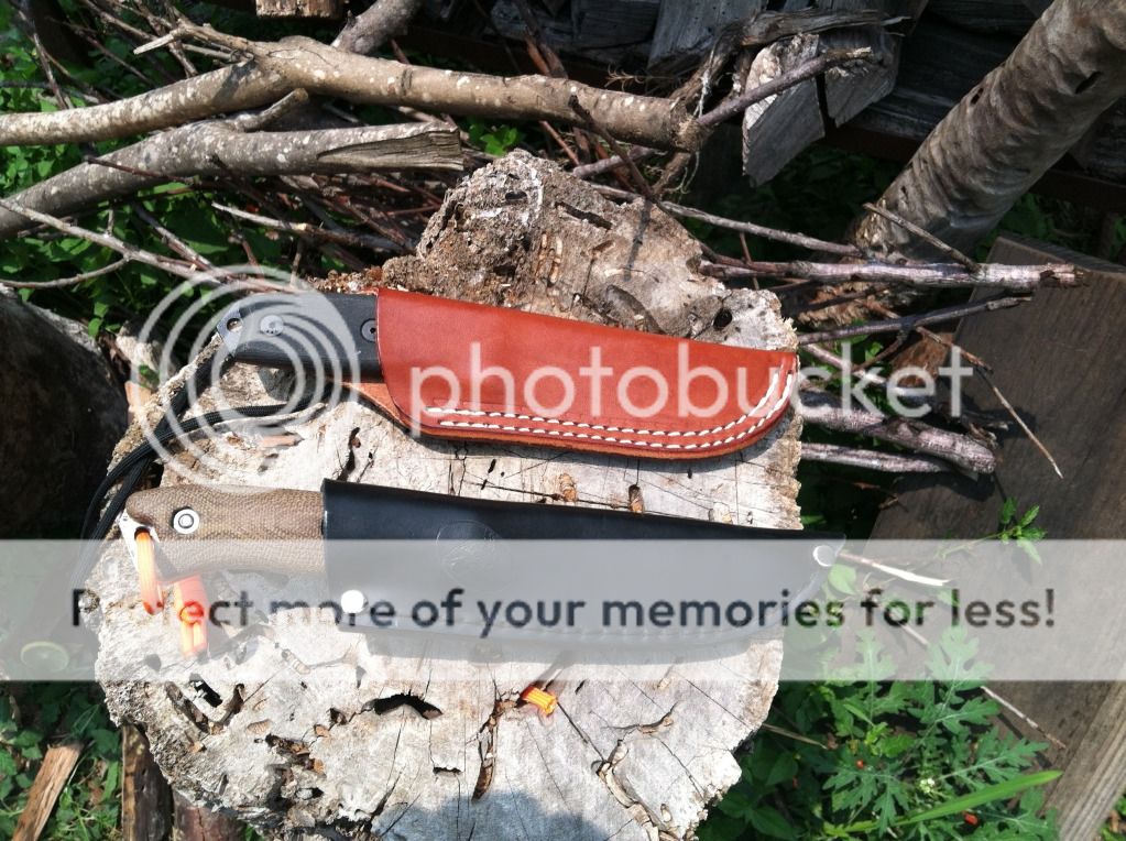

That's kinda what I thought that the micarta had darkened. Haven't used my BK16 yet although it one of my favorite knives I can't stand the sheath (not a fan of fanny pack knife sheaths) but have been carrying and abusing an ESEE 4 for awhile now. Can't wait to either buy or make a simple sheath for the 16 then she will get some use.
