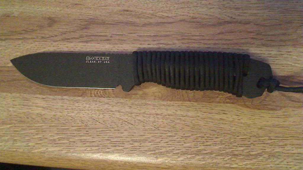

This is the wrap I had previously done for my BK-16, and posted in the bk-16 thread. It came out pretty good, and there's 5.5 - 6ft of paracord on there. I achieved this my using a broken hacksaw blade to remove the center piece from the knife, and inserting a cut length of black pen. I used the ben because if the slightly thinner butt end which goes down by the first finger. The cord was bunching up there badly and needed a little extra space. The pen was the perfect fit. Cutting tthat chunk of steel out of the knife may be a Little dangerous for hard users, but I don't see myself beating the hell out of this knife at all any time soon.
Here's a pic of the pen inserted into the knife where I cut out the steel.

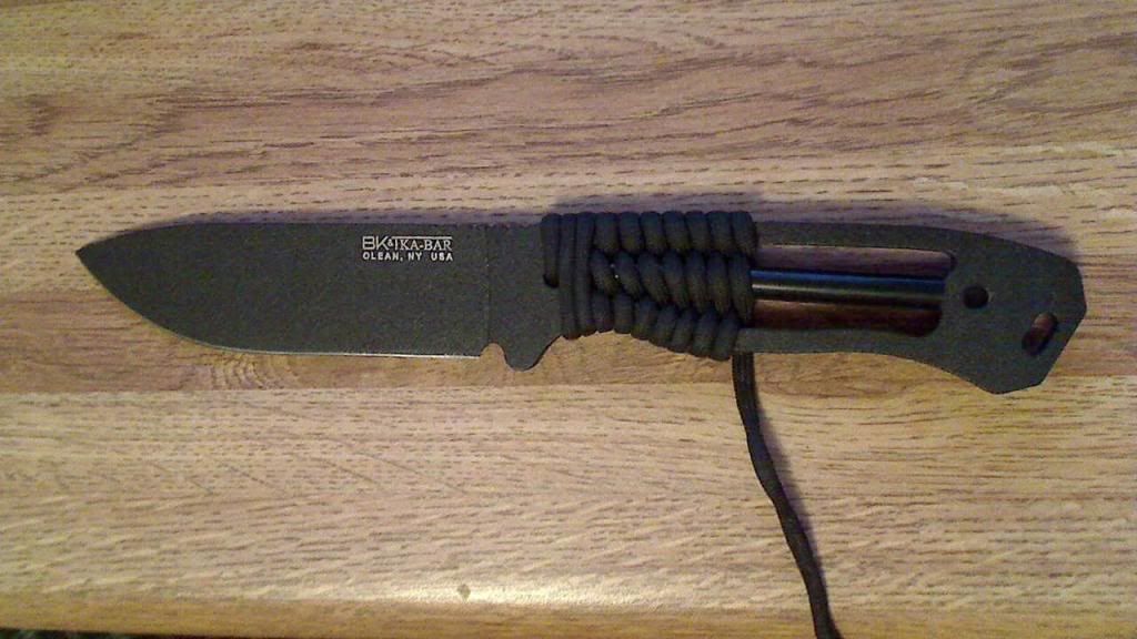

This is the second wrap I did. It's definitely not much to look at, but it's a vast improvement as far as comfort is concerned. I used the same pen and wrapped paracord around the pen, then around the outside of the handle for a more hand filling grip. It's not pretty, but it feels nice. There's also 9ft of paracord in this wrap as opposed to the 5.5ft in the previous wrap.

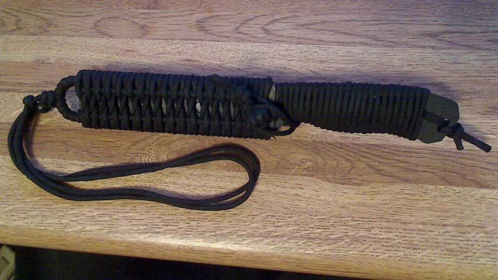

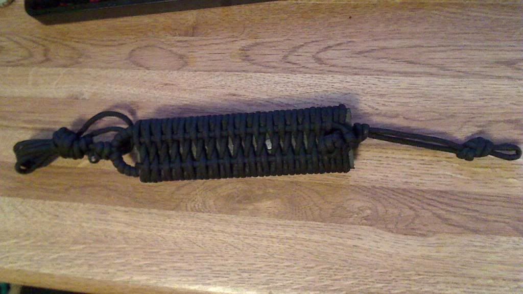

This right here is the REAL money though. It's a the plastic liner from the bk-16's original sheath, which I removed and came up with this sweet paracord wrap for. I also found out if you take the plastic liner out, and turn it upside down, the bk-16 will friction fit into the sheath and not fall out. I shook it violently and swung it through the air pretty hard and it it never came loose. This is only valid if you've paracord wrapped your handle, or modify the liner slightly, since the scales don't let the friction points touch at all.
Here's a pic of it hanging by the lanyard/belt/thigh strap. All friction baby. In this pic you can also see the multi purpose belt loop/retaining strap hanging down. This sheath actually has like, unlimited carry options. It's ambidextrous, neck carry, shoulder carry, cross draw, scout carry...everything. The pics below should be proof enough.

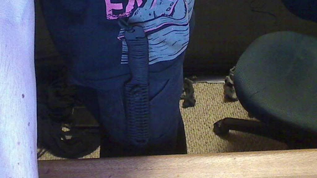

Belt loop + thigh strap
Cross draw, if you use the neck lanyard as a belt, and feed it through the belt loop.
Same deal with the scout carry. The cross draw and scout carry with the lanyard as a belt is a nifty idea, but it's not ver comfy, and not really secure. It'll work in a pinch, but it's not a full time option. I'd like to fix this, but the weave is SUPER tight and I don't have a fancy paracord needle or anything to add parts to this. The belt things works, but barely.

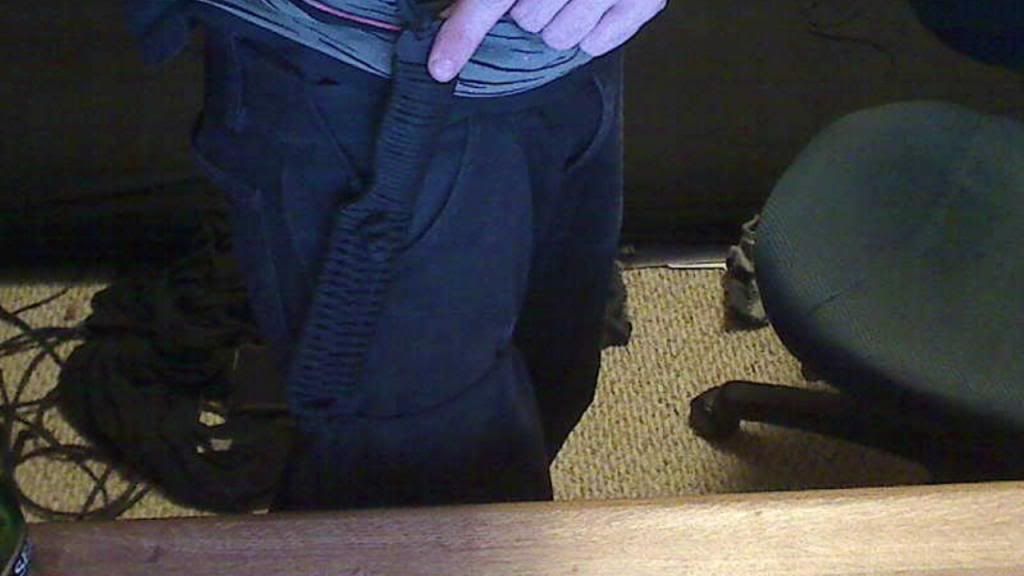

Low-slung should strap style.
Short shoulder strap style. Good for cross draw.
