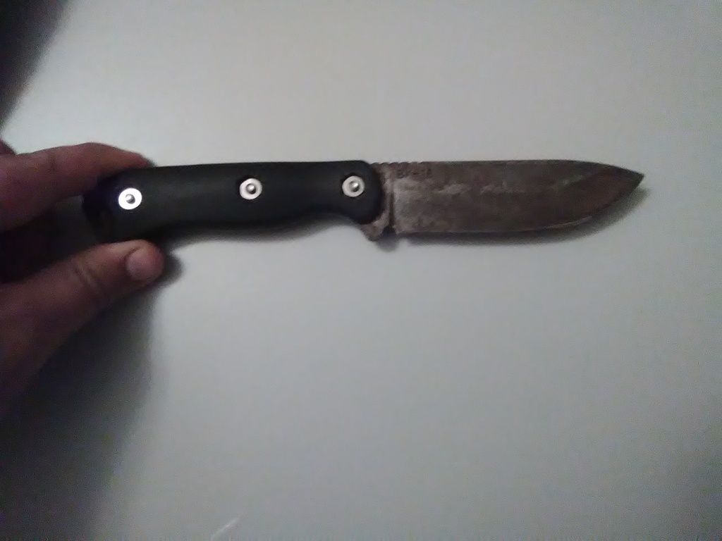

A while ago, my brother gave me his BK-16 to turn into a "Regalia Knife" for use in Seminole garb for Order of the Arrow ceremonies; I have just gotten to chance to work at it, and wanted to get some suggestions.

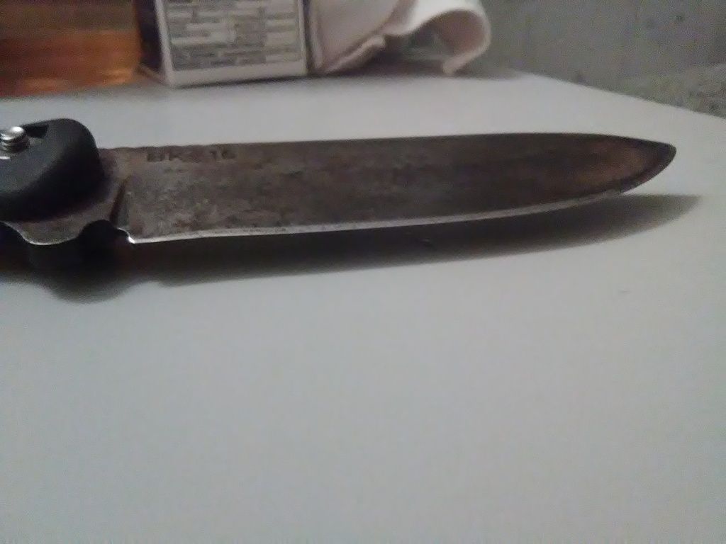

My brother stripped the coating, so I'm looking to get the rust off, and suggestions are appreciated.
After that, I am looking at wooden or leather grips for it.
A friend of mine is providing a leather sheath for me.
It's good to be back here, as I work on this project, I anticipate spending a bit more time on the form.
Any help is appreciated.
Thanks.
I would use mineral oil and fine steel wool. Remove the scales. Rub some mineral oil on and then start lightly rubbing the knife with steel wool. Everything but deep pitting should come right off.
Be mindful of the edge at all times.
Jeremy
I buy my mineral oil at the drug store in a big bottle. It is in the laxative section. It is cheap.
So, remove the grips, lather and lube the blade, stroke with the steel wool to remove rust, and don't touch the tip (or edge). Got it!

I know it does not answer your questions(s), though others have given sound advice, but that knife sure looks purdy the way it is ... just saying.
Yeah, it has a certain character about it now, but I want to protect against rust which is where the patina comes in.
