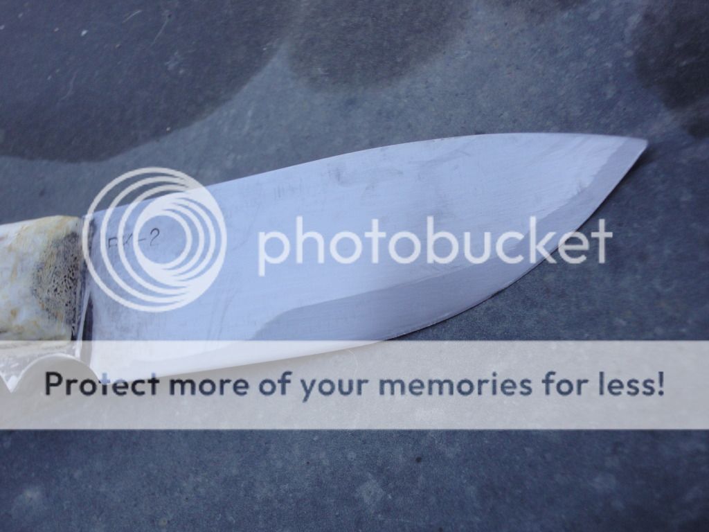

Here is the blade after the first nights work. I did everything with a Black Diamond file and emery cloth and a sanding block.

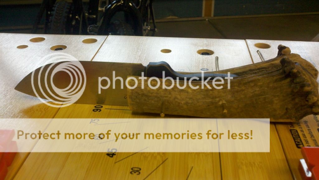

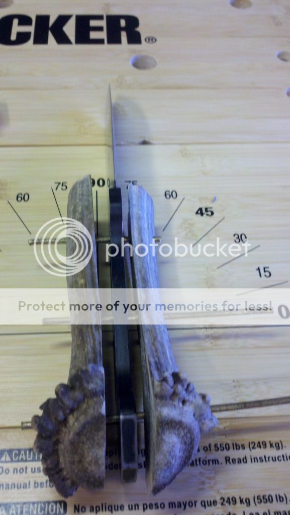

Test fitting the antler shed. I cut it in half with a hack saw.

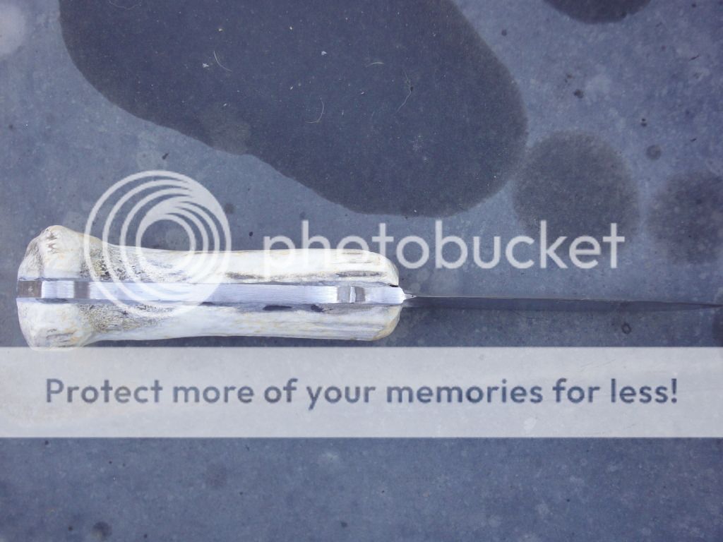

Im a measure 4 times and still screw it up kind of guy so I decided to do the basic cuts and then glue and pin it and then do the final cuts and shaping afterwards.

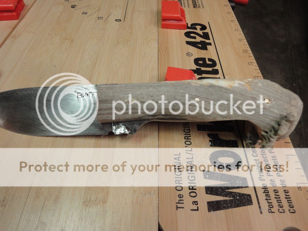

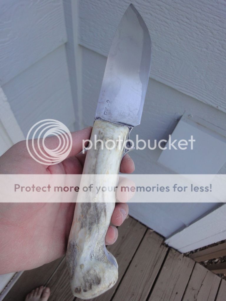

Here it is glues and pined. My Dad LOVED JB Weld. He used it to fix everything so I used it as the epoxy for the scales.

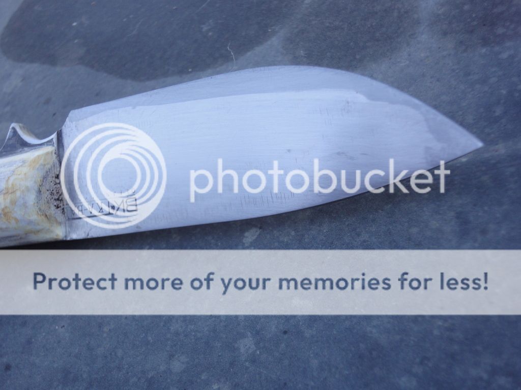

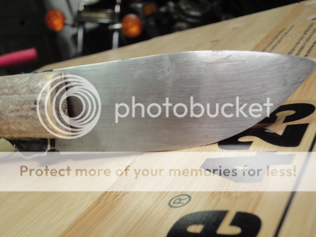

I close up of the blade. Ive only taken it to 400 grit emery. Its a working blade not a safe queen.

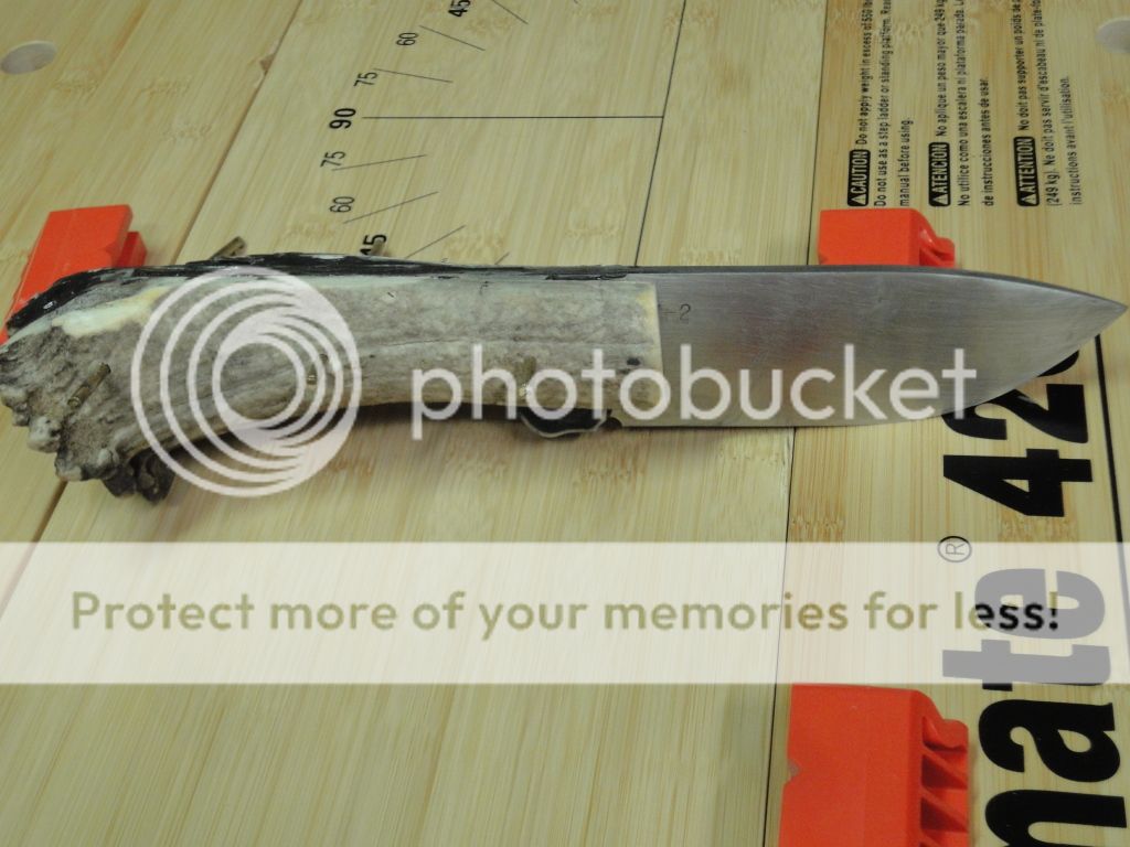

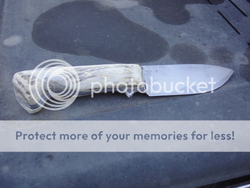

This is where I ended up tonight. The wife said I had filled the house with the smell of something burning. Well yeah, I was using a dremel to shape the scales.
