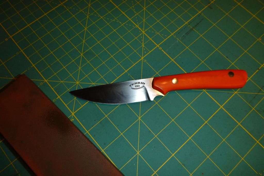

The ricasso is the flat full-thickness section between the handle and the blade bevels. I'm a fan of as little ricasso as possible, especially on smaller knives. I'm generally not a fan of sharpening notches or finger choils... all for the same reason: for whittling or carving, your best leverage and control is right in front of the handle. The blade should be sharp there. ;)
I don't know James, this is an awesome knife.......:D
That's a "custom" custom...and I'd change that to "The boss is always right." :D She loves that knife and I have to admit it is the sliciest thing in Kentucky.
