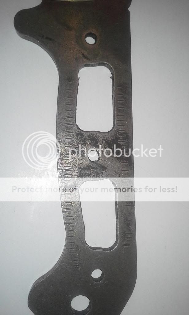

Got a BK10 a while back to add to the rest of the Becker collection.
As per usual, I strip my blades.

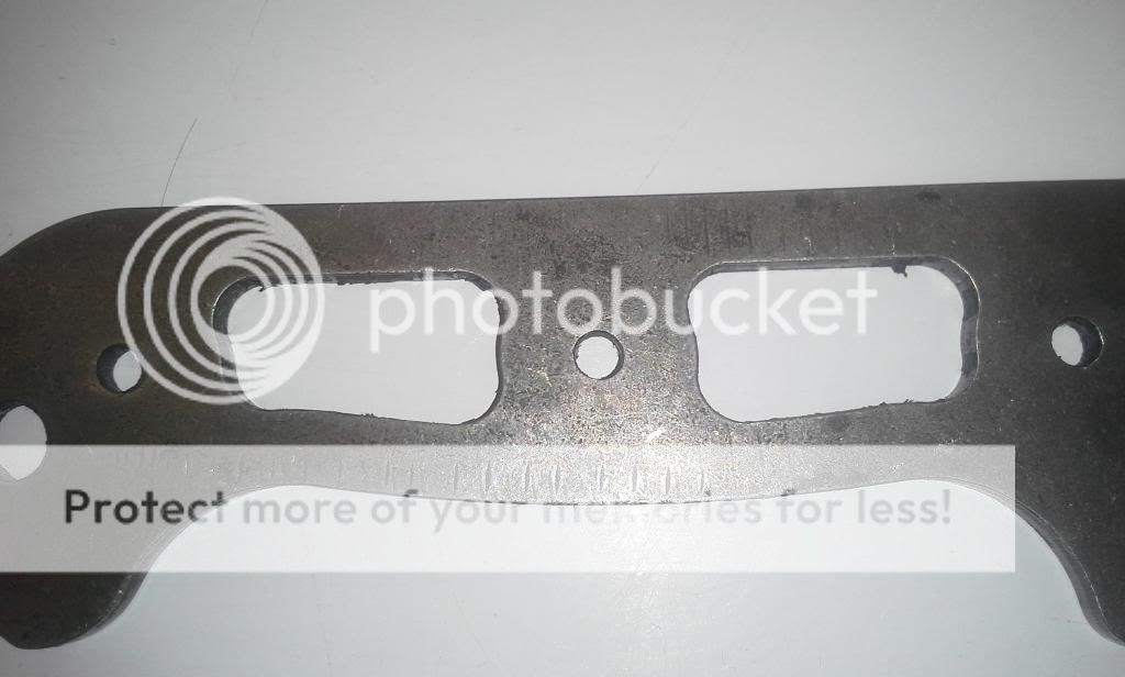

Prior to stripping the BK10 I noticed what I felt were a few tooling marks along the face of the tang on each side. No biggie I felt. After stripping though, it became far more apparent how many of these marks there were. Sorta like train tracks running down the tang. It's worse on the left side than the right. There is some depth to the marks, enough that you can feel it when you run your fingernail along them. But they're no where near as deep as let's say the tang stamps on the older Beckers.
Pics are below. Now as ugly as it might look, I don't think it's cause for concern. I don't think these marks could compromise the strength of the tang given they appear to me to be more or less cosmetic....but someone can correct me if I'm wrong on that.
Given I've stripped it I know a replacement is out of the question...and honestly I don't think it's needed unless the powers that be think there's cause for concern here.
Main question is....what would've caused these marks at the factory? Thanks to all for any info you can provide.
Left side
Right side
well, i'm sure we can get Toooj to step in (it) and tell us, maybe it's a claim/vise marks from sharpening?
worst case, it could also be residual left overs from raw bar stock, and end perhaps. it's possible it was full length, but they were ground off.
on the handle, it's completely unlikely to be a cause for worry.
My money says some type of roller to push it along the line or oven ??? Just a guess. I'd say no cause for concern, just cosmetic. Others with more knowledge than me will chime in soon.

I think you're on to something with vise marks Bladite. That's sorta what I was thinking they look like. Hoping Toooj will chime in.

A lot of my Beckers have marks under the handles. Toooj said something about a roller type machine and that it is just cosmetic. It wont hurt a thing. Also I have never heard of Kabar refusing to replace a broken Becker. Now they probably wont send you a new one because you don't like the marks under the handle but that's different lol.
I don't own any Beckers, but all of the stripped Bussekin knives I've owned have similar marks. I don't see any reason to be concerned.

Not looking for a replacement. Don't care that she's a little ugly under her dress...lol! Was just more curious how the marks get there in first place. I own several Beckers and this was the first of them I've seen like this.
Thanks for this link. I think this likely solves the mystery and it's what I was thinking in the first place that these marks are a result of a straightening process. I could care less if it's not pretty, just as long as the knife is durable....and it is! Thanks everyone, I think we can let this one go. Was my own curiosity. I'm off this weekend to beat the tar out of this BK10.
