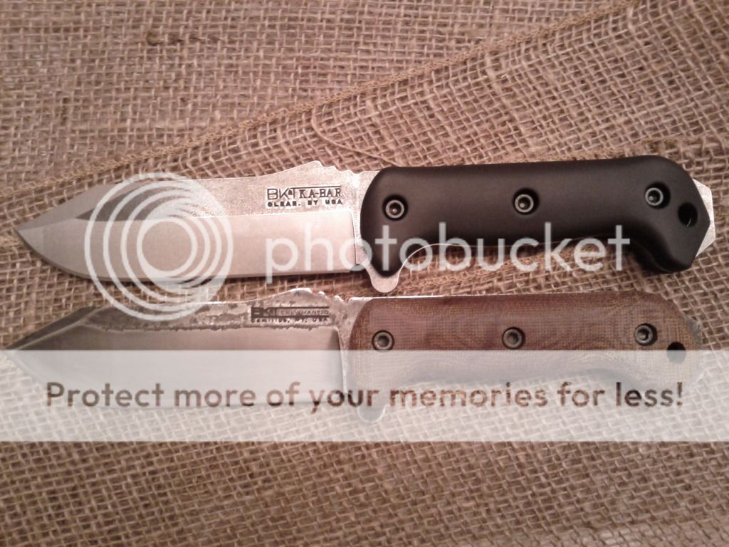

The Camillus grind is substantially higher, which I think is an advantage. Unfortunately Ka-bar seems to grind all the full-size beckers to the middle of the handle bolt, not the top. On the other hand, Ka-bar materials, quality, and solvency are fabulous.

How are the grinds different on the Camillus and Kabar limited if Kabar used Camillus blanks? Or am I missing something.
I wonder why the grind is so much lower on the 10 then the 7. I like the higher grind on the 7 and wish the 10 was the same way.
The blanks are just that, a flat profiled piece usually cut with water jet these days. The grind is done later. So the grind was done later by Ka-Bar on the blanks from Camillus, therefore the difference in grind profile.
