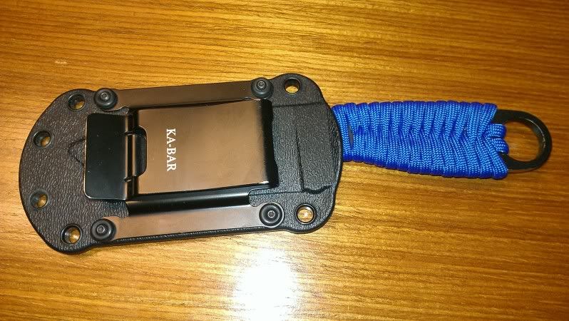

For the money, the TDI clip is really good. It's certainly not going to let your sheath go anywhere once it's clipped on.
Here's how mine is set up (was riding on my belt until I pulled it off for this pic):

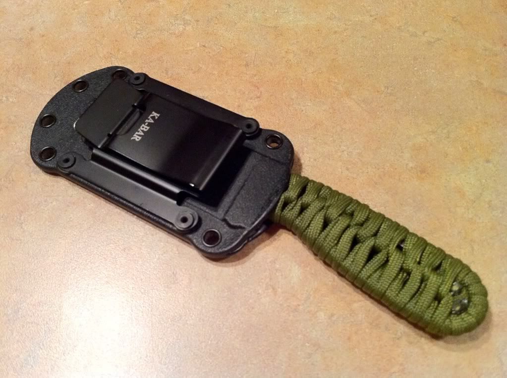

I had to carefully drill a couple holes to do this...the hole has to be big enough to accept the female part. If you drill a hole just for the screw the female (nut) part won't recess down into the sheath as you tighten the fastener so the rubber washer will compress. I just used one larger bit at a time until I could insert the female side into the sheath. It still wasn't so large that the screw would fall through the hole on the other side.
It is held to the sheath with just two fasteners on one side of the sheath. Sturdy enough. No need to overtighten the fasteners. Maybe a *small* amount of thread fastener, nail polish, etc. if you really like it.
