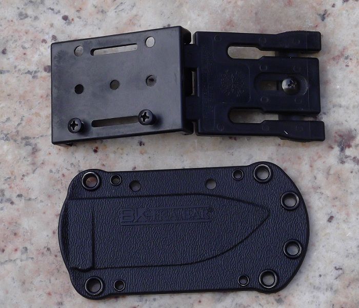

Will tek loks work on a stock 11 sheath? I want to get more use out if my 11. Id love to carry it edc but don't care for it around my neck all the time. However it is my go to knife while duck and goose hunting. It's much easier to get to access in waiders when its around my neck.

No they will not, unless you make some sort of mounting plate or drill a hole.

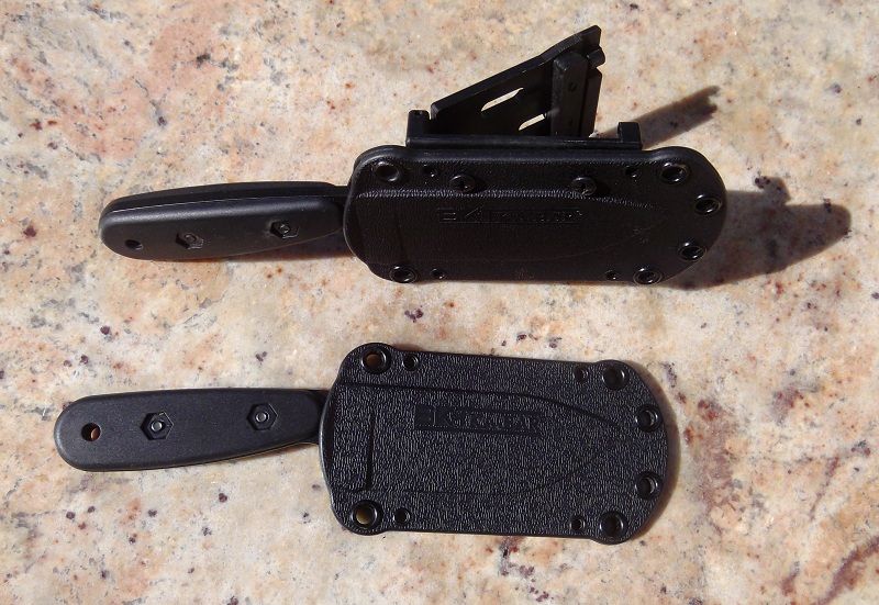

Put the TekLok where you want it. Mark it and drill 2 holes. Easy way to use it with the factory sheath. Pictures below.
But I agree with dresnor. If you really want more use from your 11 get a custom sheath. It makes a big difference. You will like it so much more. My factory ones all got loose over time as that little nub wears out.
