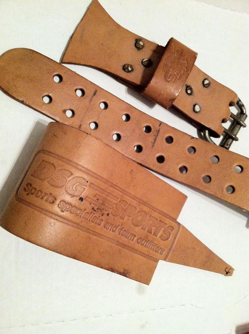

I picked this up at the thrift store one day figuring I could do something with this thick sturdy leather one day. Then I got the BK14 and the idea struck me... Scales! So I did my 15 too...

I did use epoxy and let it cure in a clamp. I scored both surfaces but I believe it can separate easily if tried. No idea what the weight belt was tanned with it was a thrift store 3.99 score. It's a good 1/4" thick so that's one solid piece on each side. I'm about to start a more detailed thread on the same for the BK5. I'll link to it from here soon.

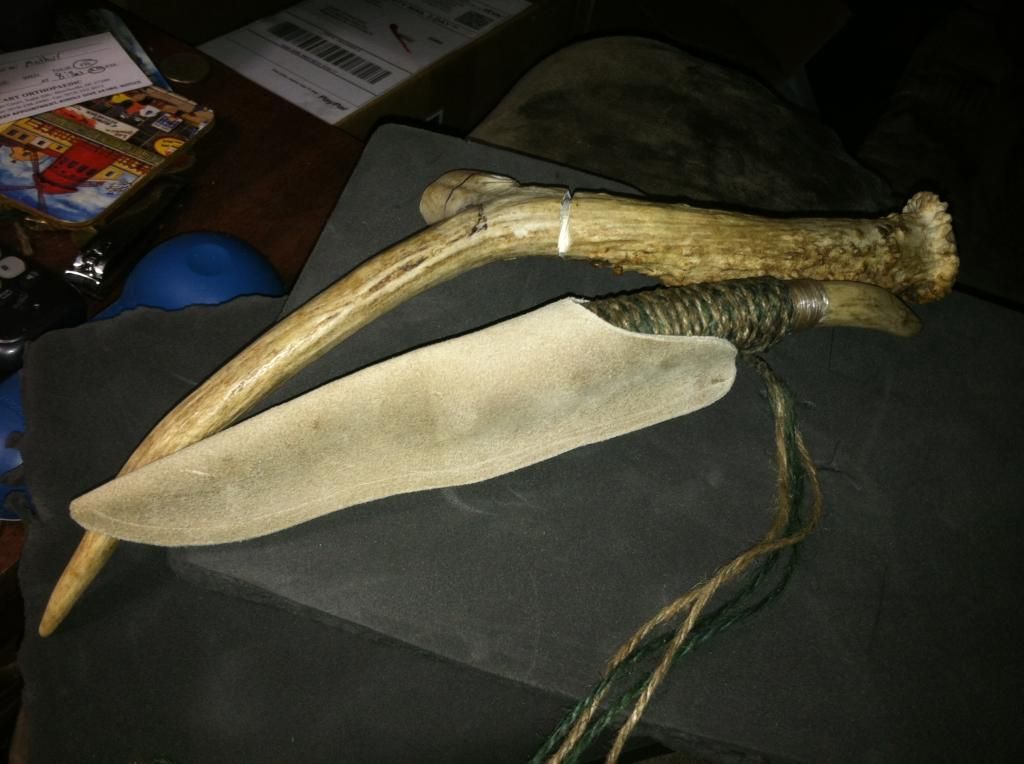

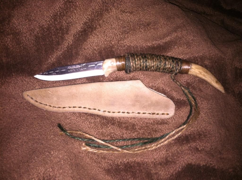

These are my second attempts at sheaths. First attempt was for a small old hick parer I put an antler handle on.
