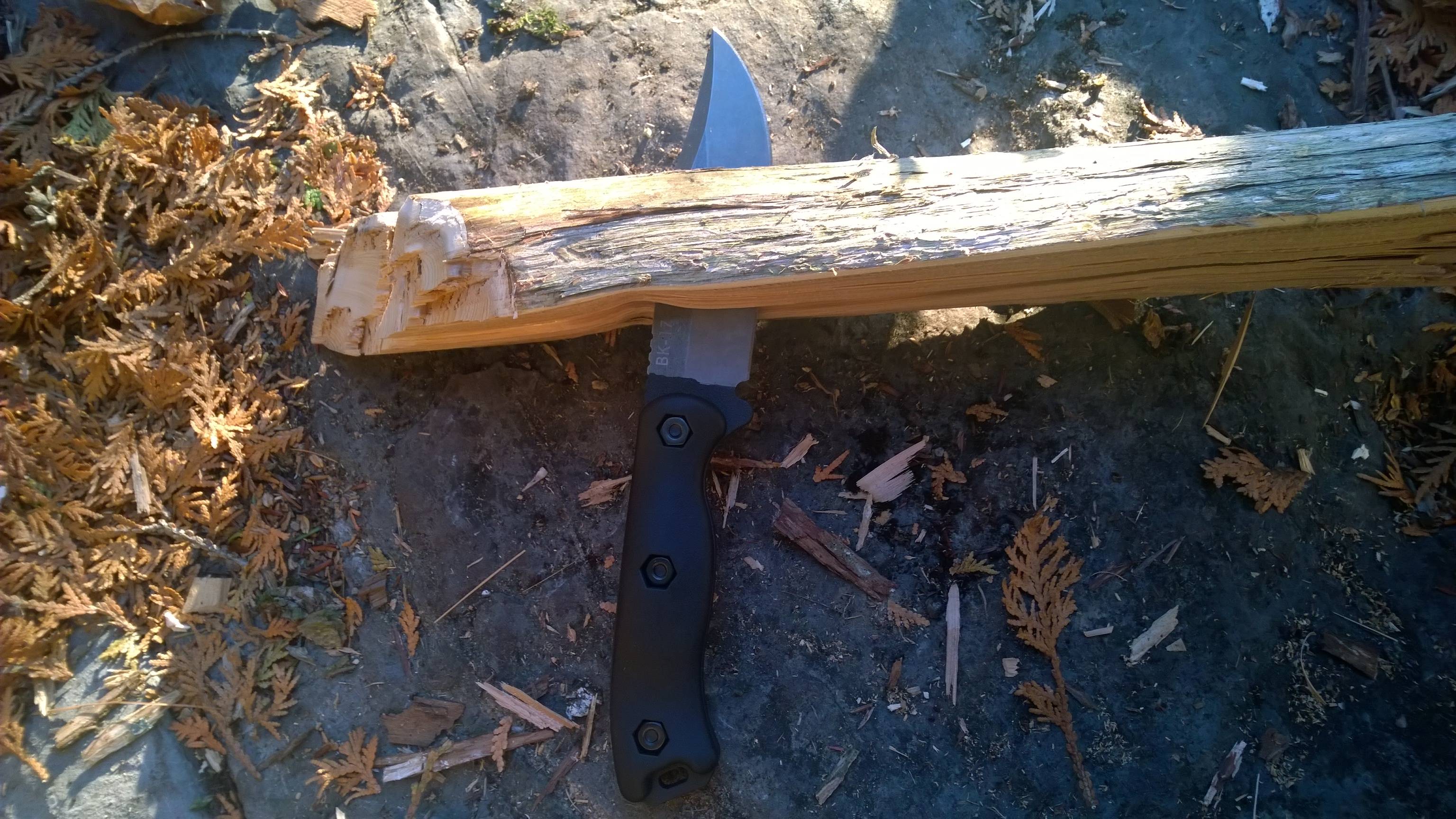

I hand stripped mine using only sandpaper. I proceeded to polish it using only sandpaper. Stripping with paper will take a lot longer, and getting it to where mine is will take tens or more of hours.
In pic 1, that is just some bark, not a chip.
