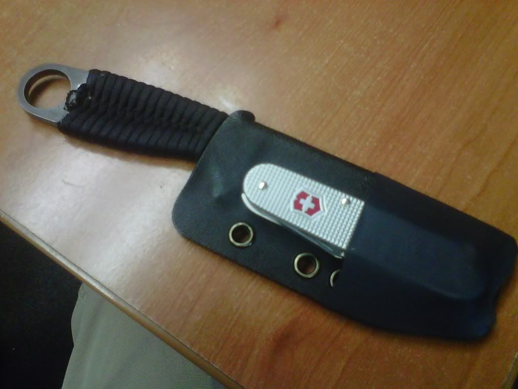

I've wanted to do this for a while now, but just got my hands on some large electrical wire heat-shrink tubing. The SAK is a SwissBianco micro-farmer that I am never without, these two make a wicked pair!

Does the shrink wrap maintain it's for or do you have to slide the SAK into and out of it like a ranger band?
If you shrink it with the SAK in place it forms a tight pocket. I wish it were a little easier to slide in and out though.
Super idea. I use the pouch on my larger Beckers to hold a multi-tool or a SAK, but I have been looking for a way to do it on the 11.
Very slick.
Just a thought - wrap a couple passes of masking tape around the farmer before shrinking the tube. Remove the tape, and you should have just a touch of clearance around the SAK.
Works on kydex sheaths.
