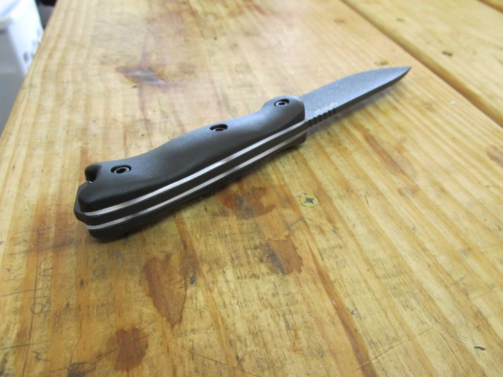

I did not see anyone here that is making G10 liners for the tweeners. I have always wanted to take a stab at this and decided to after 1. no response on the forum 2. I was inspired by receiveing my CABS from the custom shop 3. I was waiting on the tweeners as they are MODABLE so here goes.

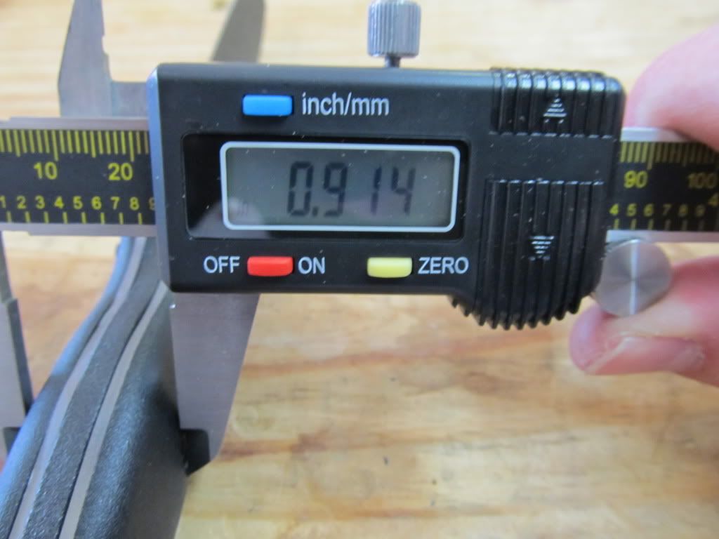

This is my first attempt at a MOD or liners on a handle, so no need to be gentle. I need advice on how to clean these up. I chose acrylic plexiglass from Lowes as it is the correct thickness (2mm), inexpensive and a similar consistency as micarata or G10. I know this is not a great material, however, for first shot it affords me the opportunity to screw up a few times. I now plan on obtaining some G10 to do this correctly.
Hope this gets me a BKH #.
The total cost of the MOD is below.
$2.13 Acrylic
$1.37 8/32 x 3/4 bolts
$3.50 Total materials
Started with a naked knife and raw material
Taped plexiglass to avoid splintering and sharp edges then traced slabs
Cut the plexiglass with a hacksaw. Make sure you clamp it down and use a spacer board on the side of your work work bench or you will damage your bench top. Not the first time I have cut or burned through to the bench. This took 15 mins.
Changed cameras mid stream as it looks like my old Nikon is dying.
After cutting the rough form it was off to the bench grinder. To have the slabs roughed out took 45 mins.
After the rough form I went to the works-sharp belt sander 60 grit. This took 30 mins
Now that they are 95%. I am not happy with the cutout area in the rear. This is where I need some experience for sure.
Drilling the correct 3/16 holes
I needed to replace the bolts and grind them down as the 8/32 x3/4 are to long
Before and After
Finished Product
That clear actually looks killer with the black handles and black blade! I never would have thought about using clear...but it sure looks good!
Liners are a PITA...and deceptively harder to make then one who has never attempted it would think LOL
I would suggest a Dremel with sanding drum for the final work....hi-speed and low-drag ;)

If you have a drill press get a pack of the little sanding drums from sears or wherever. I use them all the time for tight spots that a belt sander can't get into. Though you will probably need a file and sandpaper to get in the corners. Good handle making takes mad skillz and patience.

The sheath fits but the retention straps do not snap with the liners. They barely snap at all without them. This is why I am looking at a custom for the BK16 and my Busse CABS.
The orange handled knife is a Busse CABSLE that I bought at least 2nd hand here on the forum. I just got it back from the custom shop for a handle upgrade. The original slabs have a nice design they are just to small for my arthritic hands. The BK16 suffered from the same issue, great design, just to skinny to be comfortable for long term use such as cleaning a deer. Thus the need for liners.
I never though of using the dremel, that is on the list. I was using a dowel wrapped in sand paper for the final sand on the cut out portion.
Skystorm, no drill press. Sold it years ago, I can't cut a straight line with a saw so I did not see the need to have perfectly straight holes with material that was cut askew.:)
Next up finding some G10 or Micarta. Which one is easier to work with?
I would NEVER had selected plexiglass (acrylic is a little brittle and hard to work) - but those look awesome!
I did mine in Kydex, using a dremel - drill for holes, grinding bit to expand holes, cutoff wheel to cut, and sanding drum to shape. I think both took me about 30-45 minutes.
I was surprised how well the back cutout came out, since the sanding drum looks kinda large for those tight areas.
I used .060 (1.5mm) - also thinned out the index finger groove ahead of the palm swell - it's about as snug as stock, but I can snap the bottom strap. (I modded the sheath and removed the top, so didn't try it.)
Anyway, great first attempt, and I'm really impressed you got the plexiglass to work.
