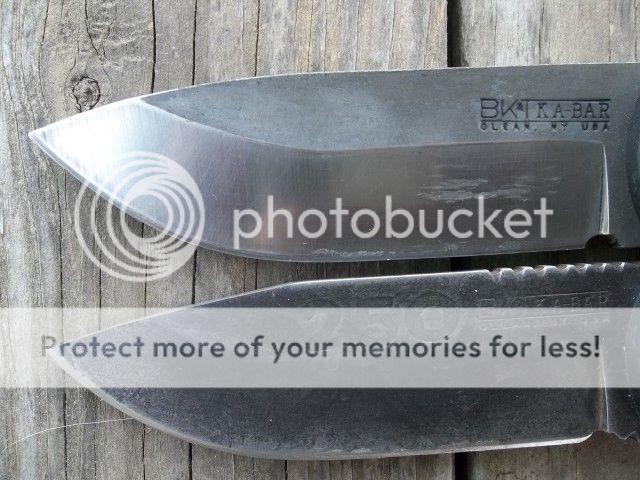

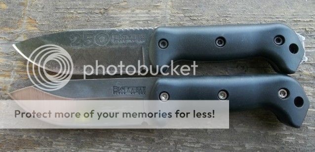

AND...a couple of weeks ago, I picked up a Camillus Campanion off of the exchange for what I thought was a super deal....
The downside? The previous owner had started to "mod" the blade. It still had the coating on it, but was ground at least 3/8" back from the edge...in a most uneven manner. It was bad.
No big deal...I new this when I bought it.
WHY did I buy it...cause I like grinding out sick blades...thats why!
Well, forgive the lighting in these..its 10pm here..and I just got back from my shop.
The pics don't do it justice. I can't wait to go out and use this one.
I took it back flat until about 3/8" from the spine, and then eased into a light convex...then hand polished it smooth. can you say SLICER!
I bought some Saints Armory black G10 for it, and ground that to fit...overall, very nice little slugger.
I will carry it in a leather pouch sheath I made for BK2's...until I get some kydex made up for it that is....

Very nice...changed that 2 a LOT! I kinda like it, lil ''meaner'' looking then a stock one for sure.
What's the weight difference now? and balance?
Great job man, your new 2 looks great.
And I'm interested as well, is it functionally much different than the stock one?

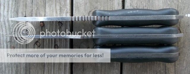

The balance on the Camillus Campanions is great to begin with, by my kitchen scale, its 1.1 OZ lighter than a stock GEN1 kabar BK2. So its not a BIG difference, but its slightly lighter to my hands anyway.
Having almost taken it back to full flat, its a better slicer, but I have to get out and do some side by side comparisons. I did 1 quick snap cut last night, and it took off a good sized chunk of framing lumber.
I am a big fan of clip points...basically, it looks like a polished BK7 short to me.
I've been Jonesing for a clip-pointed 2 every since I saw Warrior's custom 2. I really need to find a bladesmith who could clip mine for me. Yours looks great, GNK.

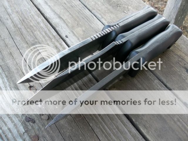

I finally got a chance to go out and do some tests..and take a few pics.
Honestly,
I did some crazy destruction stuff with the knife the other night...and ....I damaged the knife.
the edge , which I thinned down a bit, was rolled and chipped. Basically, nothing major, but the thinner edge can't take the serious ass whooping that the stock BK2 can take.
I kinda figured that this was the case...but nothing proves theory like testing.
Well, what I did the other night was...cut a couch in half.
YUP...a whole couch.
metal staples and nails all chip an edge...I don't care what kind of knife you have.
The oak and plywood frame to the couch presented little issues...the cover and padding was fun to cut. Basically, it was like skinning a deer at times...lots of pulling and slicing. Overall. The couch went in two, and then in a dumpster.
NOW, for today. I took the modified Camillus and a stock gen2 Kabar BK2 out to the oak pile and made some chips fly.
My knife cuts deeper and whittles easier.
It drilled a fire board very well.
I would hesitate to do any heavy prying on the tip of my thinner knife though.,,,unlike the stock BK2, which is a monster at basically everything.
Battoning was not an issue at all. Still splits wood like a Campanion.
Overall.
I still love the stock BK2, but my modified BK2 is going to get a permanent handle job and just live out its days as a fantastic camp knife...I love it.

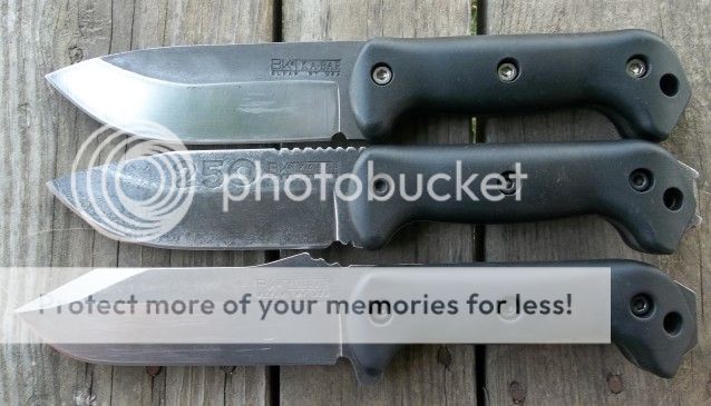

I modded my ol' BK2 today, not quite as long a clip as yours but I clipped it a little....I like it, kinda subtle but it makes a difference on the pointy end. :D
I took a couch apart with my first 14 back a few months ago. just to see if I could.

I am going to go this route again on a stock Kabar gen2 BK2 soon, without the flat grind. I am just going to clip it and convex it. Just to see if I notice much difference with the added 2 oz. of weight.
I took some pics today, not sure I am ''finished'' with it but I will post the pics here in a couple days.
