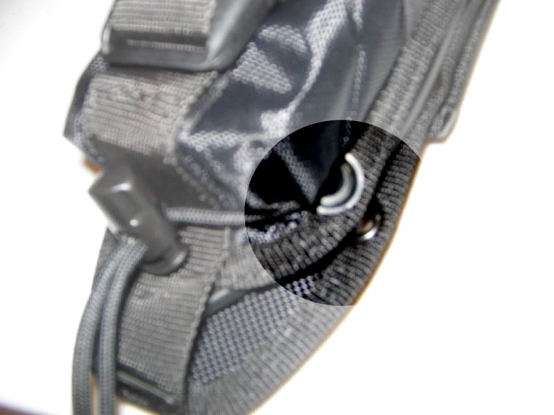

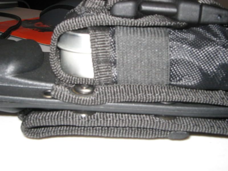

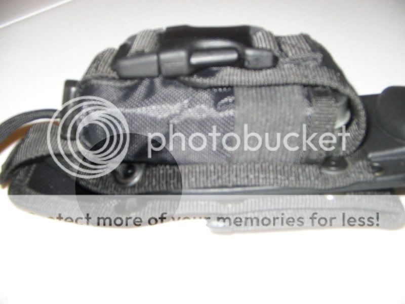

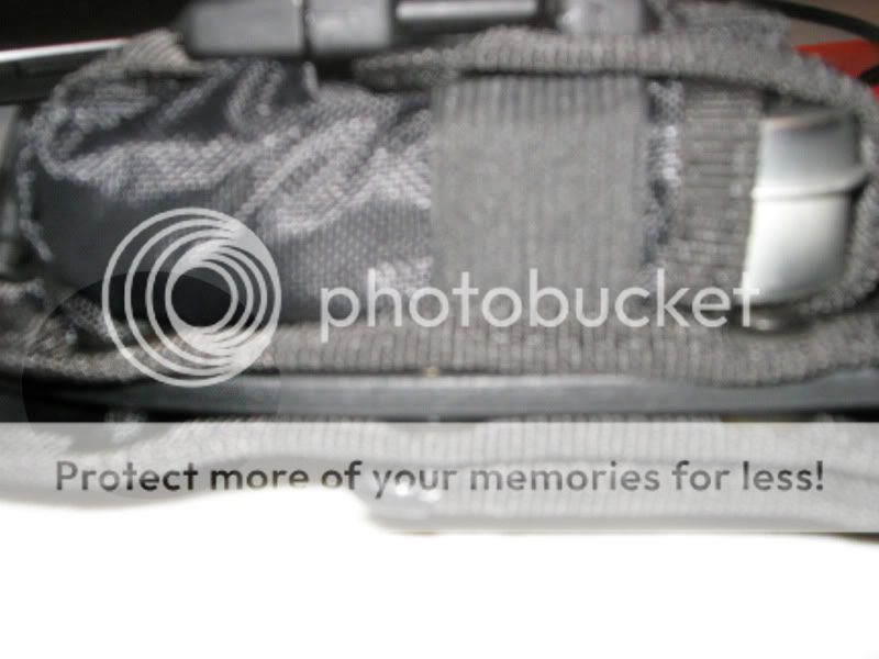

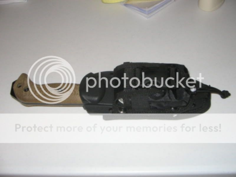

So, I will expound, with photographic evidence!
The 2nd Gen BK2 sheath has a total of 10 holes for screws; 6 occur before the taper towards the business end of the blade. The pair closest to the handle of the knife, when sheathed, are not used for anything with the ESEE accessories. The next two pair, the last four holes before the sheath tapers, are used for either
A) All four extended screws included with the molle back or
B) The upper two holes are used with the pouch AND molle back, while the lower two are connecting only the back and the sheath.
Now, if option B is chosen (meaning, you have the back and pouch in play), then the problem arises for the bottom two screw holes on the SHEATH. The taper causes the screw holes of the sheath to be off by about 0.25" on the sharp side, and about 0.125" on the spine side.
Here are the pics, sorry for the lack of focus, this camera is from 2002, which means I can't get too close without the flash destroying all clarity. As you can HOPEFULLY tell, I simply lashed the pouch down on the south side of the sheath using paracord and one of those plastic retention adjustment thingies (that's the technical term). Personally, I like the paracord on the bottom, it saved me from having to send the pouch back and go hunting for a replacement...
Also, note that I removed the upper half of the molle back, due to a lack of webbing on the shoulder strap of the pack I use to carry this on.
I hope this alleviates some confusion.
*** Also, it can clearly be seen in the last two pics that the back and pouch only share two screws, not all four. The pouch uses the top two and the bottom two pre-taper screwholes, whereas the back uses the top and middle two. This is due to the shape of the Becker sheath; I am sure that the ESEE 5 sheath lines up with all six screws, allowing the user to connect at either point, or buy more screws and connect at all points.
You're most welcome... And I wouldn't exactly call them "incompatible", it just takes a little creativity to get what you want, as with most mods. I fully recommend the ESEE accessories, just buy some paracord and use your brain, that's what separates us from the monkeys!
