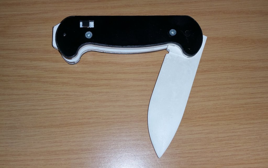

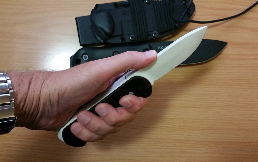

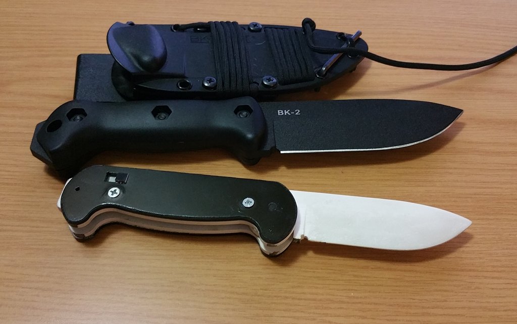

This is a BK2 inspired folding knife prototype I made from wood while waiting for the real thing ; )
The action works and it locks in place with a satisfying click - even on this wooden model.
Some additional pics:
Compared to the BK2 I would have liked a longer blade proportional to the handle, but with folding knives this cant be done...

I wanted to make a steel version but according to the local knife makers its too difficult for a novice like me..... That's why its still at the mockup stage.
If I had a workshop with cnc machines and stuff, I would probably go for stainless steel liners and hard anodized aluminium.
Sadly I highly doubt it

If you were to move the pivot a touch further forward and use a pillar construction along the spine, given thick enough liners, you could gain some blade length since the scales would be flush mounted to the liners.
Not only that, but you might be able to use the columns as a track for your lock bar, this would keep it a flow through design and aid in cleaning. It looks like it is mounted towards the rear of the palm, and pulls back to unlock and is spring loaded to keep pressure forward, akin to a Spyderco CBB lock or the cold steel where you pull the butt of the handle to release it.
It seems to be a nice design, but if you were to implement a lock pin to keep pressure exerted on the blade from pushing back on the spring, it might be a bit more secure.

I really like the look and am glad you shared it. However, I am a little puzzled by the concept. I am from the school of thought that you don't ask a folder to do a fixed blades job and you don't ask a fixed blade to do a folders job. Making a folder with 1/4 inch blade stock is overkill in my book. It is probably overkill in a fixed blade too, or at least it is for me. I love the Becker handle so maybe a 3/16 version would appeal to me more. If you were to make one with 1/4 stock then my vote would be for very, very thick liners and a sturdy pivot. Maybe a 1/4" grade8 pivot? :D I would try to keep it as bomb proof as possible as that is the idea behind the BK2. Again, the proto looks great and thanks for sharing.
