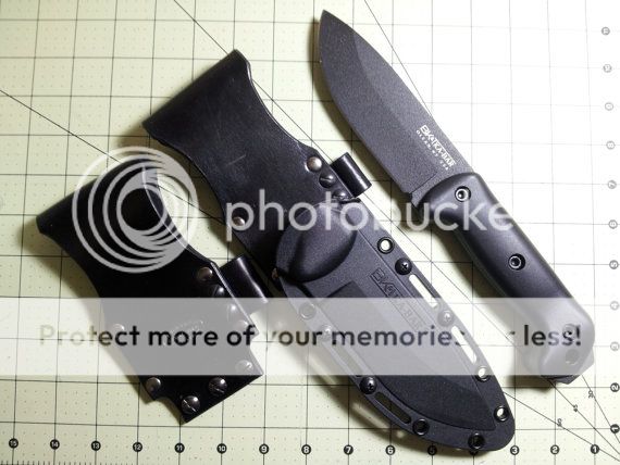

I see many people using bike tire tubes for grips on the BK2 handle. I think this is a brilliant idea! Can anyone offer me some information on what size to get? Forgive me if this is a silly question..
If you get a tube for a mountain bike, you should be fine. Most bike shops have old ones they'll give you.
When stretching the tube onto the handle, KEEP THE KNIFE IN THE SHEATH.
Thanks! Would you also recommend filing the inside of the "blade side" of the sheath? I hear that it blunts the blade... But maybe it does't. I've never sharpened a knife before so I'd like to hold off until I can get one of those fancy spyderco sharpening do-dads.
[/URL][/IMG] I would use a 1.75 inner tube (rangerband) on a bk2. But wash the 6 inch piece out first. The bk2 is a thick little beast. And pop out the rivet highest on the spine side of the sheath. Don't worry your knife won't go anywhere with it missing. unless you don't have the fibreglass sheath.
Thanks, never thought of simply removing the rivet! Certainly sounds easier than sanding the inside!
the rivet thing certainly helps w/drawing and some dulling. Plus use a snapped hack saw blade on the inside where the blade rest. And keep us posted on your progress.
Thanks again. I will certainly keep you posted.. just as soon as I track down the supplies.

going through old post and ran by a thread on pg 30. Just received BK2.....and..... Do an advanced search enter title, click by post & hit search. I see that Derek made the same rivet suggestion but I used a pair of needle nose instead.
