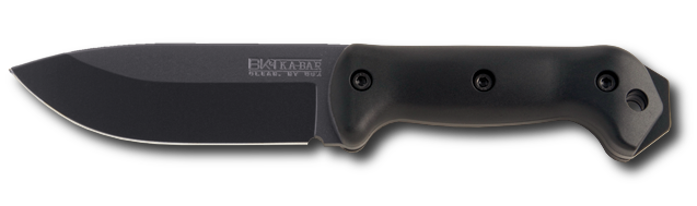

Stock BK2:

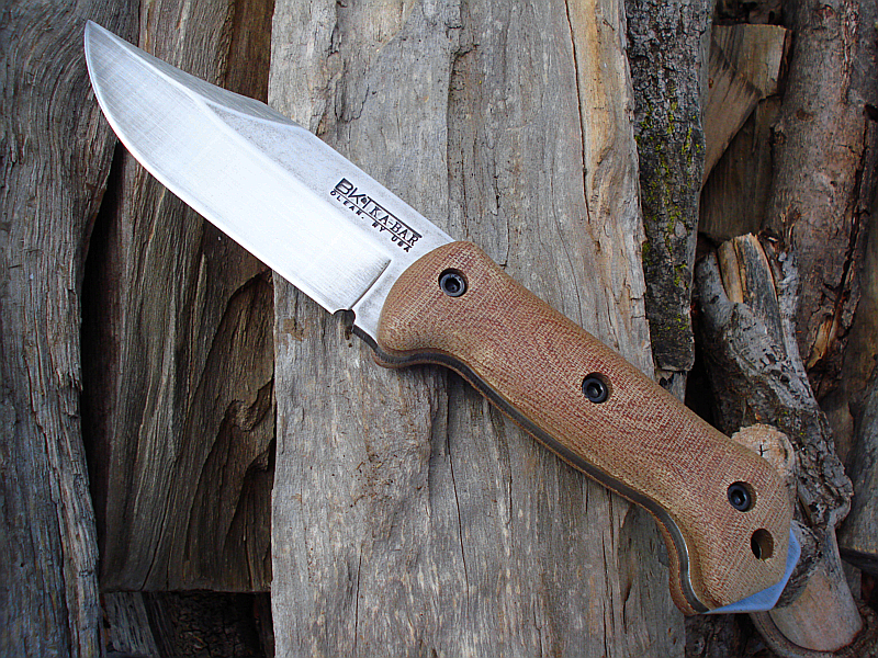

Here's a few photos I took before bluing, with micarta. The last photo shows a good shot of the top of the clip:
