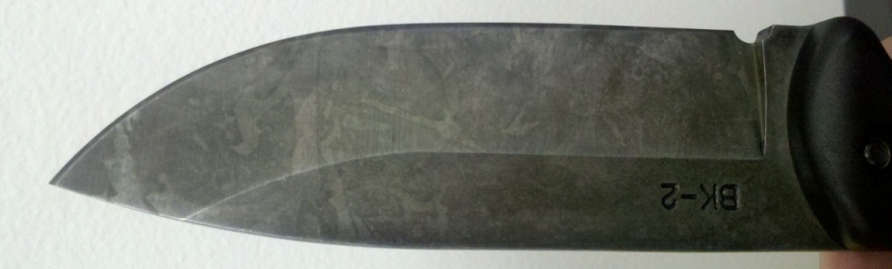

Got my BK2 monday
Lowbuck sheath mod wednesday
Stripped it yesterday
Patina'd today
did a white vinagar soak for an hour or 2, and then went to do some mustard stripes, but, out of mustard... :mad:
didnt have any oranges or grapefruit around, but did have some 10% glycolic acid (used for facial peels).
what the heck, gave it a try...
wrapped in a paper towel and sprayed it down with the glycolic, and let it sit for about 1/2 hour
came out pretty nice, but as usual, pics cant really pick up the contrast in color :D
Edit: this turned out to be too thin of a patina, came off way too easy, not long enough in the vinegar, or the glycolic undid the vinegar patina, either way.... crap.
will be re-doing

thanks for the comments guys, will have to see how this wears.
it seems like the glycolic was removing the vinegar patina, a couple draws from the sheath has started to remove the finish
*DONT BOTHER TRYING THIS FINISH until i use it a bit*
i was thinking acid is acid, and just gave it a try, but a little reading on the web shows this stuff is used to remove deposits in boilers and such
great metal cleaner, but we'll see
worst thing that could happen is i start over......
