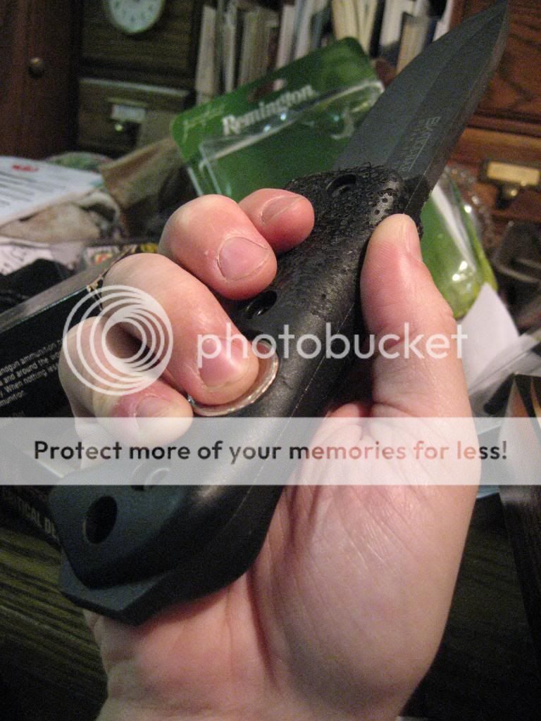

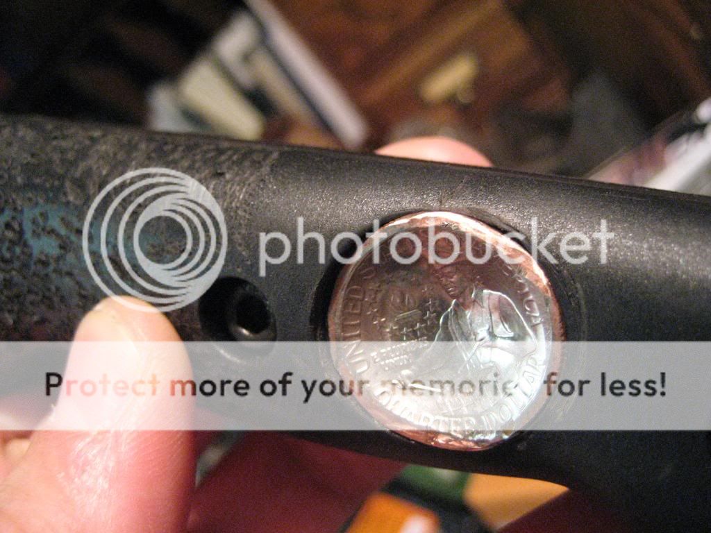

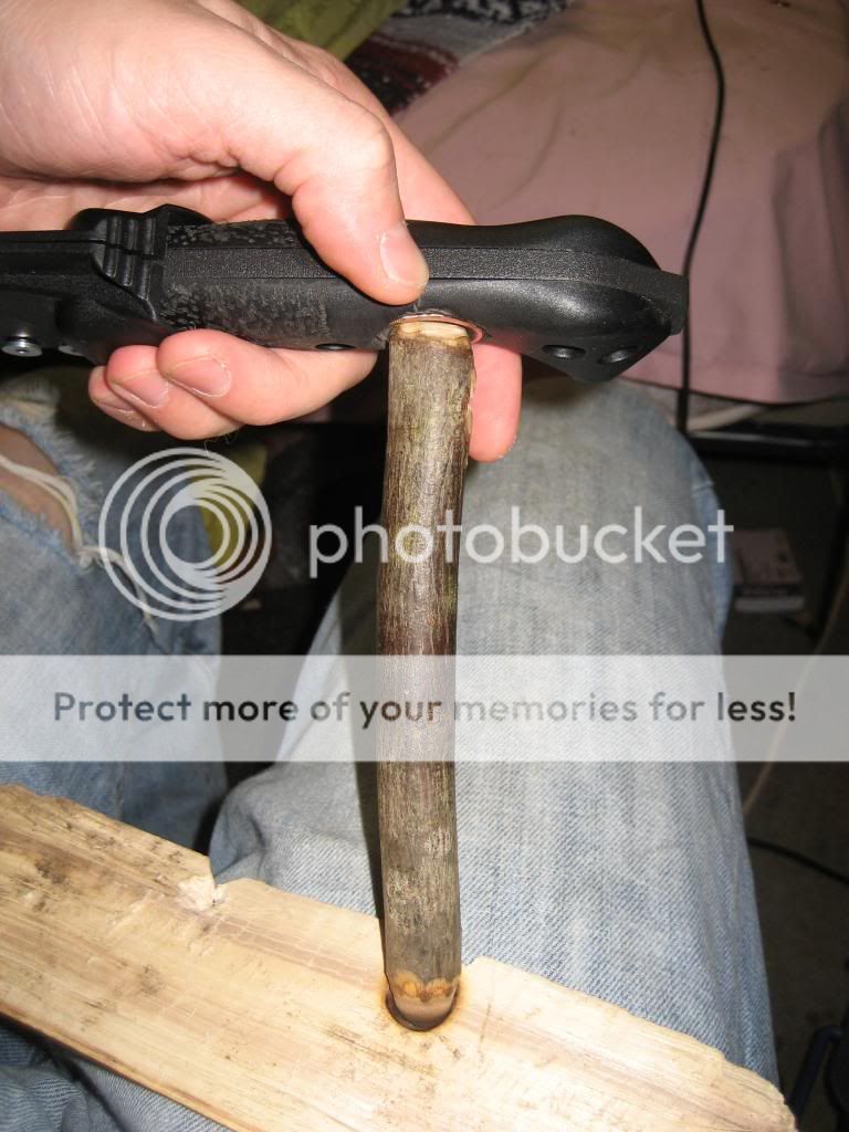

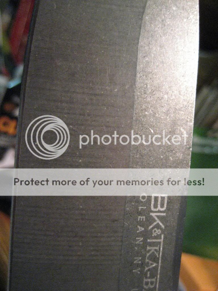

So the quest to modify the old BK2 continues. I'm enjoying my very simple stippling and getting a good bit of use out of it splitting wood shingles and carving spindles to work on my first real bushcrafting project, the firedrill. Thus far my only successful embers have been formed with the almost frictionless inside of a tea candle holder, and I'm not having luck finding natural materials smooth enough to hold down my drill while I work the bow. Somebody on youtube inserted a dime into their knife handle, so I figured why not a quarter. After an afternoon of bending, shaping, reshaping, drilling, cussing, jb welding, I have what is now a very functional piece to hold down my firedrill spindle and it'll never leave my side if I'm in the process of making fire in this manner. While I was at it I found some stripper in grandpa's shop and went ahead and took off that rough black coating. I mean, I'm sure if I take off into the woods with only a blade when society ends oil will be abundant :P Either way, it looks cool. What is funny, and I'm sure everyone has already noticed it when stripping them, it seems to have a secondary coating of some sort, a weird checkered texturing on the blade that looks almost like galvinization, though I don't think thats what it is. What is this coating and does it do anything to slow rust? If not I'm going to take some flitz to her and make it shine like a mirror.
its actually quite comfortable to rest my finger inside the concave quarter.

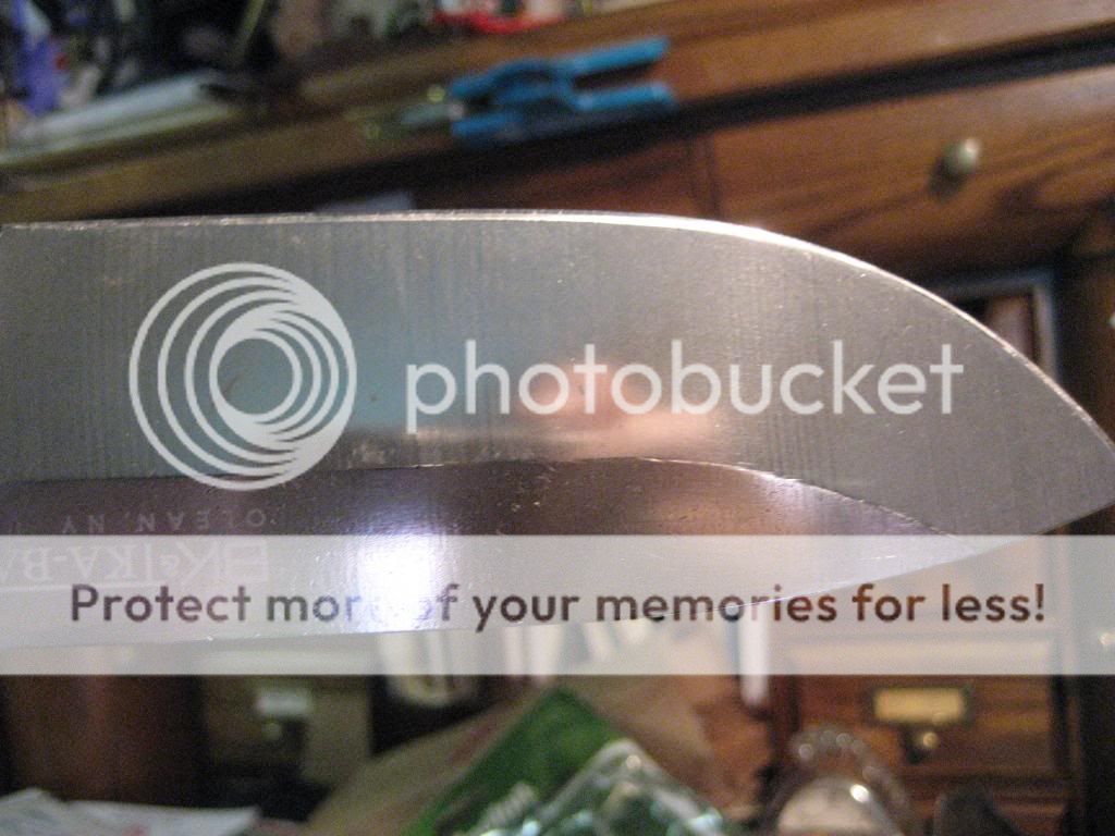

And now finally, whats up with this inner blade coating I mentioned? Do I leave it on as a rust preventative, or do I flitz the hell out of her and make it mirror shine?

Damn fine work! I never would have thought of using a quarter like that. As for the coating, I'd leave it but it.

I think yhat you see as a blade coating is just the stone washed finish on the raw steel. I would leave it as is. Please update us on how your divet is working?

Out of an idle mind and the need to be stationary by the lady spending quality time for V day I took some flitz to one side of the blade already. Aesthetically its more pleasing, not sure how it'll affect my eventual forced patina.

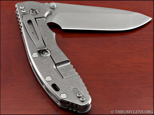

That finish under the coating is called a "tumbled finish" I believe. It involves running the steel in a vibrating tumbler with ceramic media that polishes and smooths the surface.
EDIT: Just seen LG&M's post. I think stone washed is more of the actual term.
Similar to this Hinderer XM24

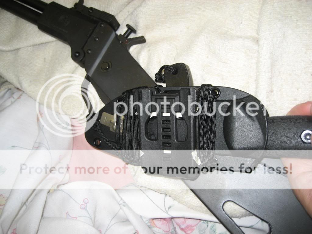

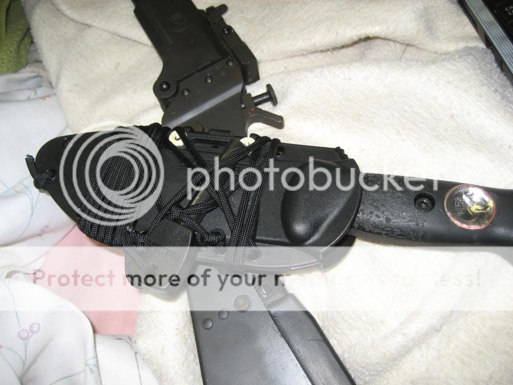

Along with ample paracord to make a bowdrill or two, a swedish firesteel, and a teclock that didn't quite fit but holds tight nonetheless.

Well, I ran into some SERIOUS frustration with my noob bushcrafting today. paracord and natural sticks seem to give more trouble than nylon rope and dowels :P It seems that the force of splitting a 9" cedar log was enough to dislodge my bicentennial beauty, but for the sake of testing I superglued it back in over the JB weld. Perhaps my spindle wasn't narrow enough, or the cedar not dry enough, but it KEPT jumping out of my recessed quarter. Glad I'm ordering micarta handles sometime next month anyway. As soon as smoke started to happen and the friction really caught on, POW, the stick flew off my paracord laced bow.
