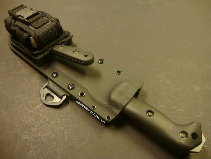

I need advice on how to Piggyback/attach my Green River hunter to my BK2 sheath. On my BK2 sheath, I removed the stock strap, added a tek lok, and have added the esee maxpedition pouch to the front. I'm open to changes in order to get this to work. My Green River Blade is 5", with a 9" overall length. Forged from .112" thick carbon cutlery steel. I currently do not have a sheath for it. Is the knife to long to piggyback/connect it to my BK sheath and if so does anyone have any suggestions for how to get it done? Should I make a kydex sheath for it, another type of sheath, etc.... Any ideas would be great!!

Assuming you have a stock BK2 sheath, which is what it sounds like, I would go about it by making a kydex sheath and using some spacers with slanted/angled tops and long (1 1/2" - 2" maybe) screws and attach it the same way some of the kydex benders here do with smaller knives.
On the other hand, that's 2 decent sized knives attached to each other, you may want to wear your belt a little tighter when you carry them both.
If you are not opposed to buying something, I know that Godspeed Tactical can help you out. He does great work and has probably the most extensive library of pics of piggybacking that I have seen.

I was looking at this yesterday and wasn't sure how to put my thoughts down so here it goes. If you're sticking with a pouch mounted up front you need to mount your homemade Kydex on the rear and at an angle... the main thing that throws me off is the size of the secondary blade I think it's basically the same size as the BK2???
However if you are willing to go custom Jim steered you in the right direction.;)
I just finished a BK9/Mora Clipper combo that I was concerned might be too big for the setup but my customer (Beckerhead?) was onto something really good with this setup. No pouch on this one just a low profile piggyback setup but an example of how you could make your backside/piggyback bigger than normal then just trim off the excess.

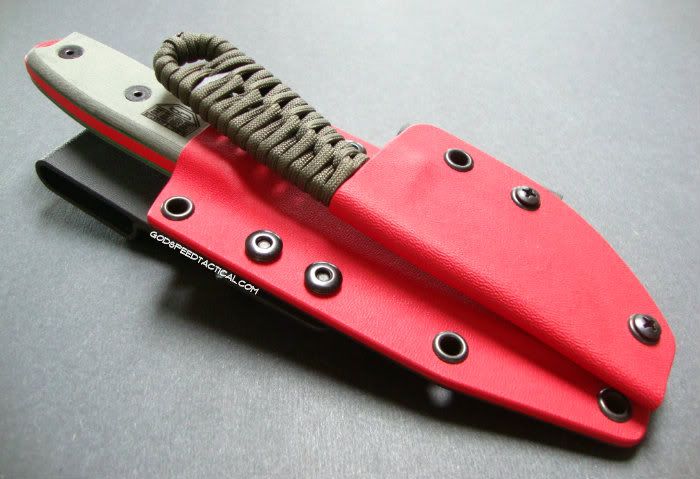

Red ESEE-4 w/Izula piggyback: smaller example but similar blade sizes (by scale)

Now to the pouches, this is my specialty and how I started my Kydex "career"... mounting pouches to smaller knives and especially piggybacking them.
BK7/Remora/Pouch Combo:
BK9/BK14/Pouch Combo w/Baldric Sling Adapter: (Ninja Style & Chuck Norris Approved)
