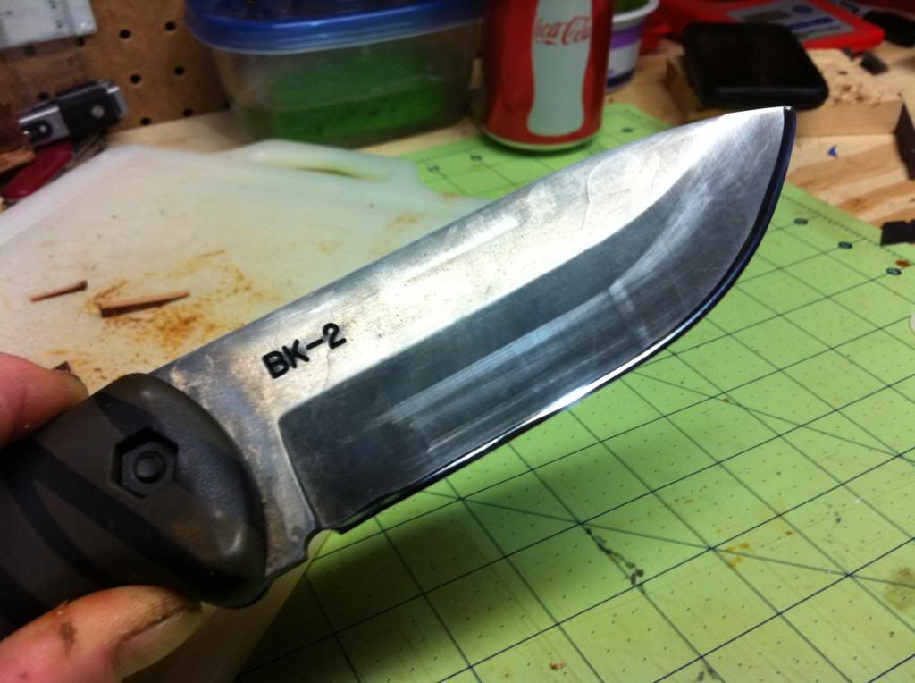

This thread needs a pic
My 2, with a 20\20 degree convex compliments of the WorkSharp
