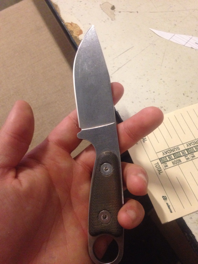

Ok so I'm really not sure if this is a issue where my expectations are unrealistic, or something else. I've had my bk24 (d2) for a while, haven't used it much. I used it this past weekend in the stock plastic sheath and I noticed it would go from a perfect shaving sharp edge to having noticeable rolls/dull spots on the edge within an hour or so. Almost no use apart from light cutting tasks and sheathing/re sheathing it. It didn't have a bur or wire edge, it had a clean apex to begin with. I've read about some issues with the sheath dulling the edge.
Does this sound like a sheath issue or do I need to adjust my expectations? I dont have any previous experience with d2, but I thought it had better edge retention than 1095? I cleaned and processed 12 fish with my bk15 and it still shaved afterwards. It seems to me that my bk24 isn't holding an edge at ALL.
I'm trying it in a leather sheath this week to see if my issue goes away.
Thoughts?
