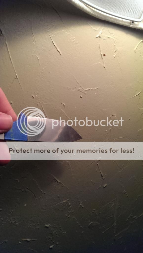

So i just got myself a BK24, and I'm trying to get it all nice and shiny. Does anybody have any recommendations on how to do this?
I've been sanding the grind lines off of the spine (all gone now) with 100 grit sandpaper, but the blade isn't coming along very well. Is there a technique to this? Do I need to sand in different directions, such as handle to tip, edge to spine, or at an angle? I thought i might have read that somewhere..
Also there is a spot on my blade that doesn't look right..
That isn't a heat treat mistake or line, is it? Will sanding it take it out?
Any tips or tricks on accomplishing my quest would be greatly appreciated :)

In regards to the line/spot you mentioned. I'm not sure what you are talking about. It may be because of the glare and reflections, but it isn't really standing out to me. Are you using a sanding block or just your hand?? If you have some lines or spots that don't look right, it may because of uneven sanding.

When I get on the big monitor and zoom in on the lower image, I see lots of crinkly scratches. If that's what you're talking about, then you've got a lot more sanding to do. Could be the blade and/or your sanding bar is not quite flat so the scatches are getting missed by the sandpaper. Issues discussed in the vids above.
BTW, you'll need to wipe that black slurry off often. If not, it will build-up under the paper and cut deep scratches that will probably force you to back up a grit level and start over. Been there, done that. By now, I can feel the paper loading up and immediately stop and wipe the blade and wash off the paper.

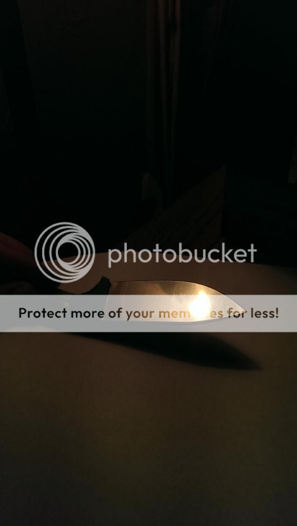

The pictures aren't quit picking up the spot. It was this way before the sanding and it's on both sides in the same spot.
Basically, if you turn the knife slightly, instead of seeing the reflection on one continuous piece across the blade, it splits where the line is.
Click the picture for the video
Blade is not flat.
Any distortion in the reflect image is an imperfection in the surface.
That line is probably the crest of a 'hill'. Most likely it's the point where the grind angle changed to taper to the tip.
