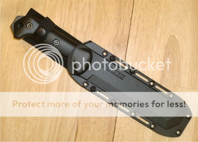

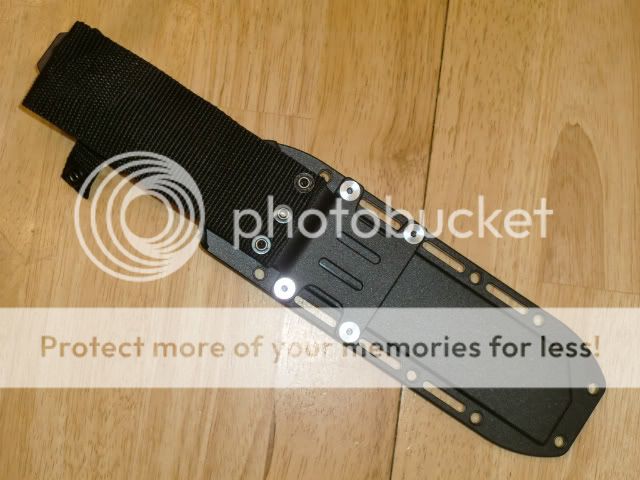

Here is the knife and sheath together

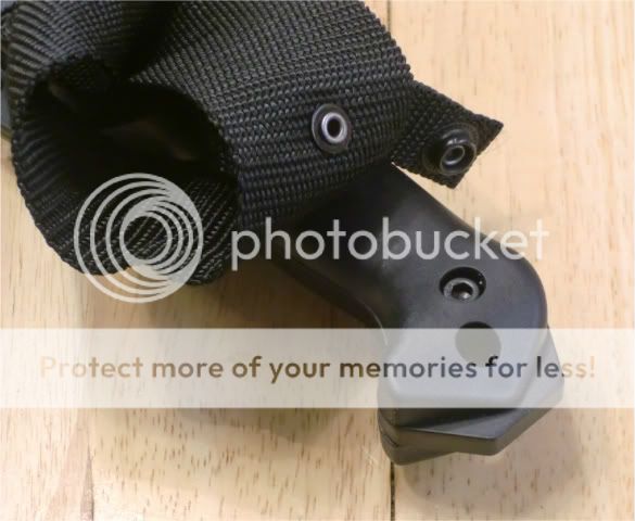

The sheath is some type of plastic, i dont believe its a kydex product. It has great retention and has mounting holes spaced user friendly. The belt loop and retention strap are a thin nylon. The retention strap is only secured by a single rivet, not very well.

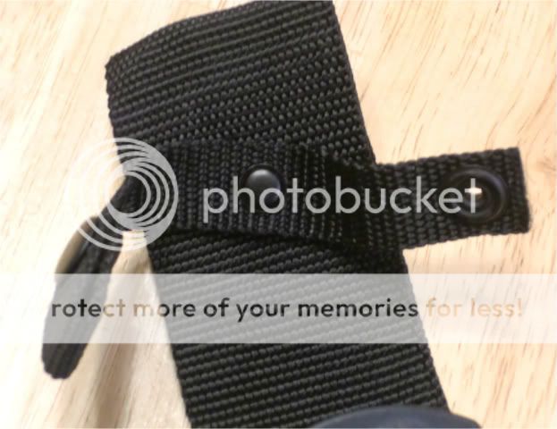

Close ups of the nylon retention strap and rivet

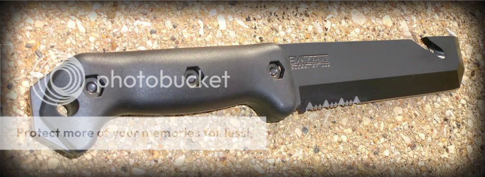

Ok here she is in in all her glory!!
Here you can see the blade and all her angles

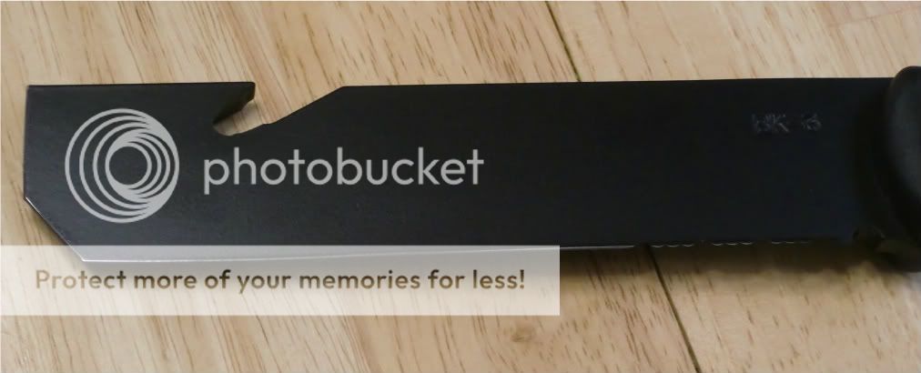

Now on the back side of the blade you can see the chisel or tool grind, ie flat on one side. I thought it would be rather dull, Im not a fan of this type of edge but the BK3 sliced paper and did cut a couple hairs, not like the factory edge on my BK5, but better than I expected.

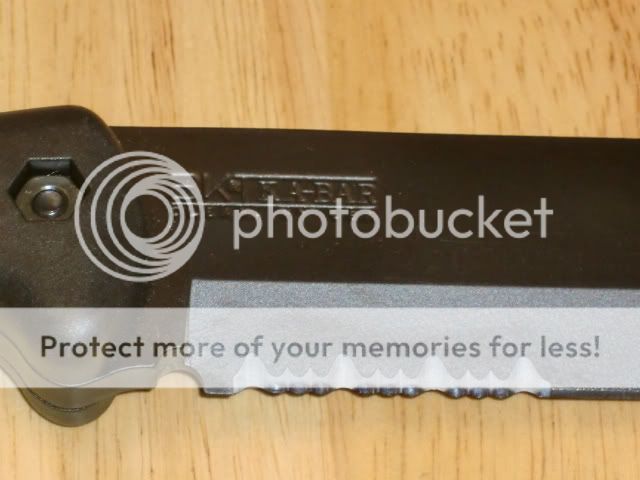

Here you can see a close up of the serrations, they appear to be very well designed and should cut fiberous material easily.

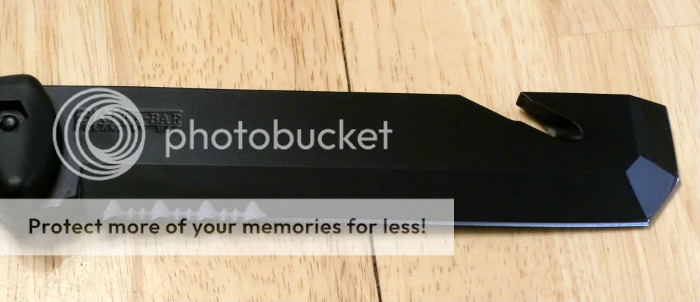

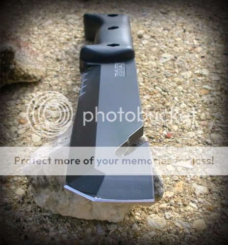

Here is a frontal view of the BK3, you can see the flat chisel/ pry tip very well.

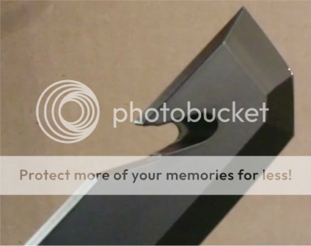

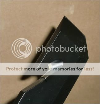

You can see the strap or cord cutter. There is alot of controversy regarding this, some say it weakens the tip strength. I dont know about that yet but it is very roughly finished. The edge is very dull and not fully ground. It will not cut paracord in its present condition.
Here is a closer view of the cutter tip. You can see how it is not flush but has a bump still, it does not look like it was finished. You can also see a slight roll in the tip that was not finished.
here is another view

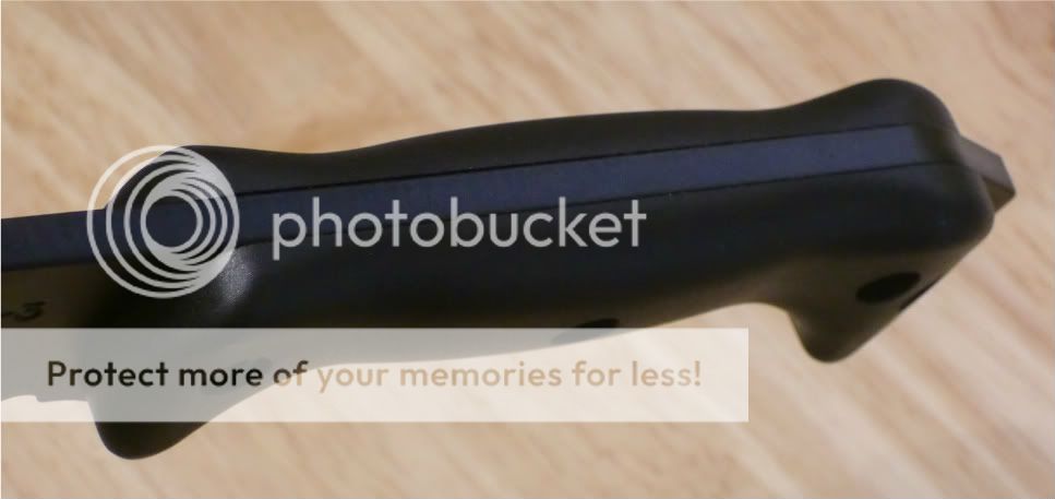

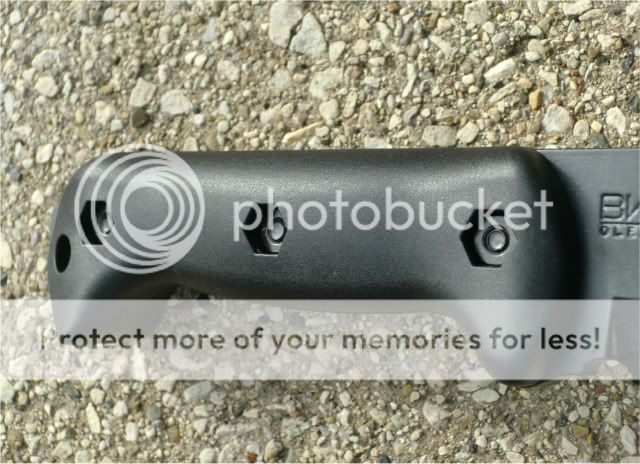

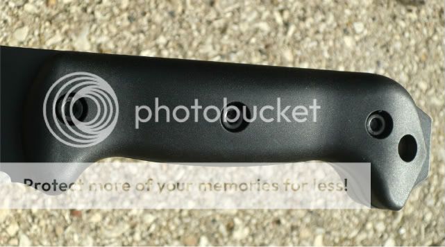

The handles are the standard size Grivory plastic composition. They are held on with three bolts. These are the same as on the BK2 and BK5, however on this tool they could be a little longer to facilitate use of heavy gloves, the type you would use for demolition type duties.
The handles are not aligned correctly and you can feel the ridges between the two handles and the full tang. I believe that by loosening the handles I should be able to align them correctly. I will let you know.

The nylon strap should be sewn on as well as the single rivet. It is already loose just from playing with it for the last two hours. You do not need it for positive retention though. The sheath sucks that blade in and you have to make an honest effort to retrieve it. The way I could see this being an issue is when you wear it on a belt it may swing more, I cant say for sure since I have not worn it yet.
