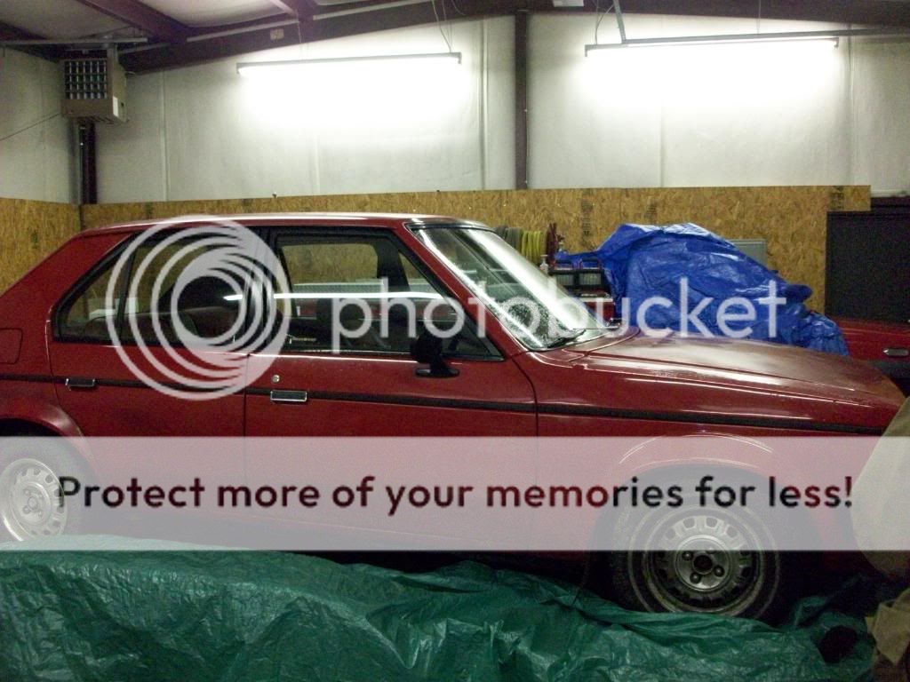

Late 70's model Dodge Omni. Not a Buick, but when it was made, steel was king, and even though its a small car, getting a person stuck inside it out, is not easy to do without tools. The hydraulic kind. Also, it was free, and available. It still had all the glass, everything was intact, the only reason why this pimped out Omni wasn't on the road, the engine was blown. Good for us.
Nothing special, but, hey, this car is older than most of the guys posting in here, and is MADE OF METAL. So, a good test for the Firemen, and the BK3.

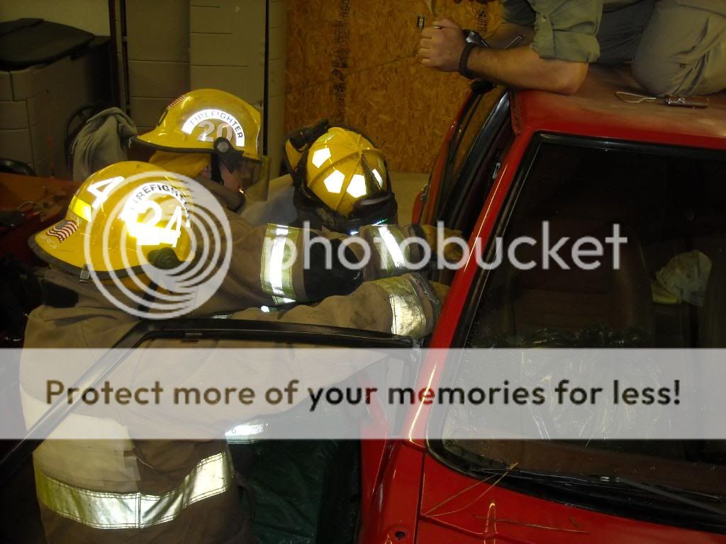

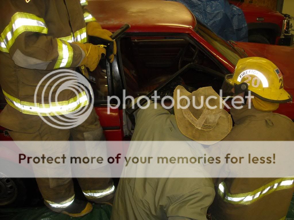

Ok, time to shine. Our objective was to use a BK3, to extricate someone that has been trapped in a car. The easiest way, through the windows and doors. First we smashed and cleaned the passenger side window. Window busted easy, and we had our first objective done, we are in the car

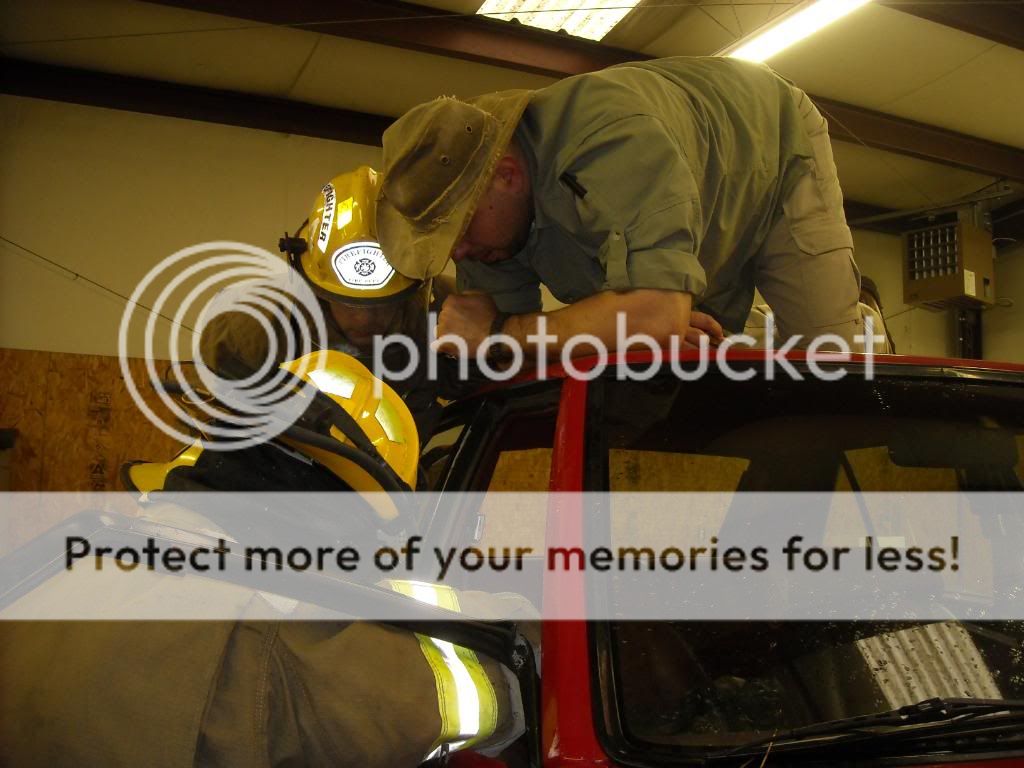

Then, we began prying on the door, as, you can't drag an injured person through a window, unless necessary. We started up high, using the chisel tipped BK3 to slip the door frame, and gain leverage to pull the door out.

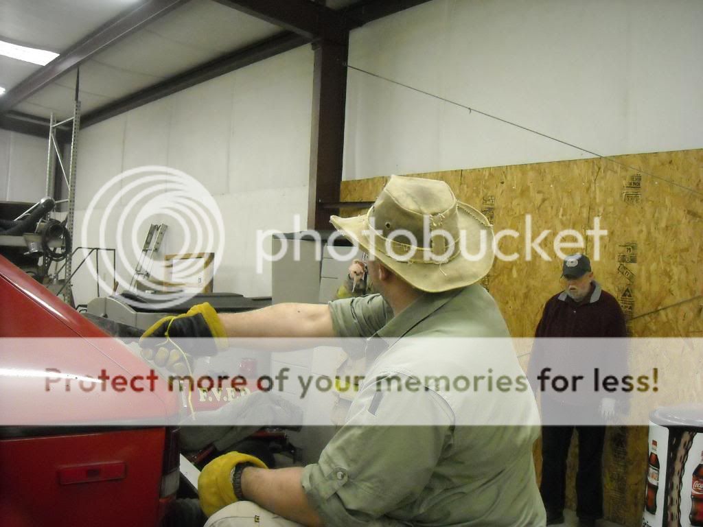

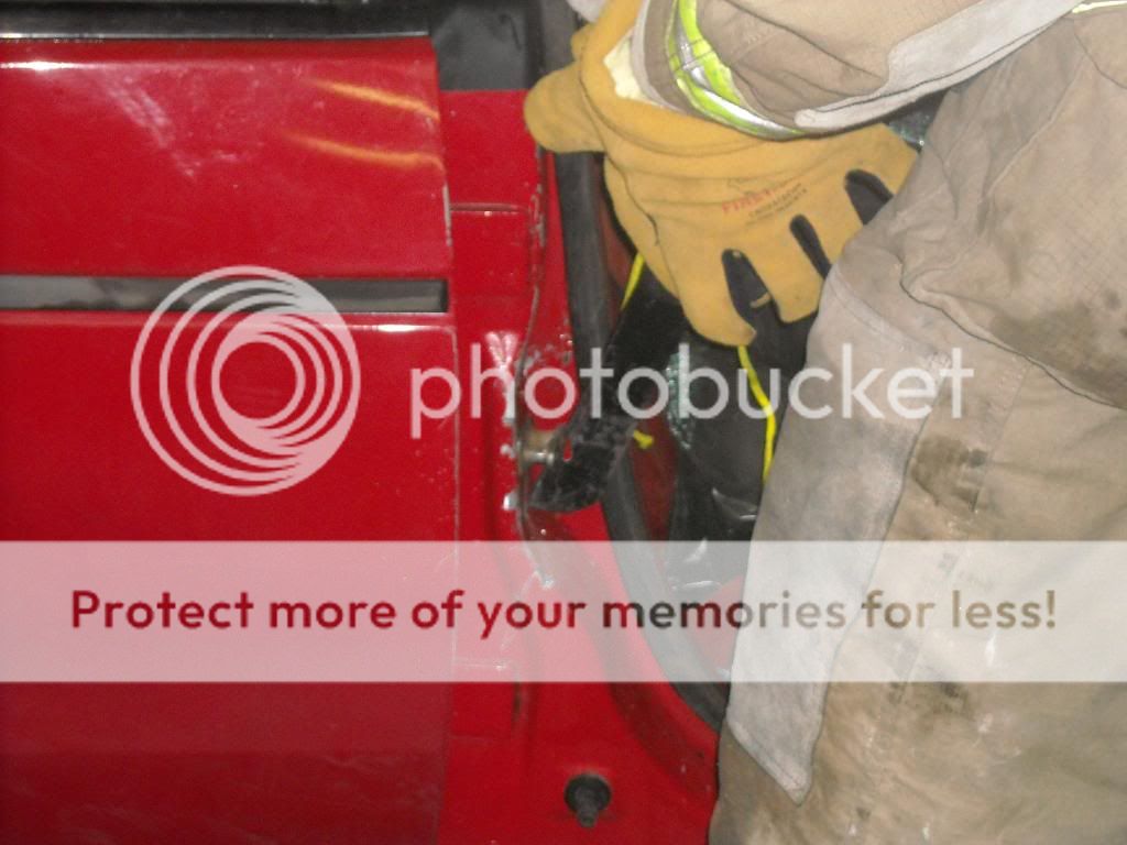

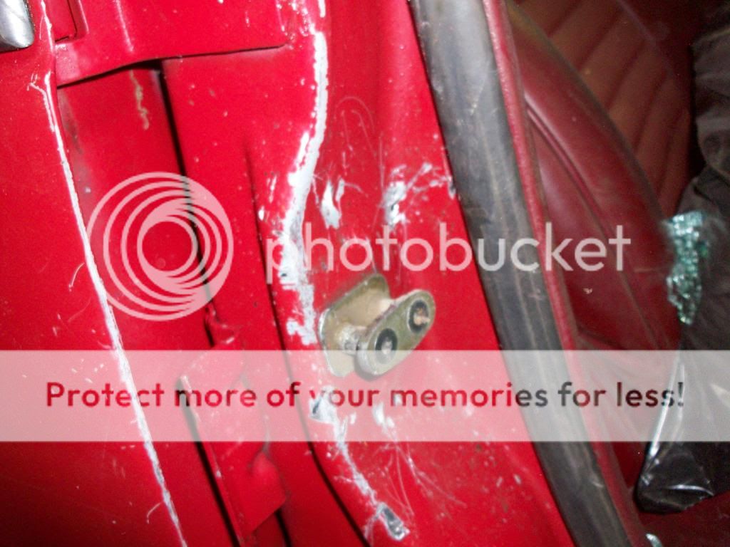

Job done. Now, since the top was pulled free, we could focus our efforts on the lower door, and the dreaded Nader pin. The nader pin, in a normal situation, is just cut with the Jaws of Life. Our simulation, was "first on the scene, and you have a BK3". So, no jaws of life in this scenario. Fireman S, one of my best friends, and I had been trying to figure away for the BK3 to beat the Nader pin. When we started, we still didn't have a solutions. Ta hell with it, sometimes you gotta dance in the shoes you wore, with the lady you brought to the dance.
Ok, first way around the Nader pin, was to just open the door up like a coke can, and reach in and activate the lock mechanism. Problem, the opening we had, wasn't big enough to fit a gloved hand in. Problem solved.
The door swung open, we were in. Trapped personnel could be extricated to a safe area, for the stabilization of the patient to begin.
We ain't done yet. Matter of fact, just getting warmed up.

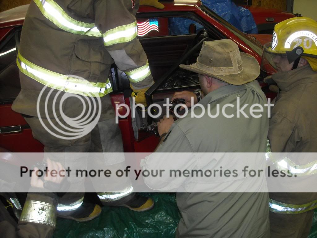

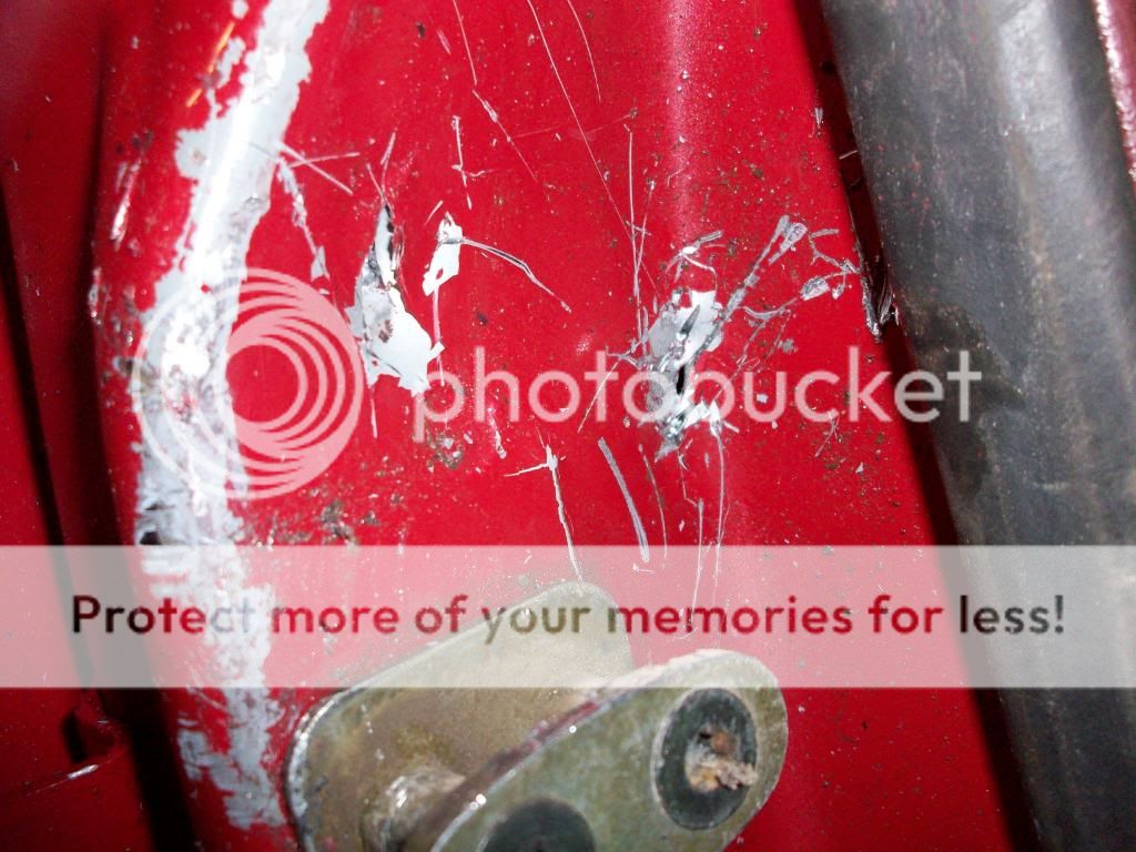

Next up, we wanted to defeat the Nader pin with the BK3. Time to pry.
Just a half a heart beat after this photo, the lock mechanism gave, and the Nader pin had been defeated. Fireman G, basically managed to get the lock bent in a manner, that he could just lift it off the Nader pin. Nader pin, defeated by the BK3. So far, busted glass, opened the door like a tin of beans, pryed the door open and off the Nader pin, and this is the shape its in.

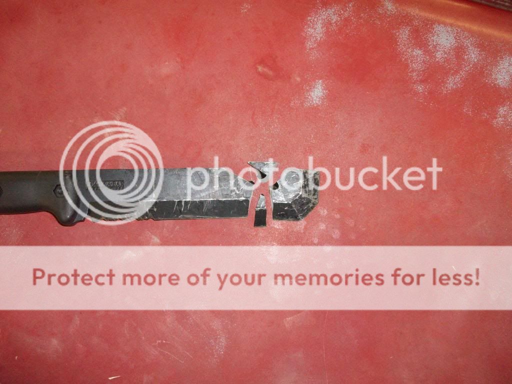

So, the Nader pin had been defeated, but like I said, we were testing the BK3 as well, so, we get in it, hardcore with the BK3. Taking the BK3 out of it designed purpose for the first time, we wanted to rip the damn Nader pin from the car, throw it on the ground and laff at it while it died twitching. That didn't happen, but it would have, maybe.
Fireman G, hooked the Nader pin, and put 215lbs of raw power down on the BK3. After 4 attempts, as the Nader pin was tearing loose, the BK3 broke. Yup, second one that I know of.
So, did we stop? Did we get another BK3? Hell no, we continued to kick this car's ass with what we had left, 5" of chisel ground, 1/4" stock.
Uncle E, checked out the break, and then we got back to it.

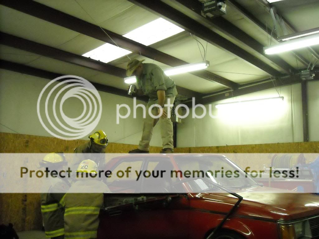

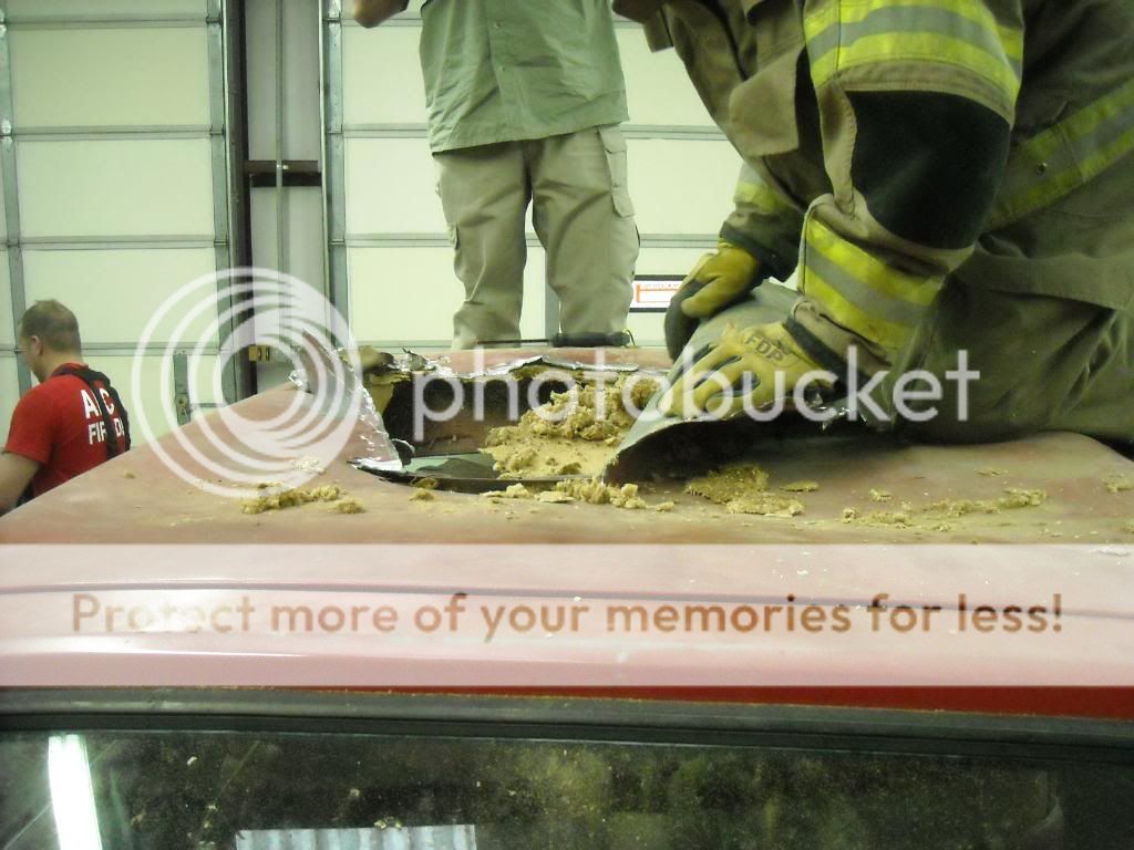

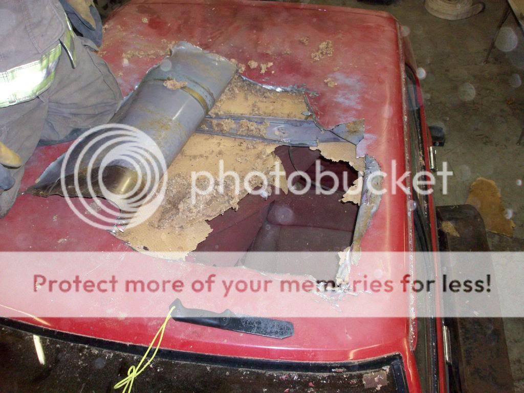

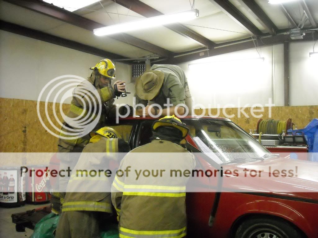

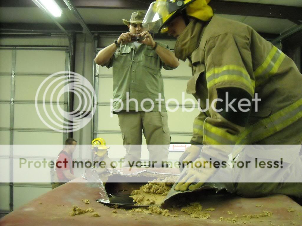

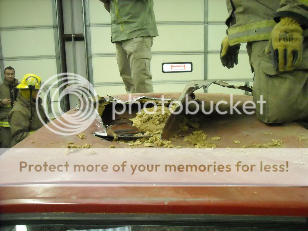

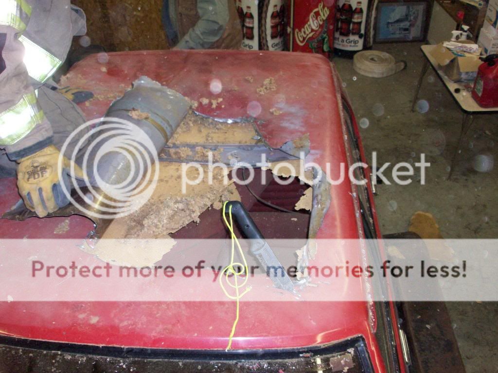

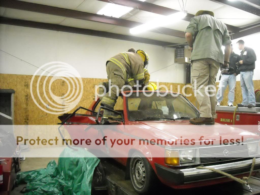

So, with what we had left, we needed to do a roof flap. So, Fireman G, and Fireman A, climbed up, and started hacking at the roof. With a broken BK3.
Now, at this point, I took over the vid camera from Fireman K, and so, pics get sketchy, for flow, I was trying to take pics, run the vid camera, yell and shout at the guys to "GET SOME!!". Don't worry, the vid is gonna blow ya mind. Didn't I?
Yup, we did all that with a BK3, and it was broken. Wait, want to see what else we don, after we broke the knife? 'Kay.

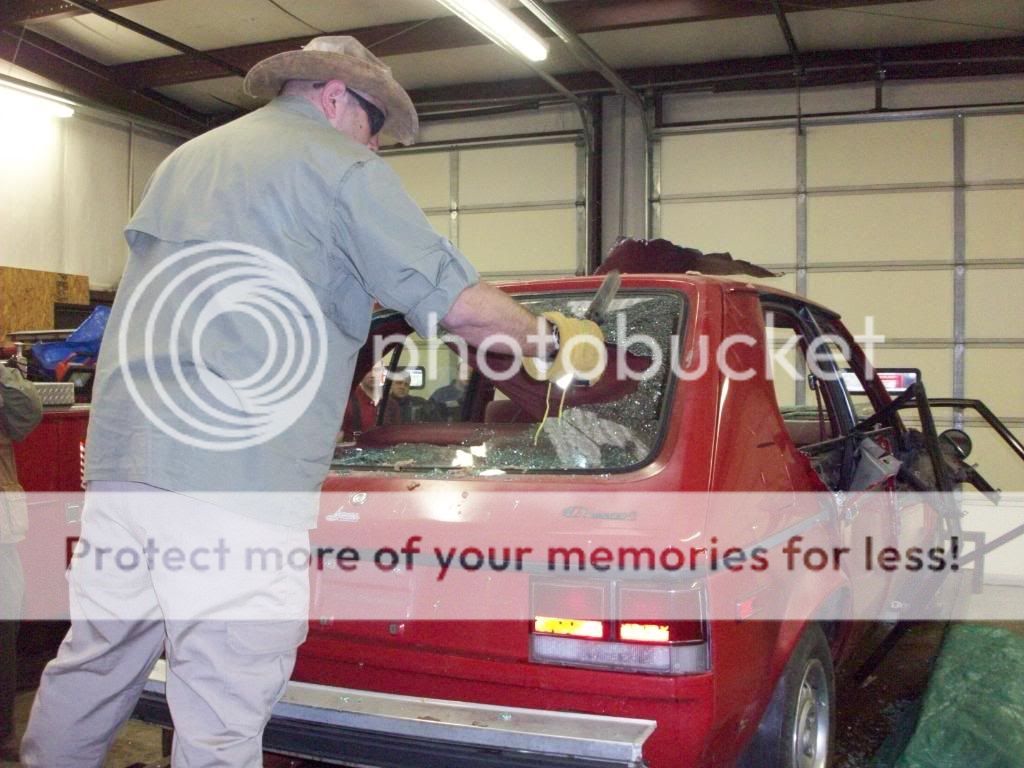

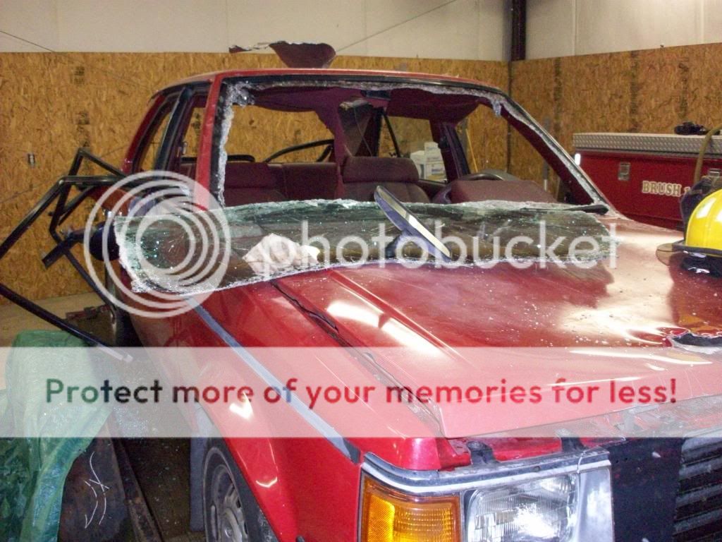

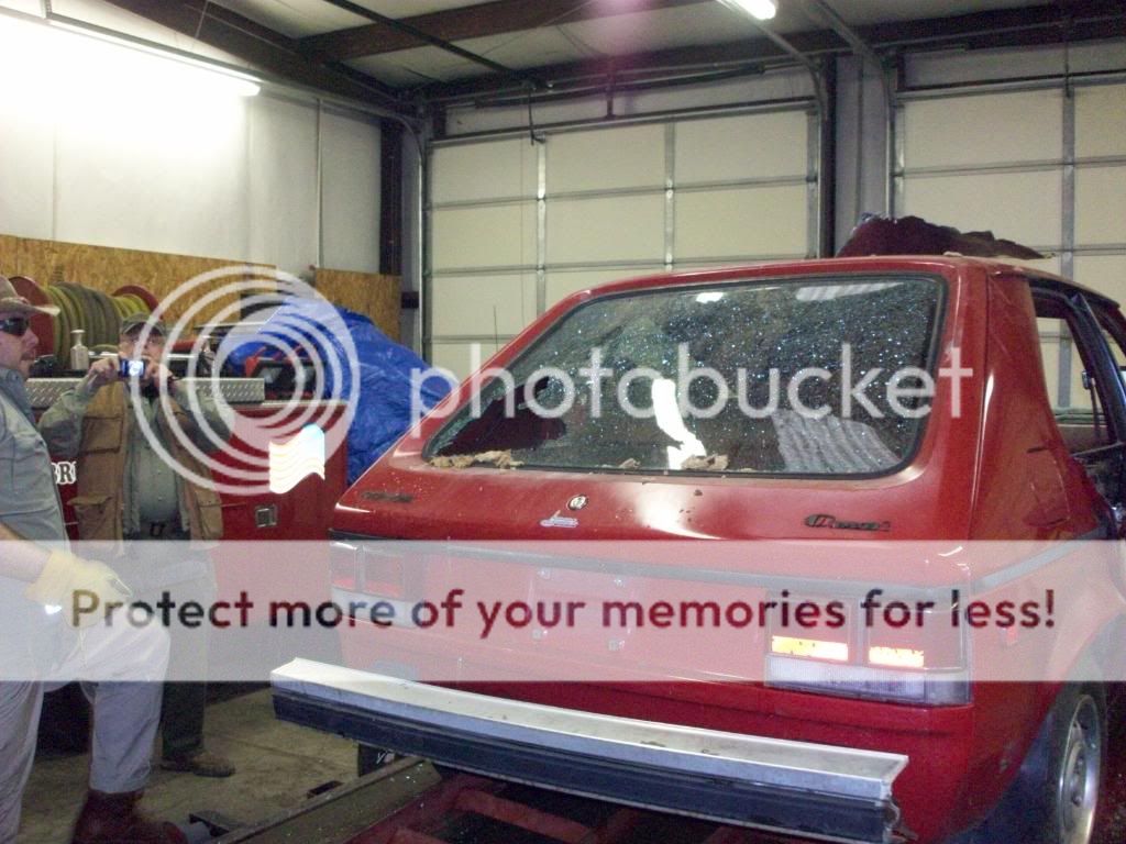

We cut out the windshield with it. Oh, did I mention it had been broken and cut open a roof by now? Still cut out the windshield.
We also cut a hole in the hood, and pulled the latch, but I don't think me or Ethan got pics of that. Don't worry, its in the vid.

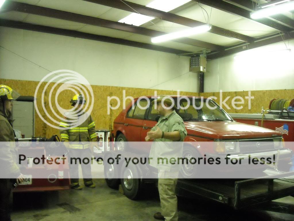

So, I gets to be camera man, and I wanted to be a good boy, and not take the knife away and start beating the Dodge myself. I was trying to be good. Didn't happen, though, but I digress. I give you, Moose, the CameraMan.
Doing a safety brief
Getting in there, for show and tell. I've opened up a few cars like this before, just offering some suggestions.

I'm not surprised it broke how it did.
The stress on that area was incredibly focused in that prying operation, with pretty much nothing to give - the knife can't flex in that direction at all, and the steel thins out as you move from that notch to the edge, exactly where the strain was concentrated. Clearly that's not enough to stop a BK3 completely, though! :-)

Windshields are REALLY tough......
When side windows break it is really cool......
I would never in a million years have figured that any one would use the notch in the way it was used when it went bust or that the failure of the tip of the notch would propagate to the entire nose.....
Technique really matters, when the guys did the sardine tin number on the top the guy who had good technique was getting a couple of inches of open metal per blow....with the remaining five inches......Practice makes a difference....
