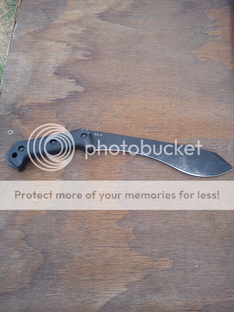

the competitors
first up

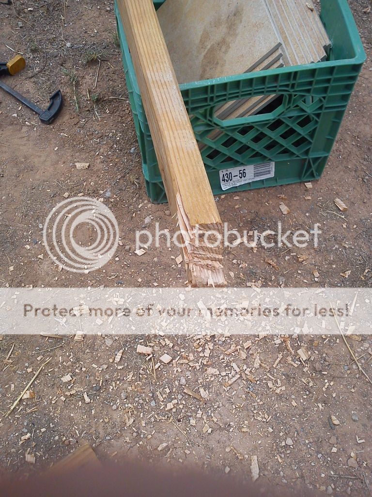

45 chops later

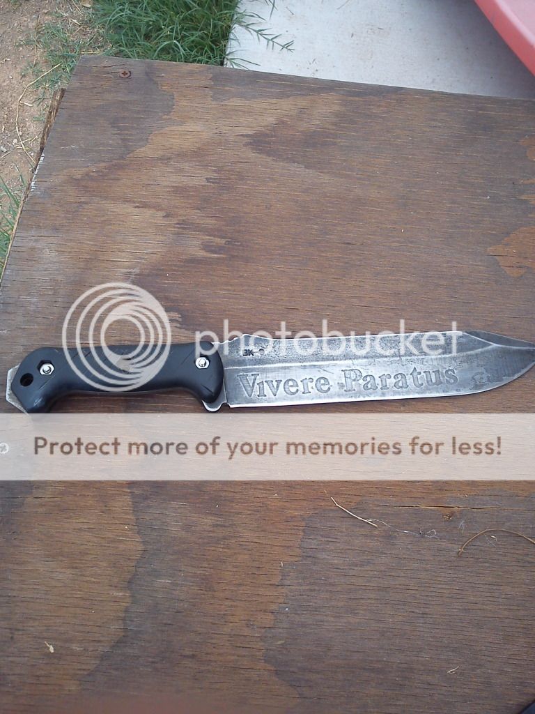

second up
67 chops. the bk4 is deffinately harder to chop with only because of the smaller sweetspot. however the four did make a cleaner cut.

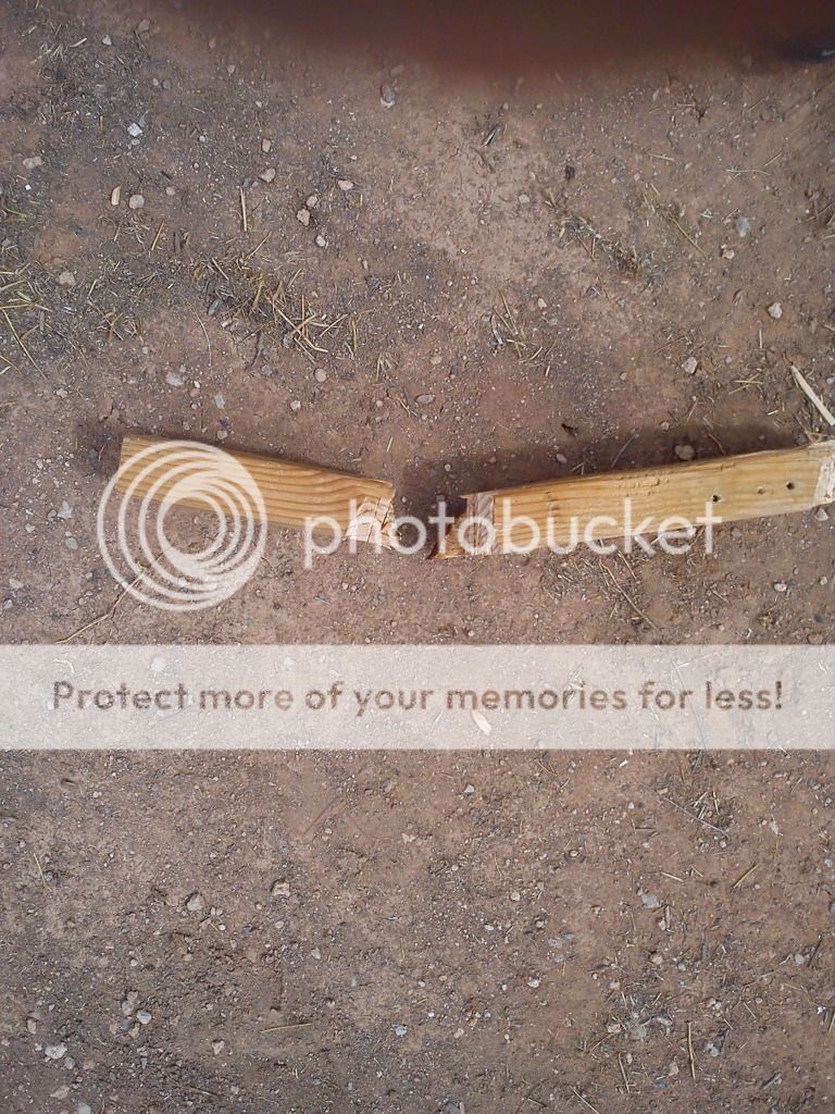

sorry but my sister (camerawoman) ditched me before i could baton. however i did still do it. the four and nine both had EXACTLY the number of baton strikes (2) but the four tended to follow the grain because of the smaller width.
