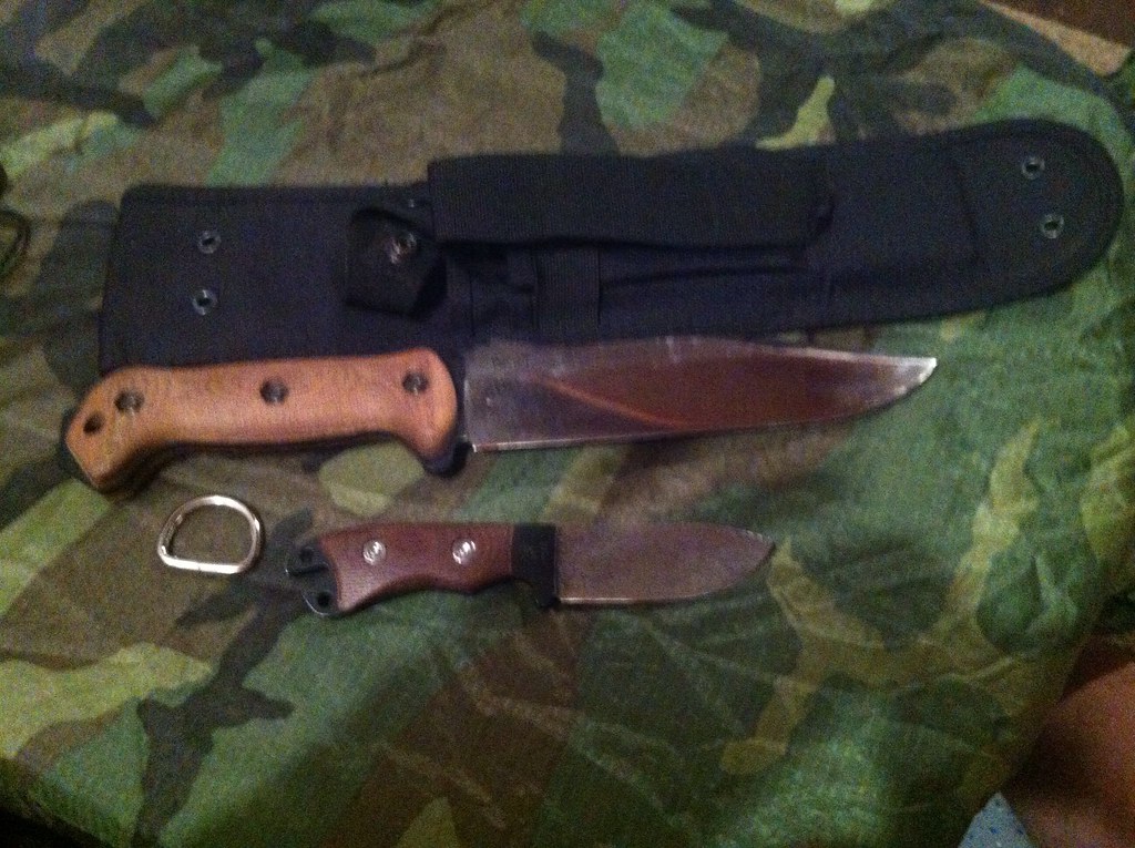

Original,

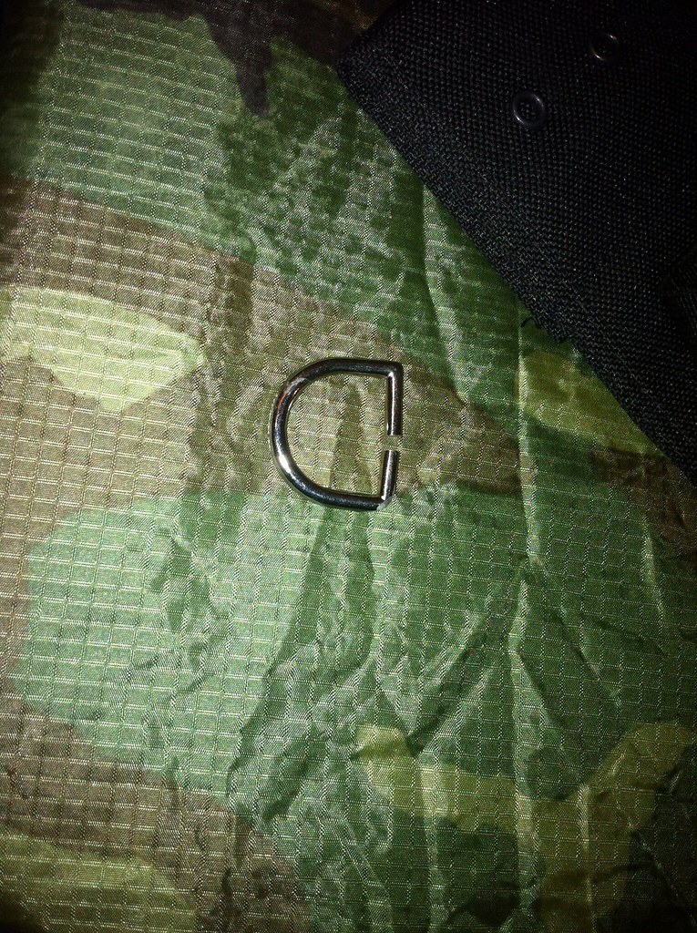

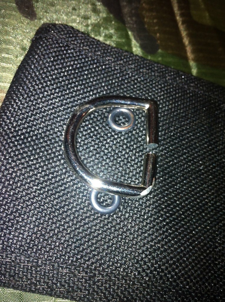

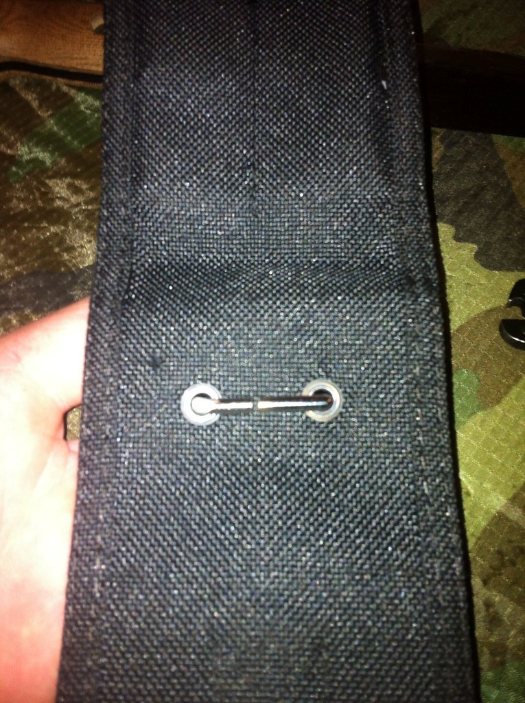

Here I cut a slit into the Dring, and shaved off a bit of one corner so that corner would slide thru both factory installed grommets already in sheath.

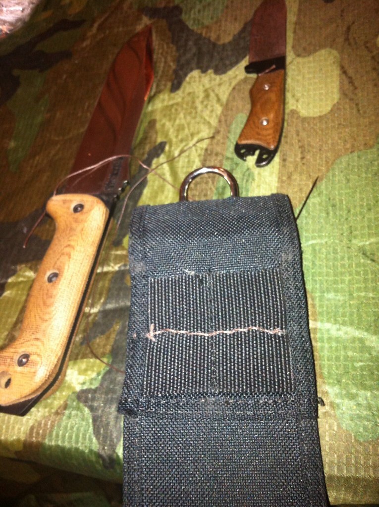

In this photo, I have already ripped the factrory threads out, where the top of the sheath folds over, laid it out flat, and will start the Dring in through the grommets

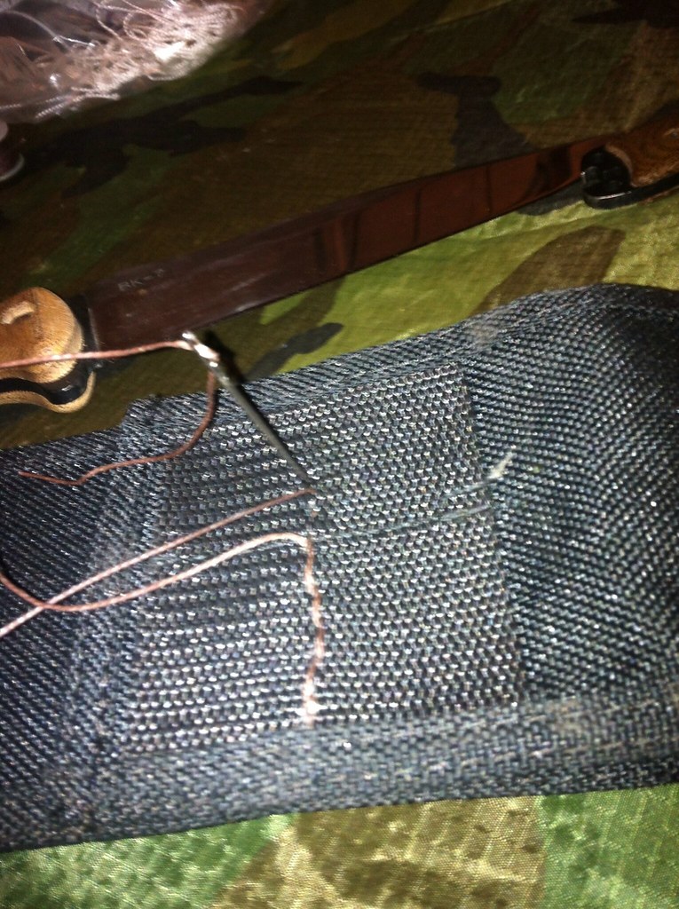

Sewing.
I decided to use brown thread here instead of black, because I didn't have any :). I used heavy waxed leather sewing thread.

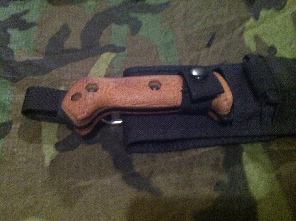

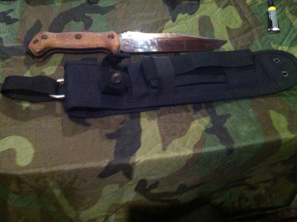

I then sewed a piece of nyon webbing to make the belt loop, Didn't take any pics of that, here it is ready to try out.
This sheath will still work like a regular belt sheath, just depends where you put the belt through. Should make a nice dangler.
