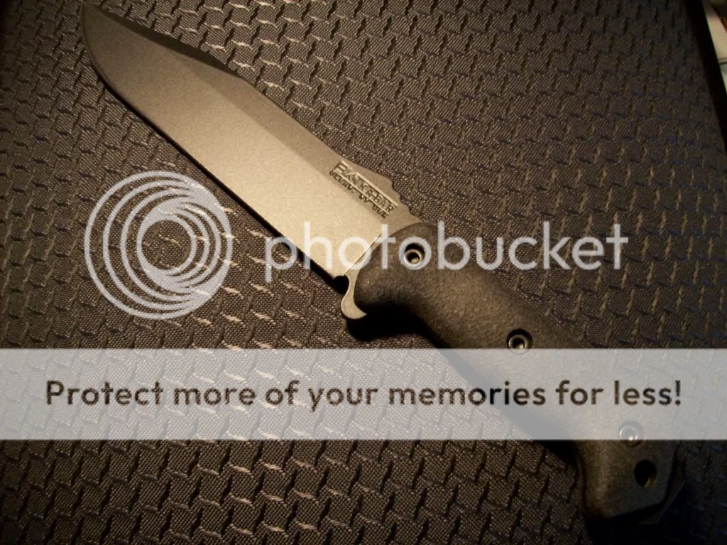

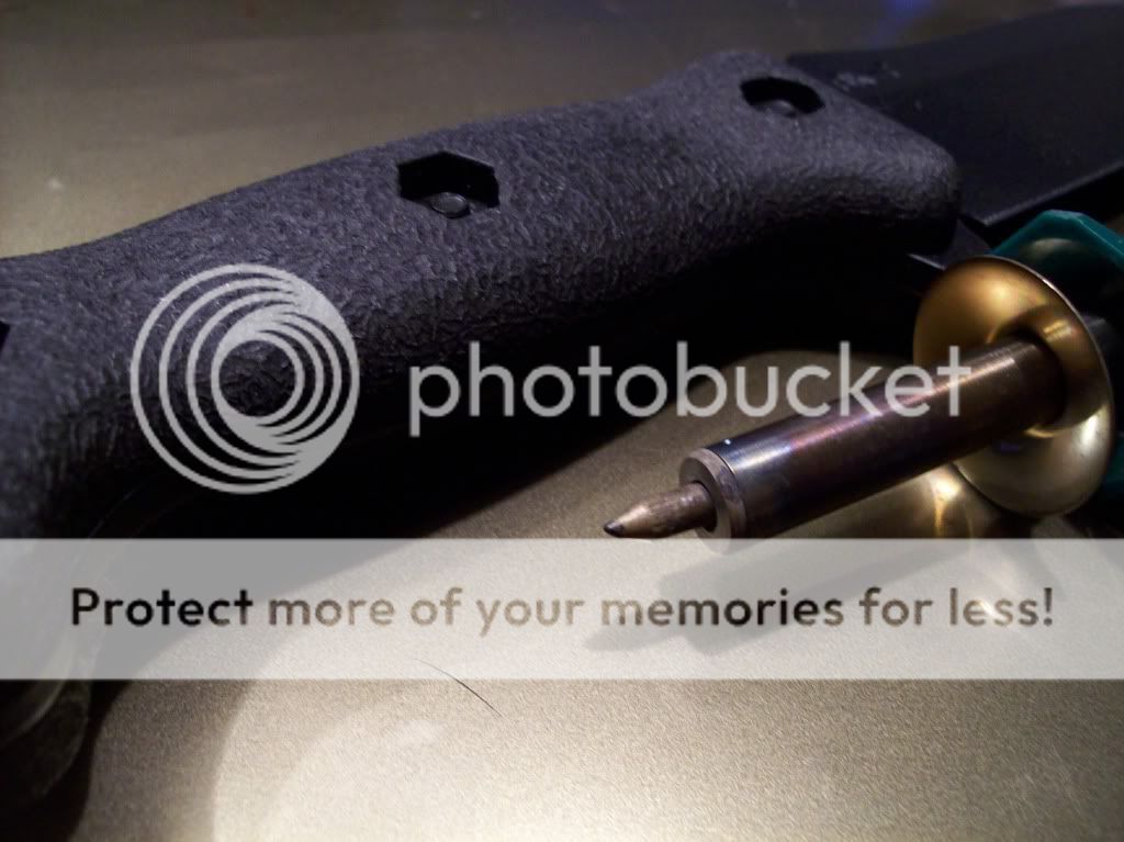

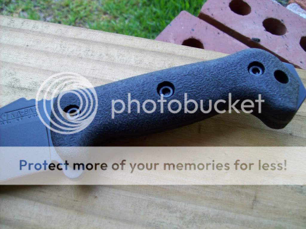

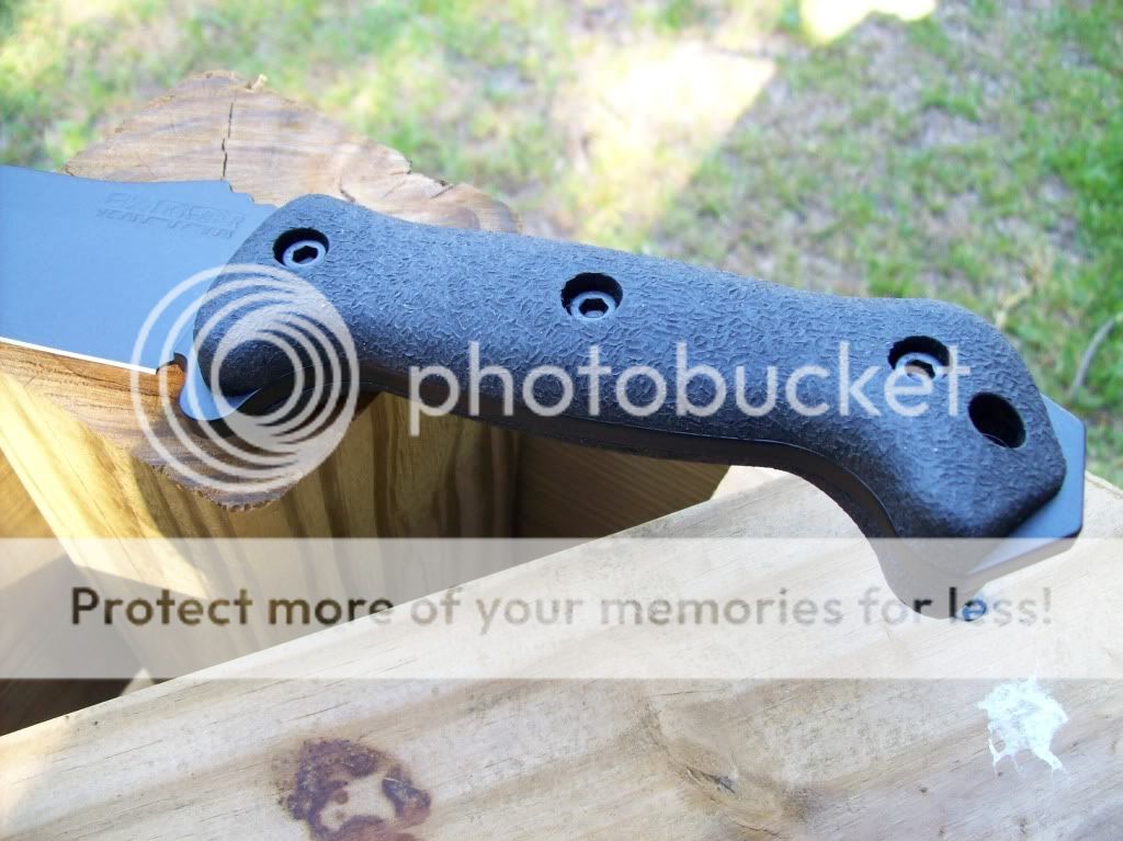

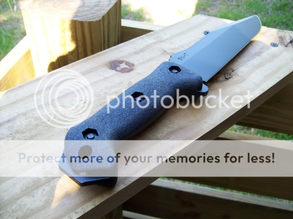

Having stippled the grips of several Glock pistols, I decided to try stippling the grip of my new BK7. I didn't want the stippling to be as aggressive as on my Glocks, I just wanted to be able to hold onto it a little better. I used the fine point of my wood-burning tool and, holding it at a slightly tilted angle, tapped the grip quickly in varying directions till the entire surface was covered. I then sanded it lightly with 600-grit sandpaper. The result is exactly what I wanted feel-wise, and I think it looks pretty good too.

Thanks y'all. I was purposely trying not to make it too coarse, and fortunately the results came out perfect. I can slide it in my hand without abrasion but it still gives a good, solid gripping surface.

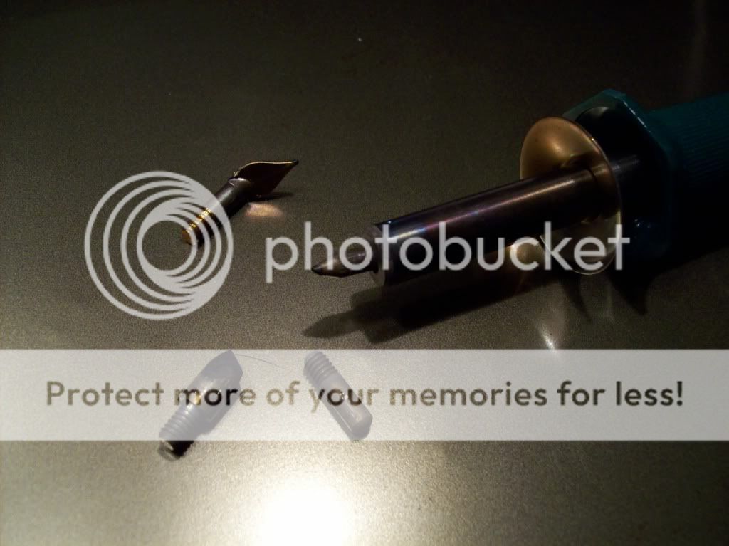

Could you show us the tip you use for heating?
Thanks!
Glad to. It's the smallest, pointiest in the set, but like I said I held it almost sideways (maybe about a 30 degree angle) when tapping the handle with it. I used the same tip on the Glock but used a different technique and went a little deeper.
