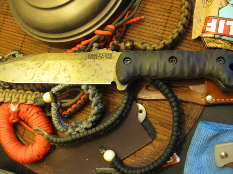

This was the BK7 i posted with the huge chip in it a wile back. As you can see it looks pretty damn good after i fixed it up.

Are those micarta handles on it? I ask because I have a pair of micarta slabs, but I have also sanded down my factory Grivory scales and they have a similar texture to your scales. I love the dull gray look.

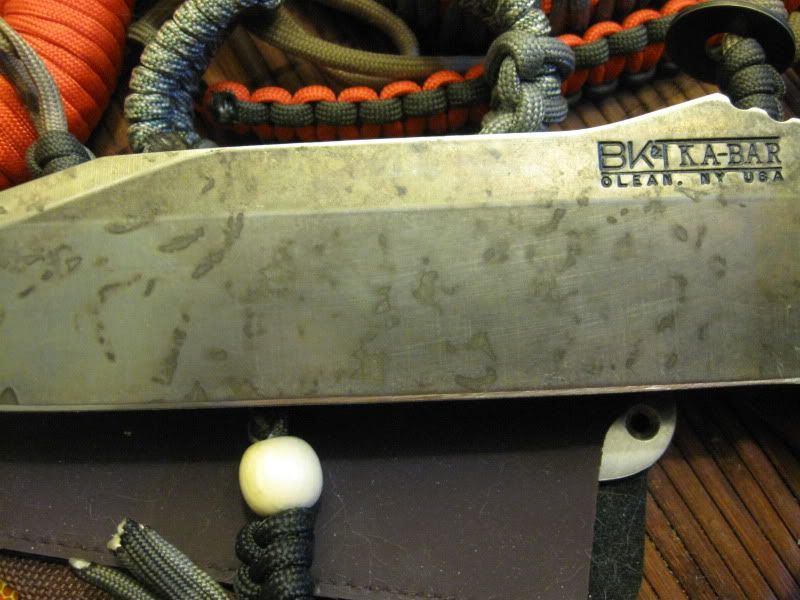

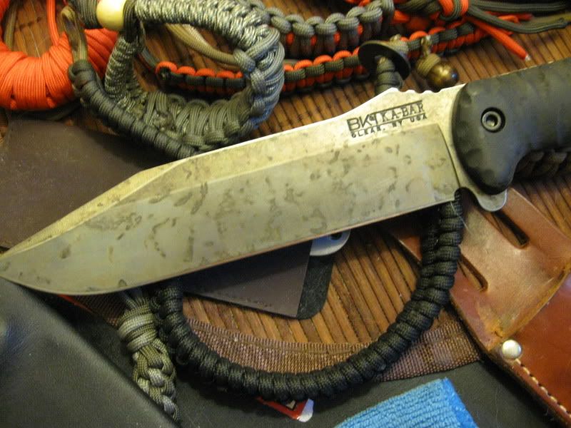

can you explain the process you used to get that patina look, I know 'what' you used, but how??
Thanks,
paint brush and some spicy brown mustard, make your own pattern by heavier mustard on certain parts. Keep it on for about an hour, the longer the darker.
spayed some vinager on it also.
