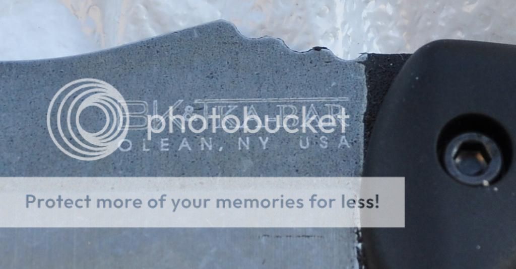

I stripped my BK9 this morning and with no etching, this is what the logo looks like:
Before-
After-
Before-
After-
thats surprising..i thought without etching the logo would completely disappear. isnt the logo just gaps in the coating and not laser etched on beckers now?
This is the newest version and the logo is smooth to the touch, but etched into the metal. It actually looks much cleaner in real life than in the pic. That is a a much magnified version. It could probably be sanded off, but mine looks great after the stripping alone. It also has the BK9 logo on the other side.
I did not etch my 7 before stripping. This was the new version, picked up just a couple months ago:
The laser etching is on the surface and probably just a little deeper. If you were to go to town sanding that thang... well the logo will pull a disappearing act on you. Mainly etching the logo gives it more depth after the strip... I am going out on a limb to say this is because people really liked the recessed logos on the stamped models, or they just wanted to etch it to make it more apparent.
