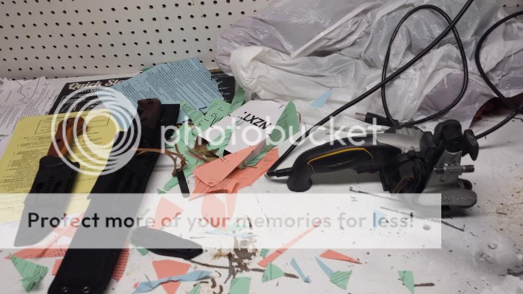

This is all using a WorkSharp KO with 120# , 180#, 320# , 800# , 2000# , 6000# grit belts at a 20 degree angle.
Well here we go!
Here's my bench and belt holders!
Time for the fun, here's my BK2 before sharpening.
