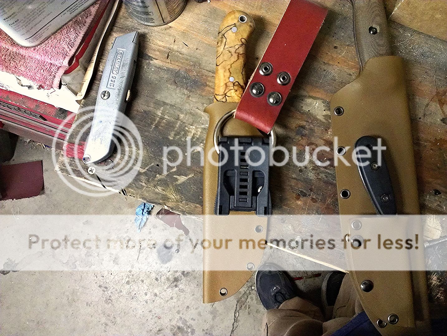

This is how I do all my sheaths. Tek Lok with a large metal ring that fits in the teklok with the dangler attached to the ring. That way I can easily switch the teklok to my belt if I want.

That is a really freakin' good idea. I may poach, someday.
edit: that seems like it would also work really well with the right size D-ring.
I make leather danglers using steel gate rings of different sizes like tobiism posted, and depending on the gate ring size, you can easily and quickly make any sheath with a belt loop into a dangler. I use them on everything now....they are really slick and cool looking as well.
