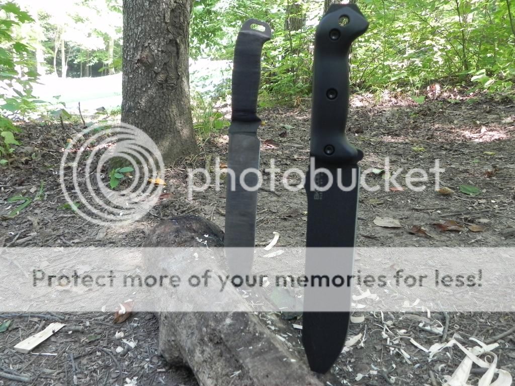

The Contestants:

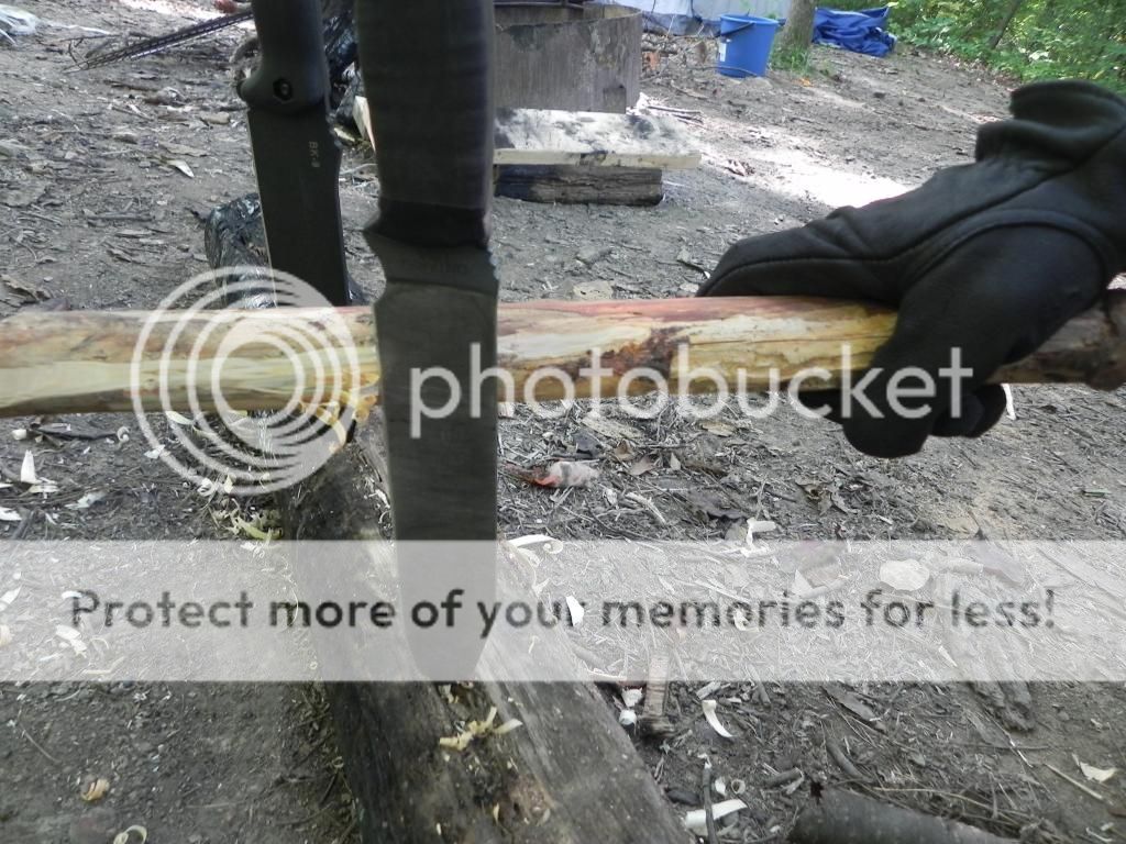

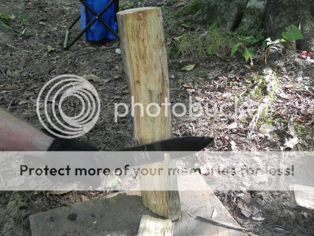

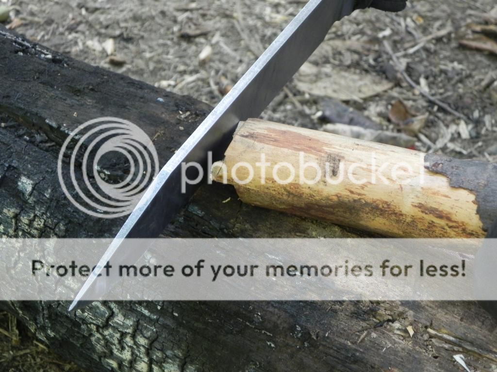

Test 1: Feathersticks
Ok, I suck at making feathersticks. The choil on the RBS9 and the more narrow/lighter blade make it easier to perform fine cutting tasks. The BK9 is heavier, more weight forward, and has a larger blade with an uncomfortable finger ramp that makes it slightly less maneuverable than the Ontario. However, when making feather sticks with the knives hammered into a log, it was a draw. EDGE: RBS9

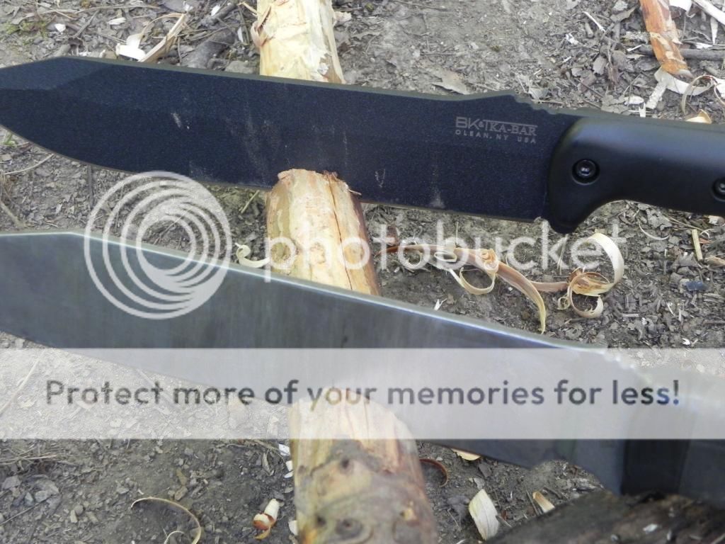

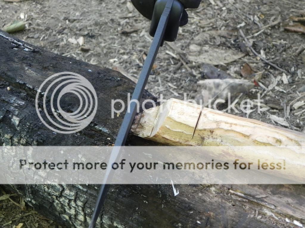

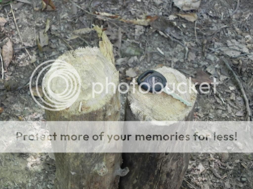

Test 2: Chopping
I'm not sure what type of wood I was using, but it was very hard. I noted how deep each knife sunk on the first hit, and then how many strikes it took to make it through.

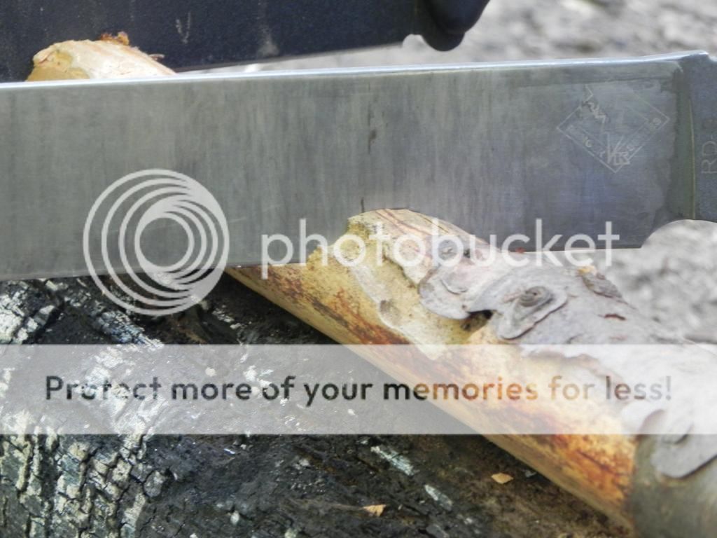

RBS 1st Strike:

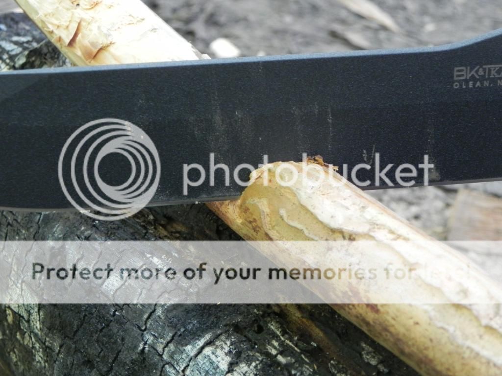

BK9 1st Strike:
Pretty close, but if anything the RBS bit deeper
RBS- 12 strikes to get through (that's right, 12....it was HARD)
BK9- 4 strikes to get through. The BK9 DESTROYS the RBS9 in chopping. I expected this though because you can feel how much more weight forward the BK9 is.

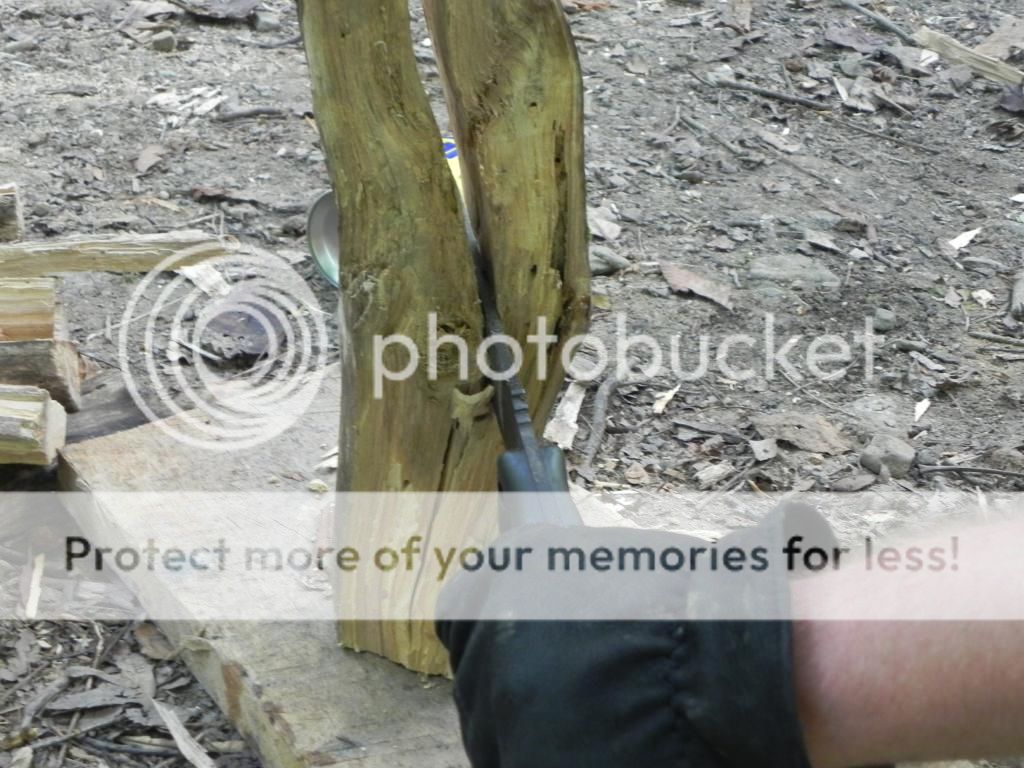

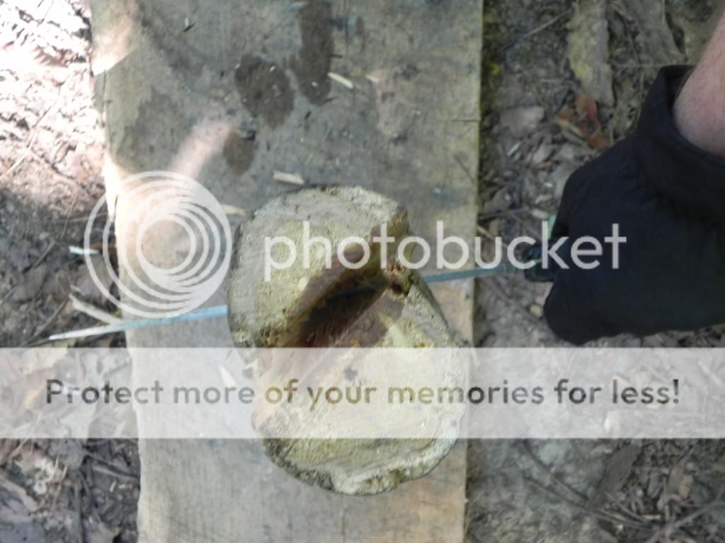

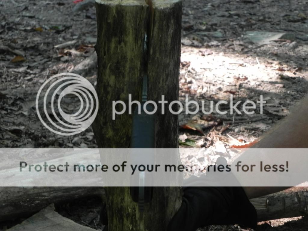

Test 3: Batoning
I had some pretty knotty wood from a tree that I processed with my Bahco Laplander. I was expecting the RBS9 to baton slighty better because the flat grind is more wedge-like.
The logs were a few inches in diameter, but pretty knotty
The RBS9 got pretty hung up on a decent sized knot and took a considerable amount of whacking before it made it through, my hand was throbbing

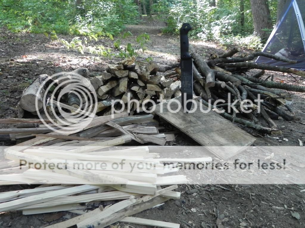

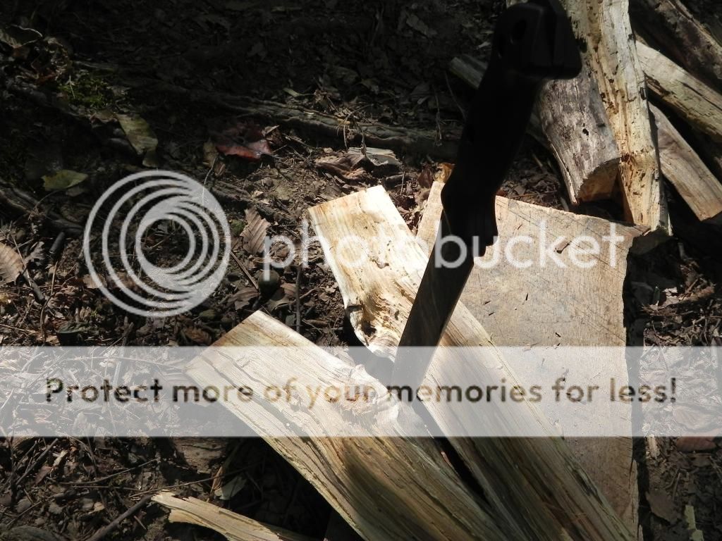

The BK9 on the other hand literally EXPLODED through the logs! It was so easy that my wife even batoned a few logs. This was really no contest, the BK9 batons better than any knife I have ever used including the BK2.
It was so easy with the BK9 that I quickly processed the entire weekends worth of wood!
This contest was hands down won by the BK9. Is was vastly superior in nearly every way. It was so evident that even my wife made a comment on how big a piece of crap the RBS9 was. Not that its really a POS, but the BK9 is....well, the KING!
