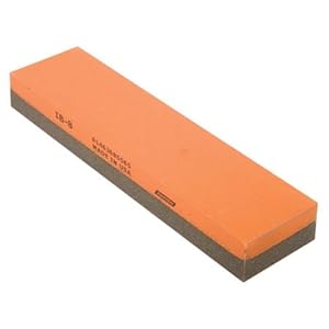

If you don't want to convex it norton india bench stones are awesome too!

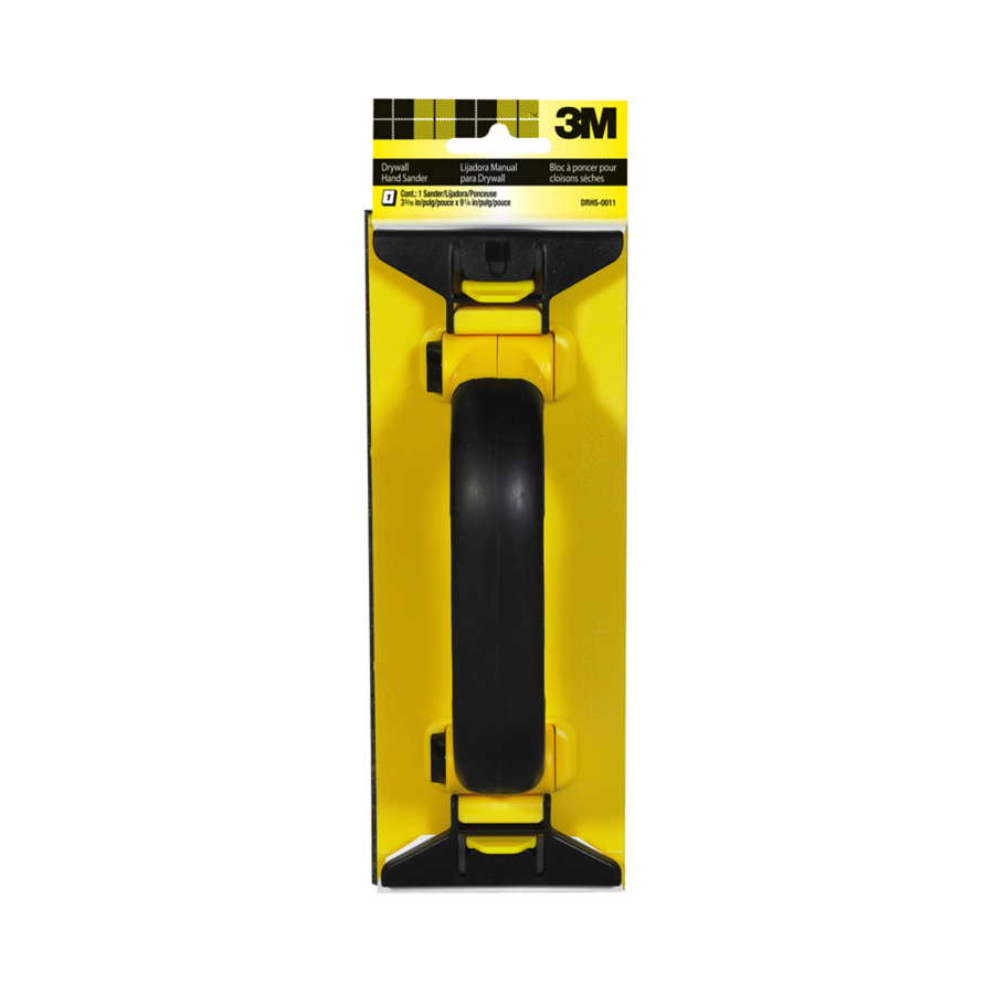

Tradewater had a suggestion for something to use that would work a lot better than a mousepad. He uses one of those drywall hand sanders, which has a rubber pad for give, a means to lock in the sandpaper, and a really comfortable handle to use.
One of these:
