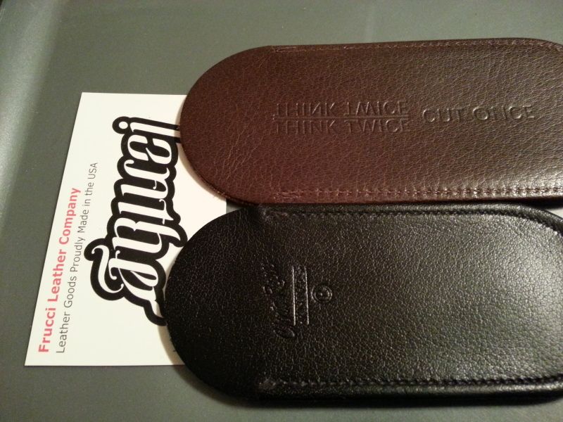

I got us covered, I own a small leather business. I have multiple sealers and dyes. We good! ;) I've already dyed my micarta Insingo, I don't see how this could be more difficult. lol
So, do you prefer the lacquer sealers or the water-based acrylics? I've used both and would be interested in your opinion. :)
It depends on what I'm using it for. I use Acrylic Resolene for most things that require almost a waterproofing. For me that would be belts. I use sealers like Atom Wax and Eco Flo Pro Finish for all my veg tanned. There i do have a pref for Glossy over the Matte. And thats only because Matt Finish Eco Flo smells like an enviormental hazard and takes days to get back the original leather smell.
I may not be the best guy to ask though because of the leather I use. The belt leather I use is a English Bridle style so it's tanned the color versus dyed that way. The colors don't run but the sealer gives a nice look. The veg tanned I use I bombard with sealers. So typically I'll use a Chamberlains 1 and 3 to condition and water protect and then I'll do two coats of Atom Wax and then top it all off with Eco Flo.
Edges I seal witih either edge paint or I burnish them with gum taraganth.
