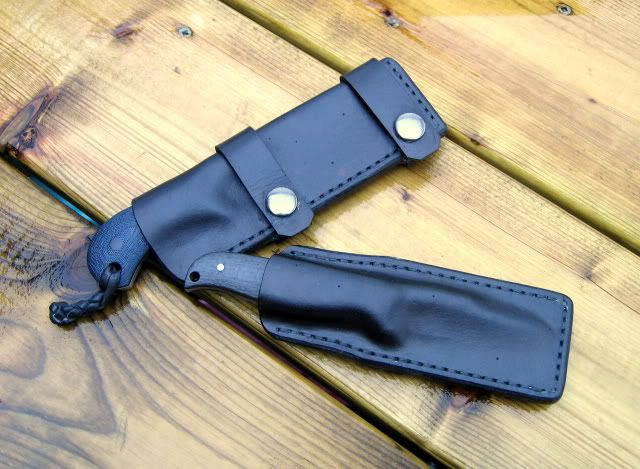

I used vinegaroon on this sheath. The solution can be brushed on the outside after the sheath is glued up, rub on some water/baking soda paste to neutralize, rub it off with a cloth after it dries, then waterproof with beeswax and neatsfoot oil. Simple and effective. Using the vinegaroon creates the most beautiful charcoal black color with no streaks and is permanent, no bleed out whatsoever because it is a chemical reaction, not a dye. After trying this method and using it, there is no way I would ever go back to using conventional messy chemical dyes and finishes.
